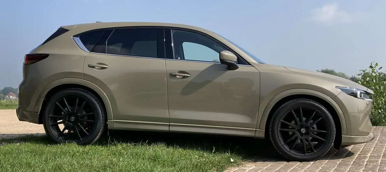

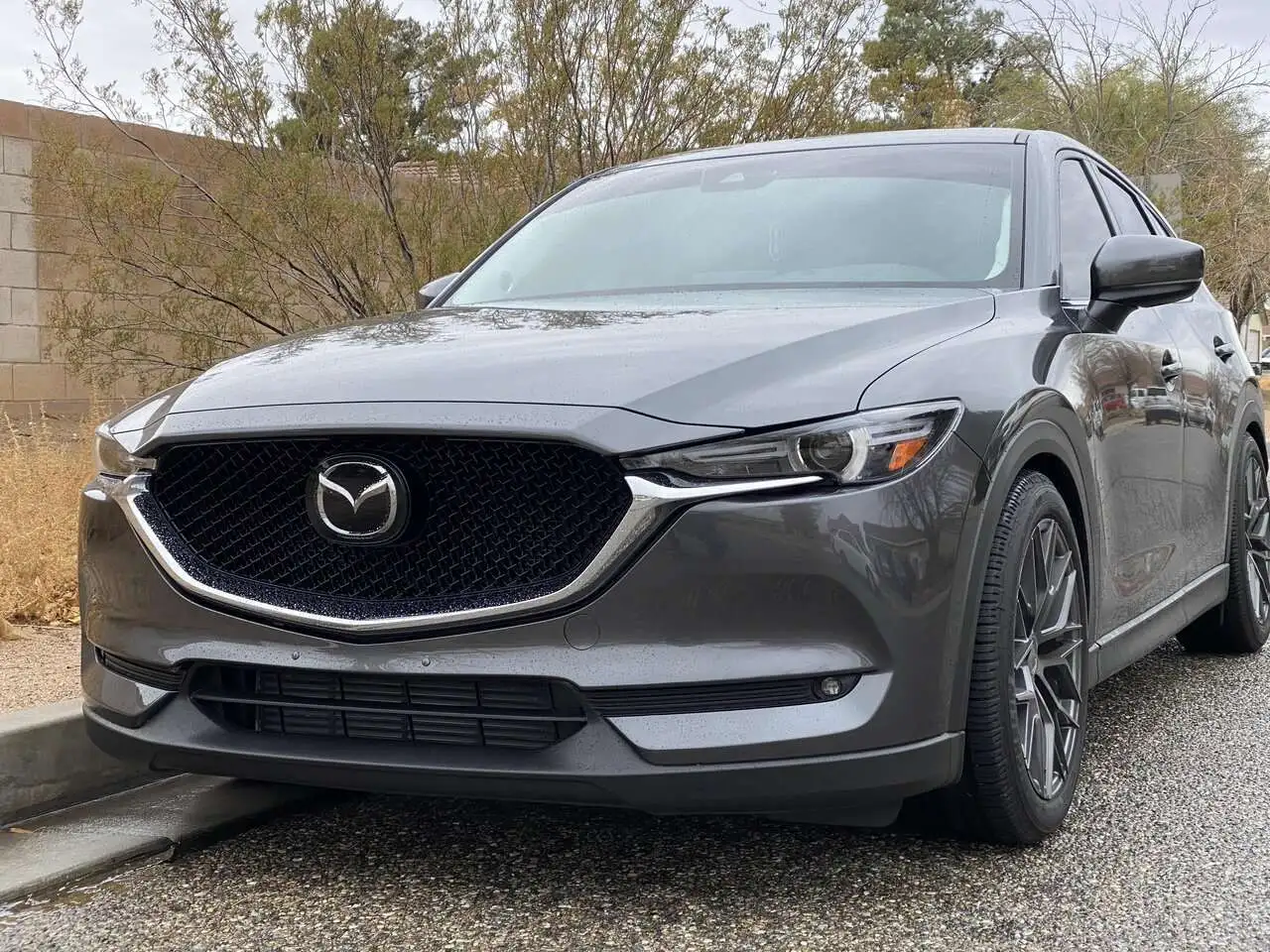

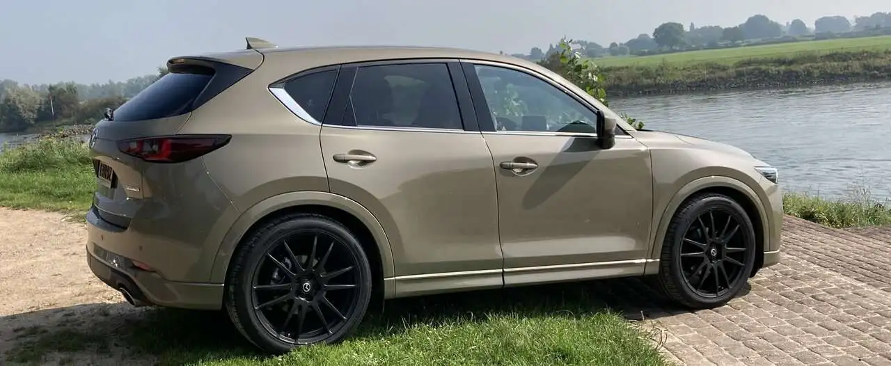

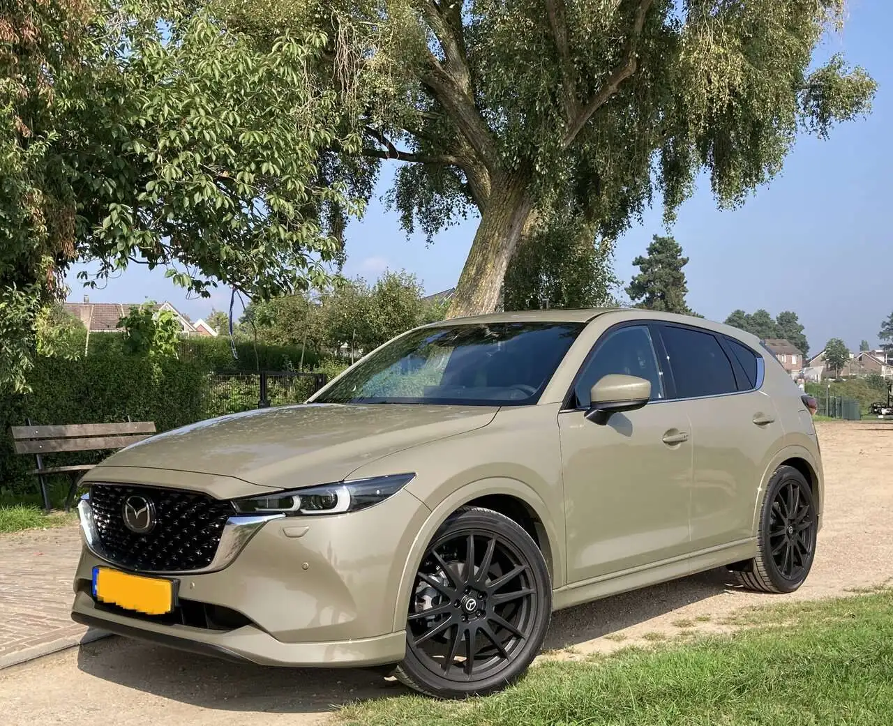

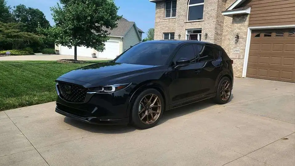

Enkie TSR-X 20x9.5 40
Nitto INVO 275/40r20

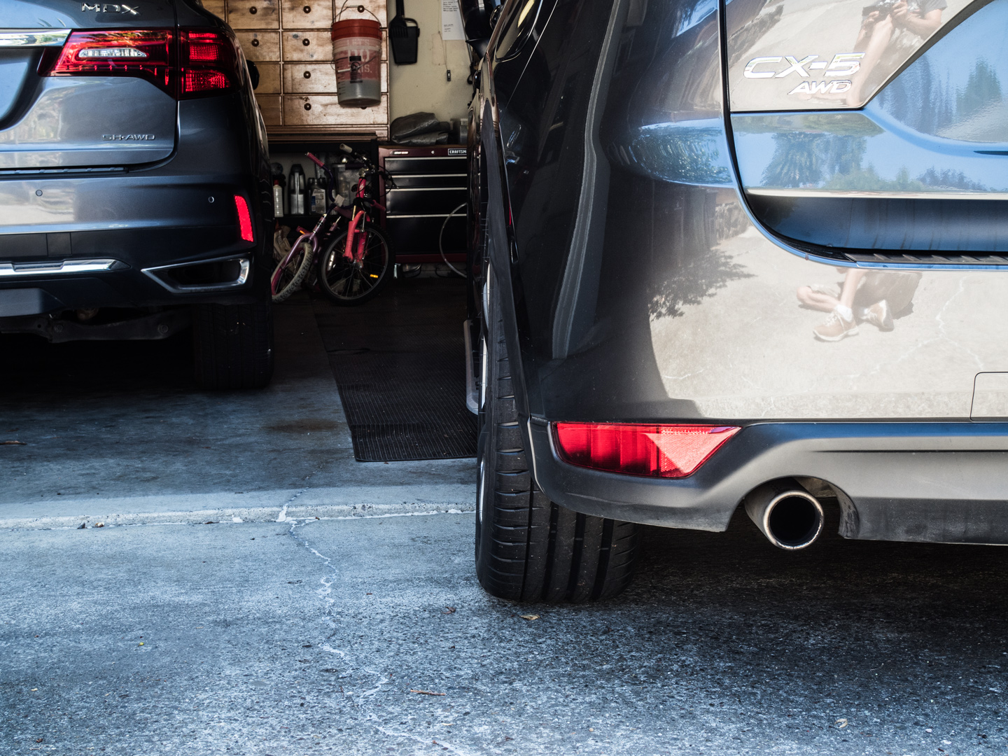

No spacers, no rub. Corksport lowering Springs on 22 Turbo

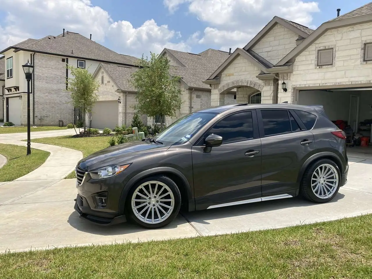

Hi Oleman, glad to reply...
What will be a satisfied answer for your question?
Because I just want it, because it fits.
Yes it looks better, yes it handles a little bit better with the combination of the H&R set. I thought It might have been hard, but no it's perfect.
The CX-5 I had in 2019 had 20inch with Eibach and Bilstein, that was a bit harder. This is the link: Lowered CX-5 Appreciation: Show me your drop!
My 2021 Mazda6 was lowered and had 20inch, this is the link: Mazda6 Photos - Share your pics!
I had a option to go for 245/40r21 with no difference. But I choose the 255. And this is the result, original vs new:
And then another serious reason:
I have the same on our Mazda2. In 17inch and this wheel is in 21inch available for the CX-5
Yes I love the way both cars look and match, sorry.....

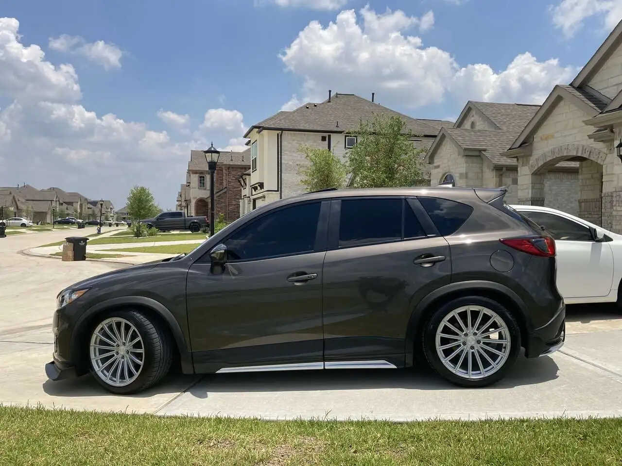

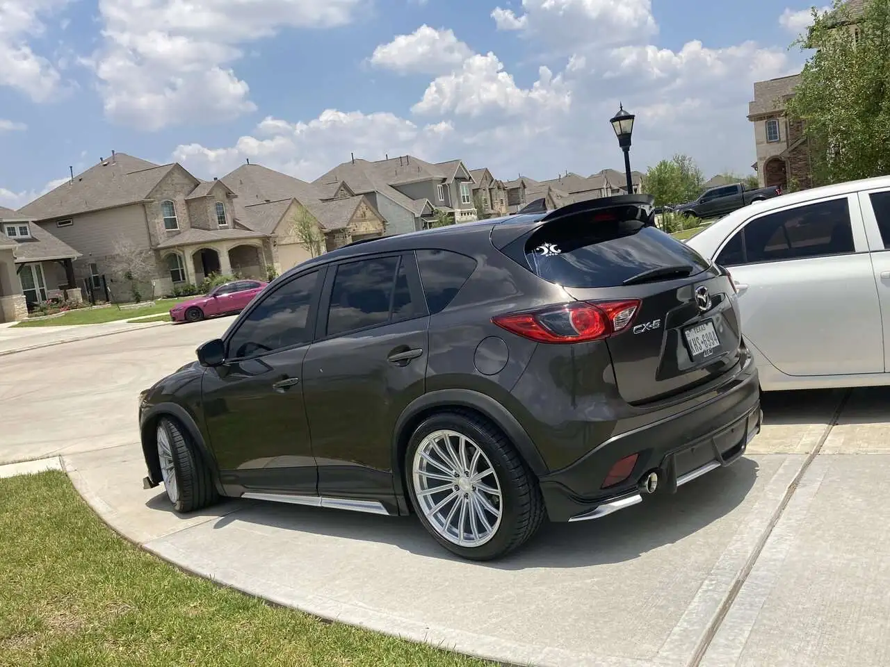

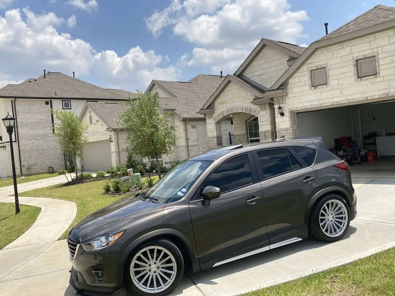

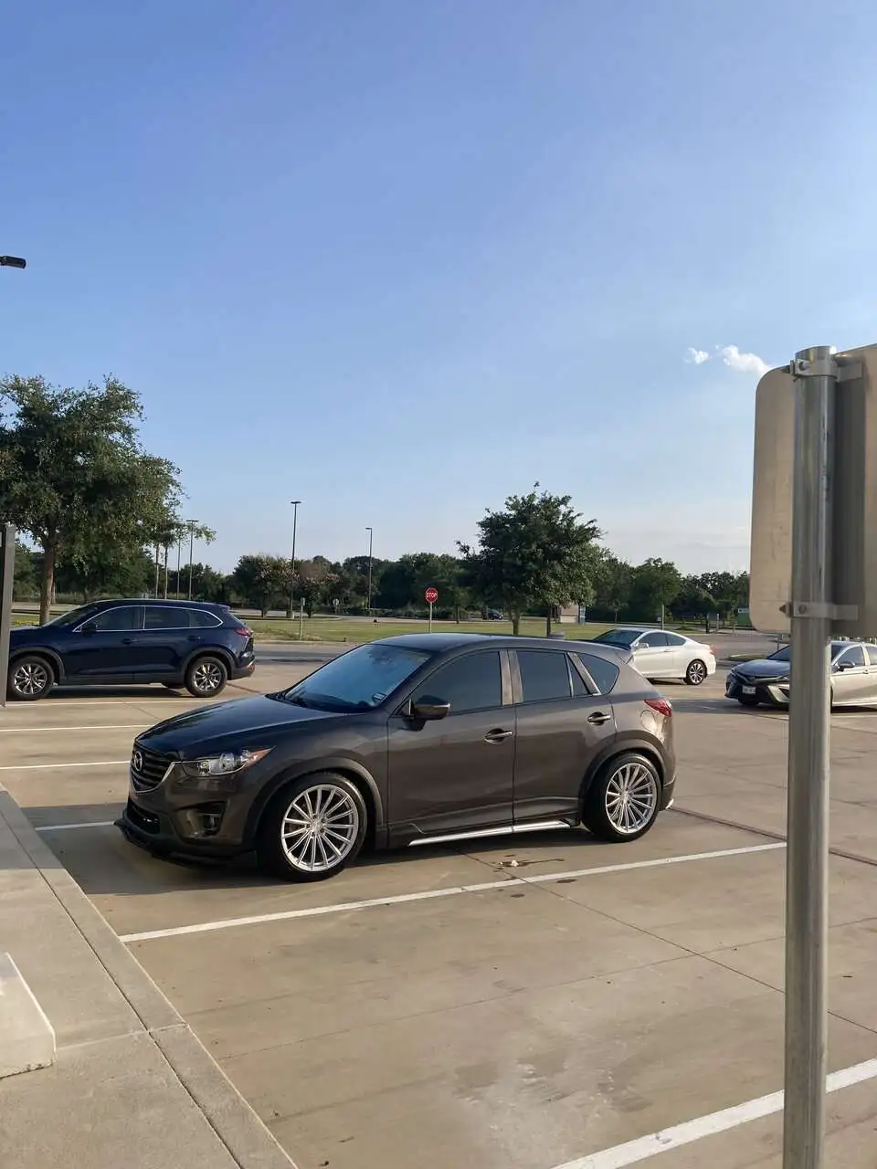

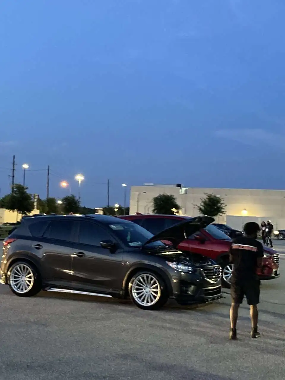

Same wheels just updated photos with kenstyle bodykit from thailand, duckbill spoiler from Taiwan, fender flares from Russia etc updated suspension from Megan racing springs to BC coilovers, Megan racing front/rear sway bars, megan racing H-brace, Megan racing rear upper control arms and toe arms. more bars will be added later like a trunk bar and rear lower bar etc.

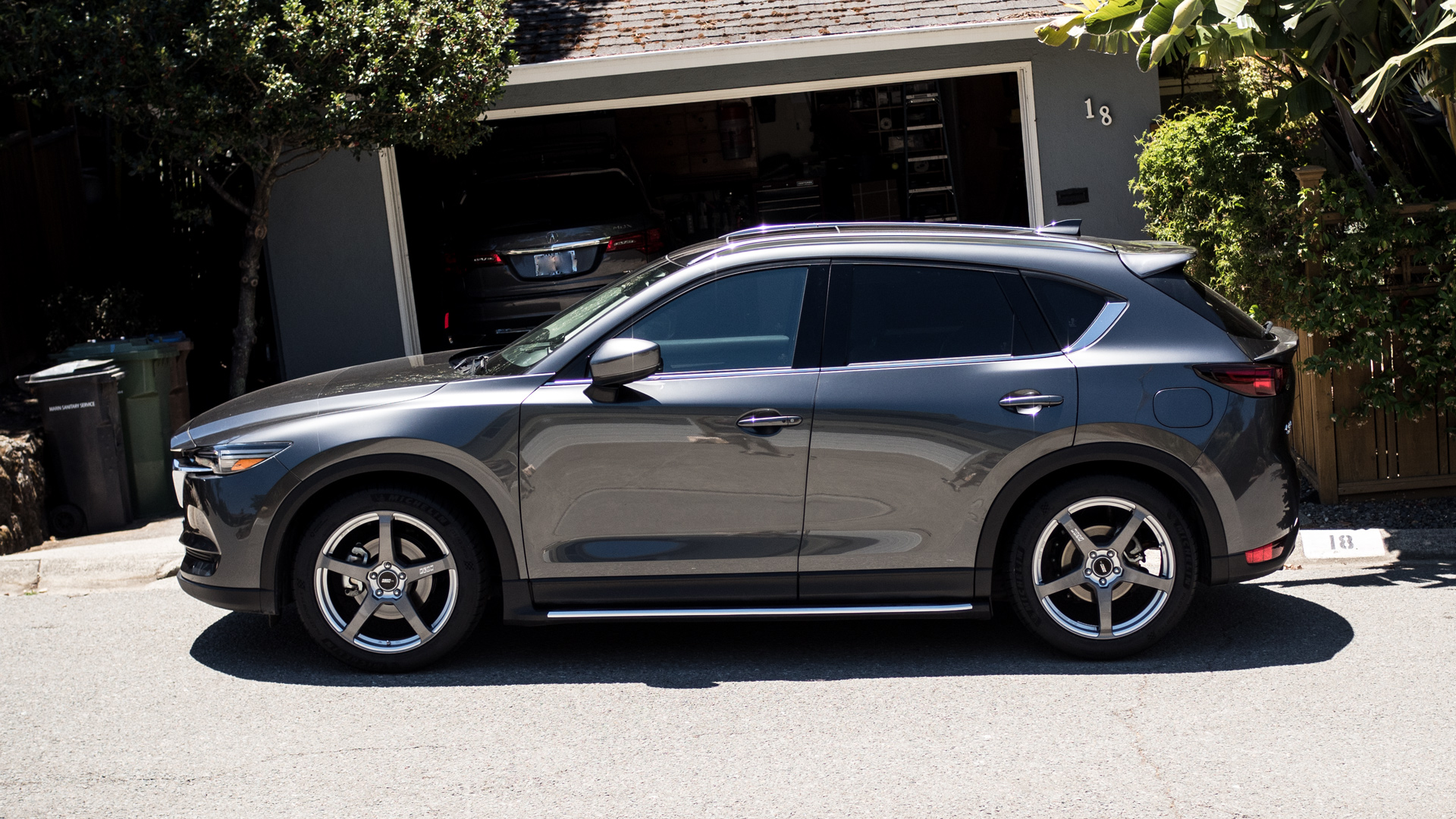

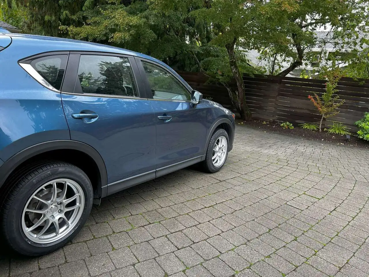

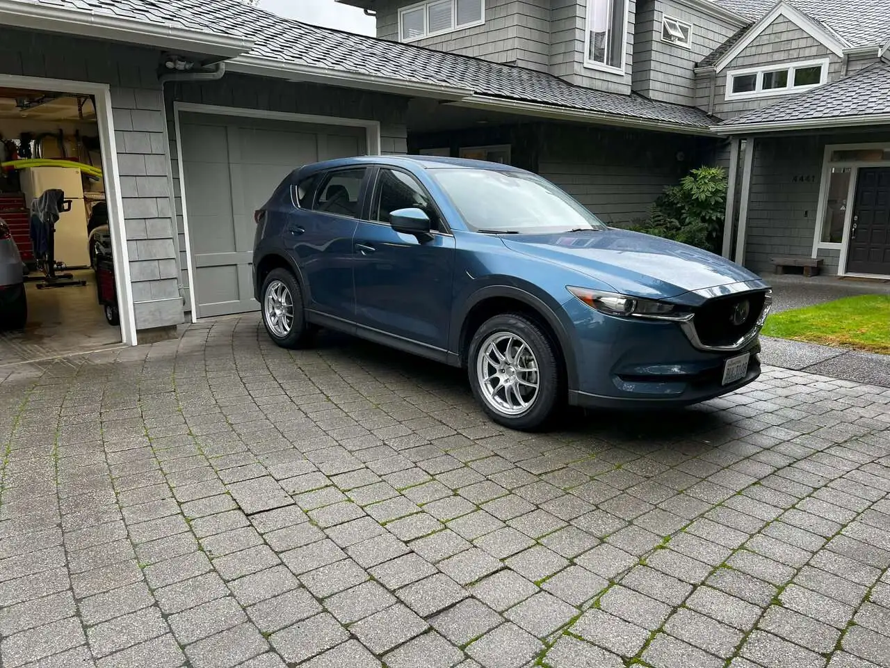

After much deliberation, ended up with a set of Enkei Racing PF01 in 18x8 ET40 with 225 Pirelli Scorpion A/S. 46.4lbs per corner down from 49lbs per corner with OE 17s. Fills out the wheel wells nicely. I stayed with 18s for some sidewall/comfort.
Ok, installed:

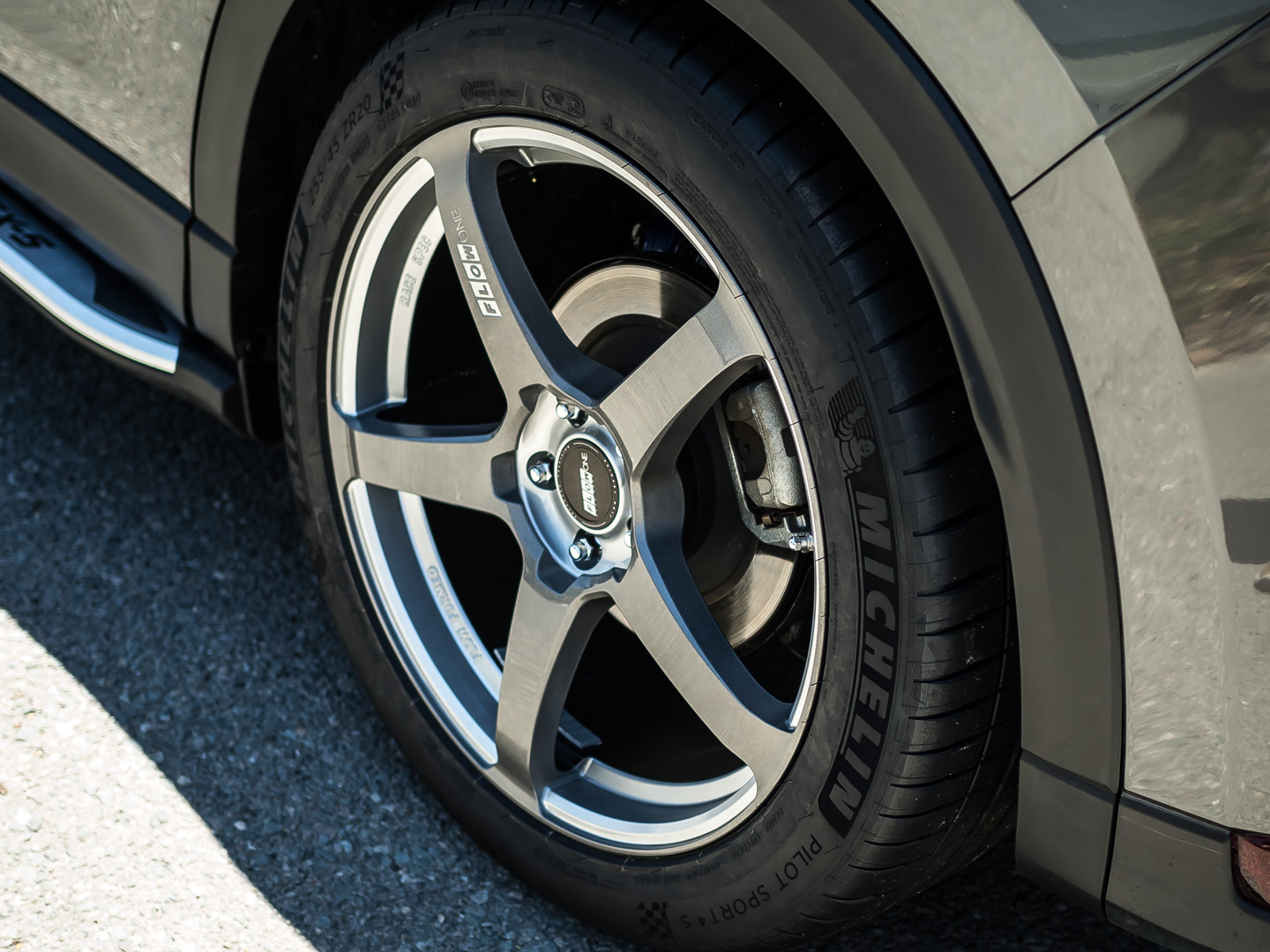

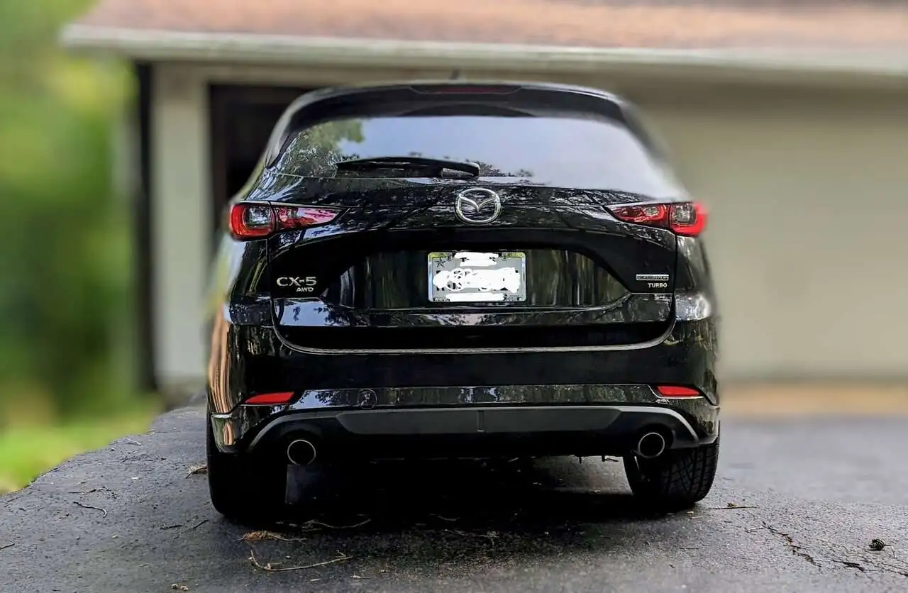

20x8.5et45 FLOW ONE Race Spec F5 wheels + Michelin 255/45R20 pilot sport 4S, Eibach springs
Why these wheels?
I like Japanese motorsport style, 5/6/7-spoke, 2/3-piece designs. But I wanted to go bigger than 19in, and get something lightweight. To do all that was going to be $3-5k. I went for these because they're light (22.4lb each), an easy to clean 5-spoke design, and at $225 each they left room in my budget for nice tires and some brake upgrades (yet to bet installed).
Custom Paint
In a 5x114.3 pattern, these are only available in gloss black, which isn't the look I was after. I decided to try to paint them 2-tone myself. The paint is duplicolor silver and graphite wheel paints, then spraymax 2k clear.
Fit Lessons learned
  • 20 is not much bigger than 19. I was thinking the spokes extending all the way to the rim would make them look really large, but they don't look much bigger than the stock 19s.
  • The additional 1.5in width over stock isn't much. I wish they were a little more aggressive. If they're still available in a few years when my powertrain warranty expires, I might get 10in wide wheels for the rears. In the meantime I'm looking into spacers.
  • These wheels are gonna get rashed mid-spoke. I was hoping the spokes didn't arc much further outboard of the rim, and having wide 255 tires would protect them, but no. Eventually these will get curb rash in a very obvious way.

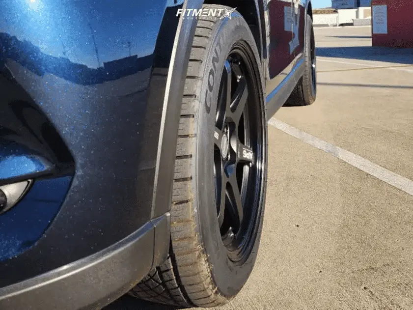

Another 19x8.5 30 from Fitment industries site:
ESR Ap6 19x8.5 +30 245/50 19
Seems pretty square at stock height.
Sorry man--I appreciate the pictures, but those setups (especially the last one) look like they poke out a bit up front. It seems like the line is drawn at 8.5" +40 or 9" +45 up front.

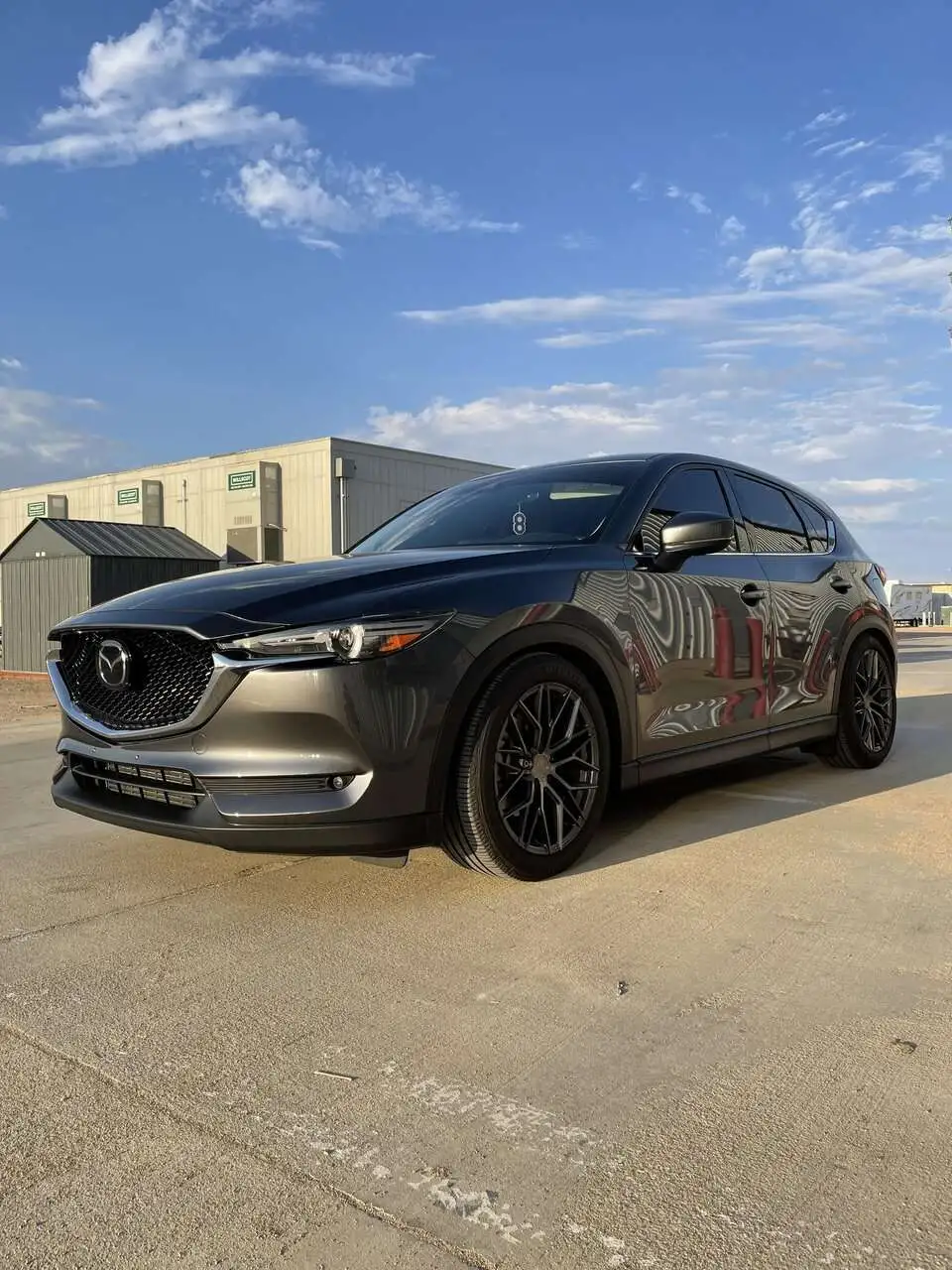

A 2022 Turbo in Black Mica with Flow One Race Spec F2 wheels (20x8.5 +45mm offset) and Continental DSW06+ tires (245/45ZR20).
SUV has been lowered 1.75" front and back.
Bottom pic shows the new slotted rotors with the wheels/tires.
