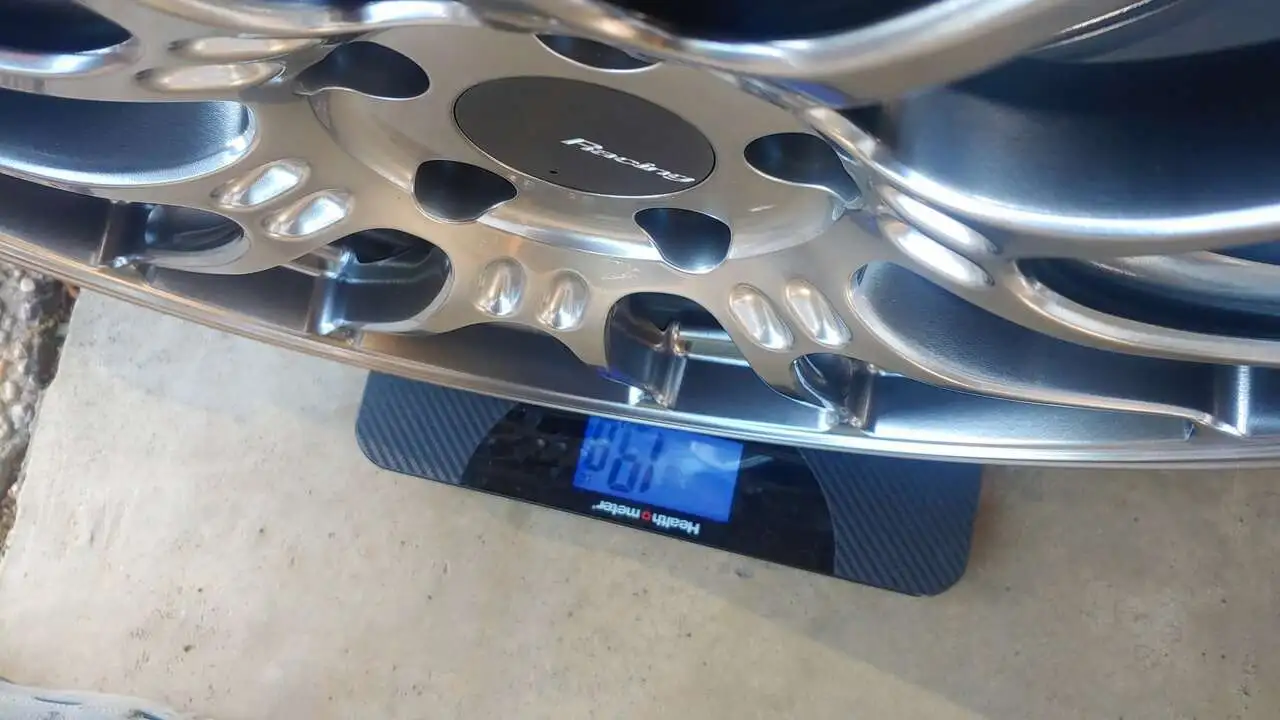

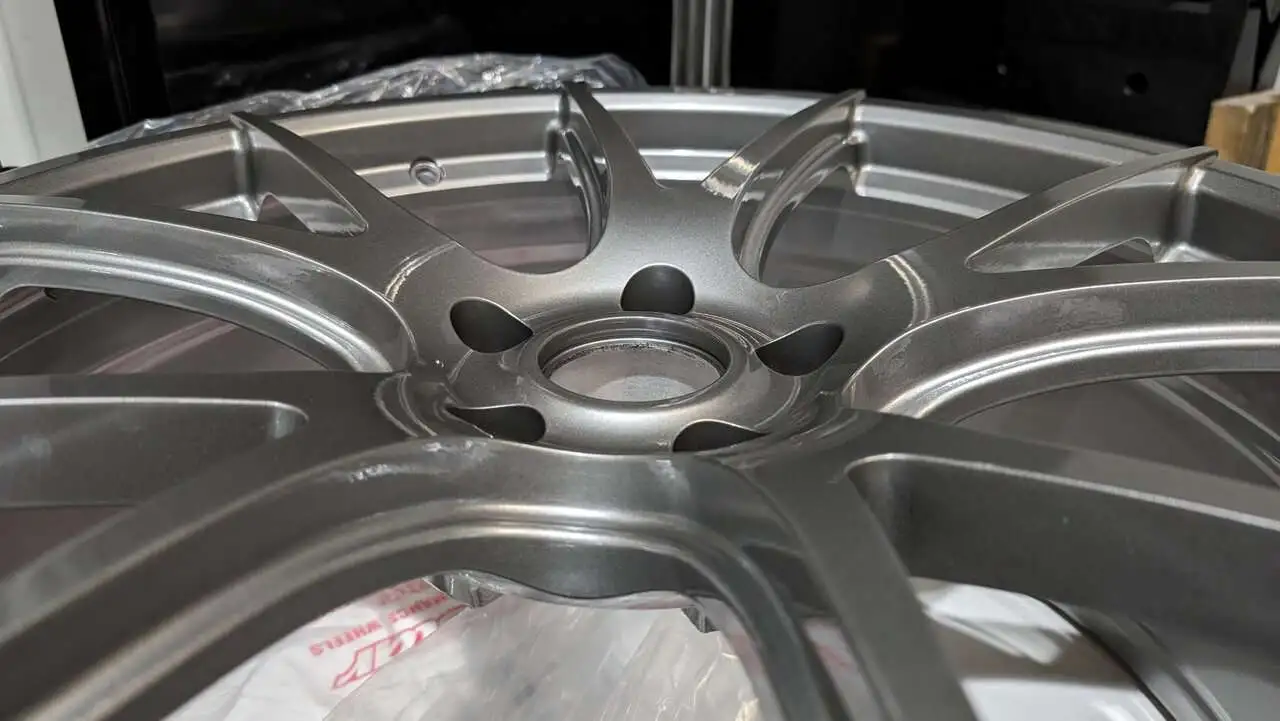

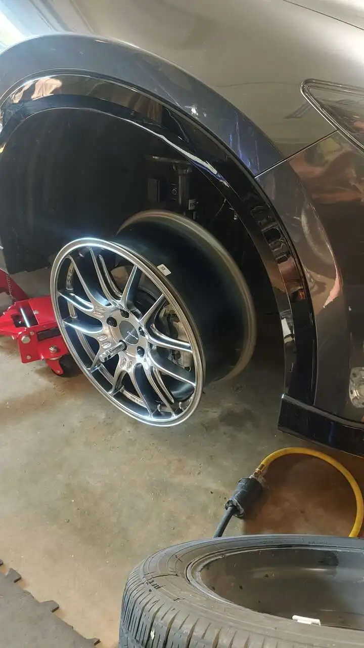

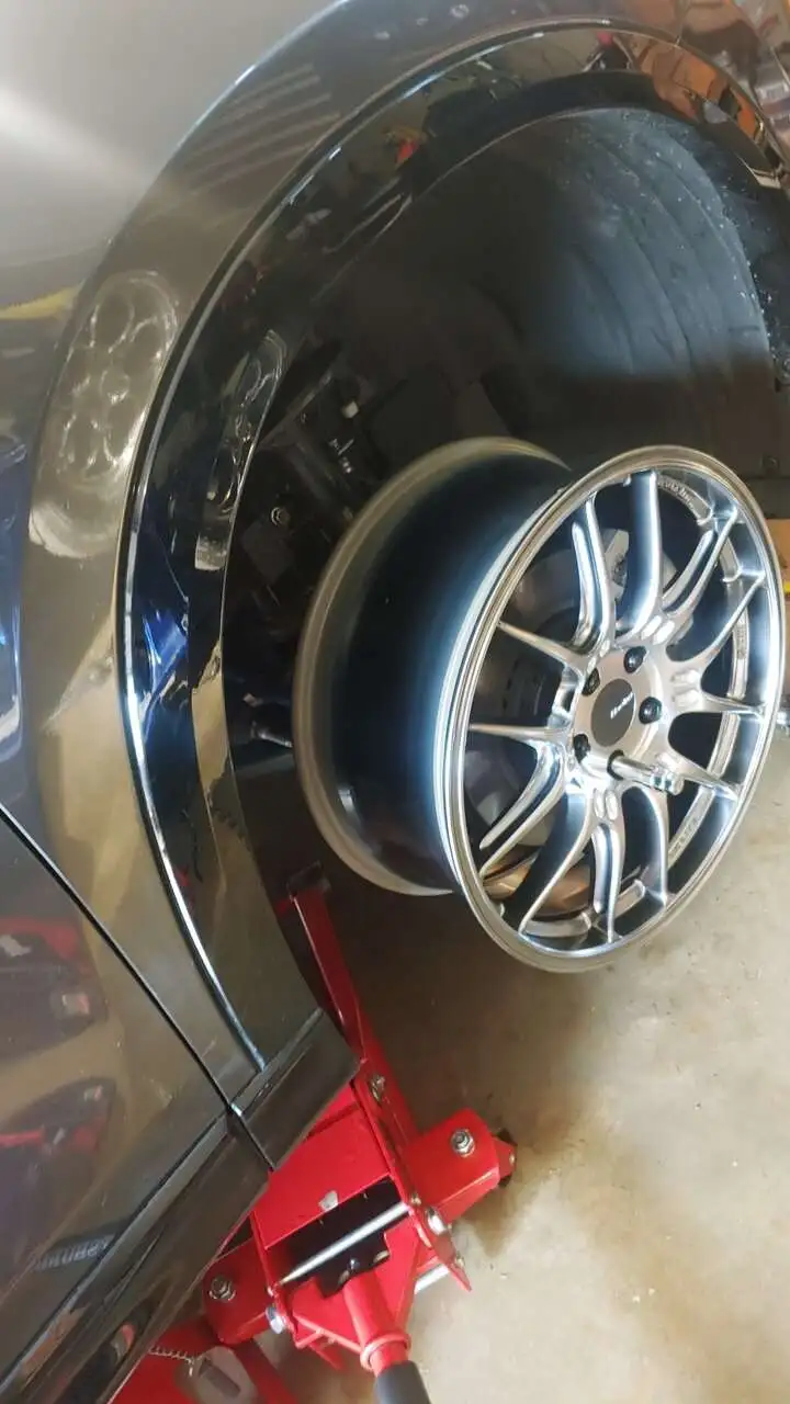

I did a fitup today. It looks about perfect, 19" x 8", 45 mm.
We like black lug nuts with the black center cap and black fender trim.
Wheel weighed 19.8#. They were advertised to be 25#. Some say the factory 19" wheel weighs almost 32#. 12# per wheel reduction is a good thing!
We are ready to mount as soon as the ceramic coating arrives..

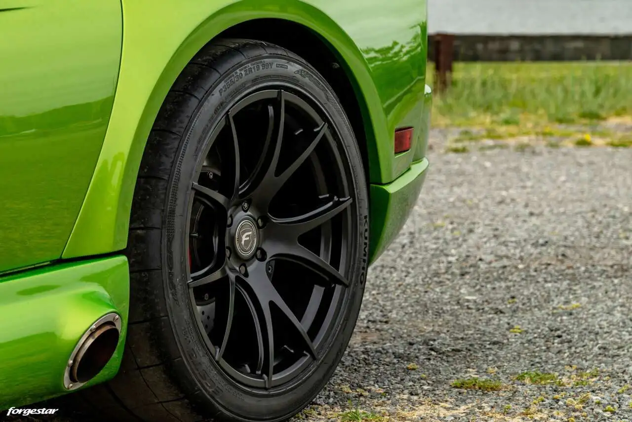

I'm on the hunt for short lug nuts because I don't like the protruding look. I also want closed-end, black or gunmetal. Something like this:
green-dodge-viper-black-racing-stripes-6-lug-matte-black-rims-concave-forgestar-wheels-f-scale...jpg
These are close: KICS 20 BULL LOCK 12X1.5 1.5 ACORN WHEELS RIMS LOCK LUG NUTS CLOSE END BLACK U | eBay
But I'm looking for ones that have a floating seat which won't scratch off your powdercoat, like these: Project Kics R26 Shorty Lug Nuts with Locks - Composite Black - JHPUSA
One alternative is that you could install lug covers over an open lug, but that feels like a cheap solution.

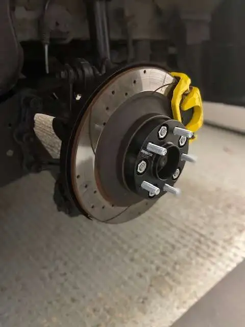

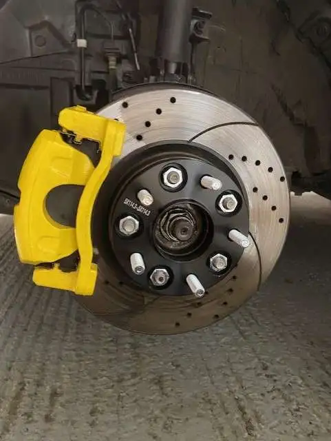

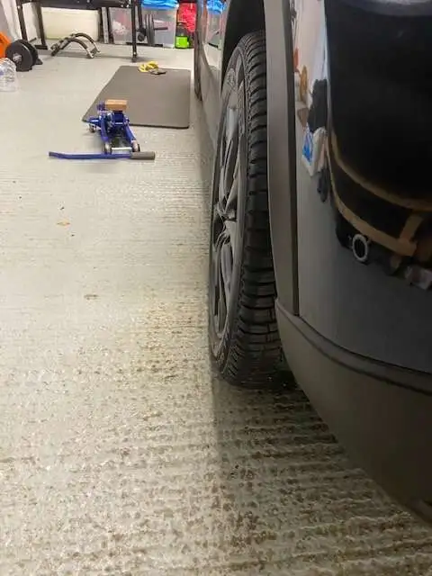

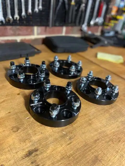

Installed some wheels spacers... 25mm in the back, 20mm in the front...

Those look great.
BTW, who's rotors are you using?
I just ordered a set of R1 Concepts for the front. My OEM brakes are squealing. I've lubricated and filed the pad slide notch. It helped a lot but still squeal now and then. And a good excuse to get drilled and slotted....

Those look really nice. If those clear the front inside fine then my 19x8.5 et43 should be good as well then.
Those sound nice. Curious how much clearance you will have up front on the inside with a 9" width at stock et 45?
By the math I have about 30-35mm clearance and I'm adding 1" (25.4mm) of section width in each direction. That's why you can't go larger than 245/45/20 or 245/50/19 at this offset.
