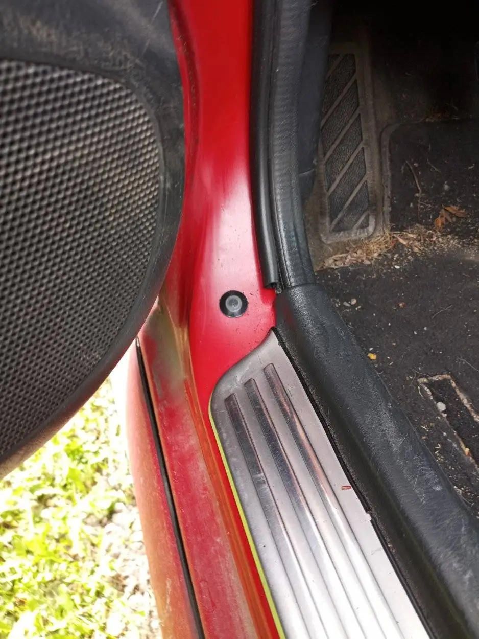

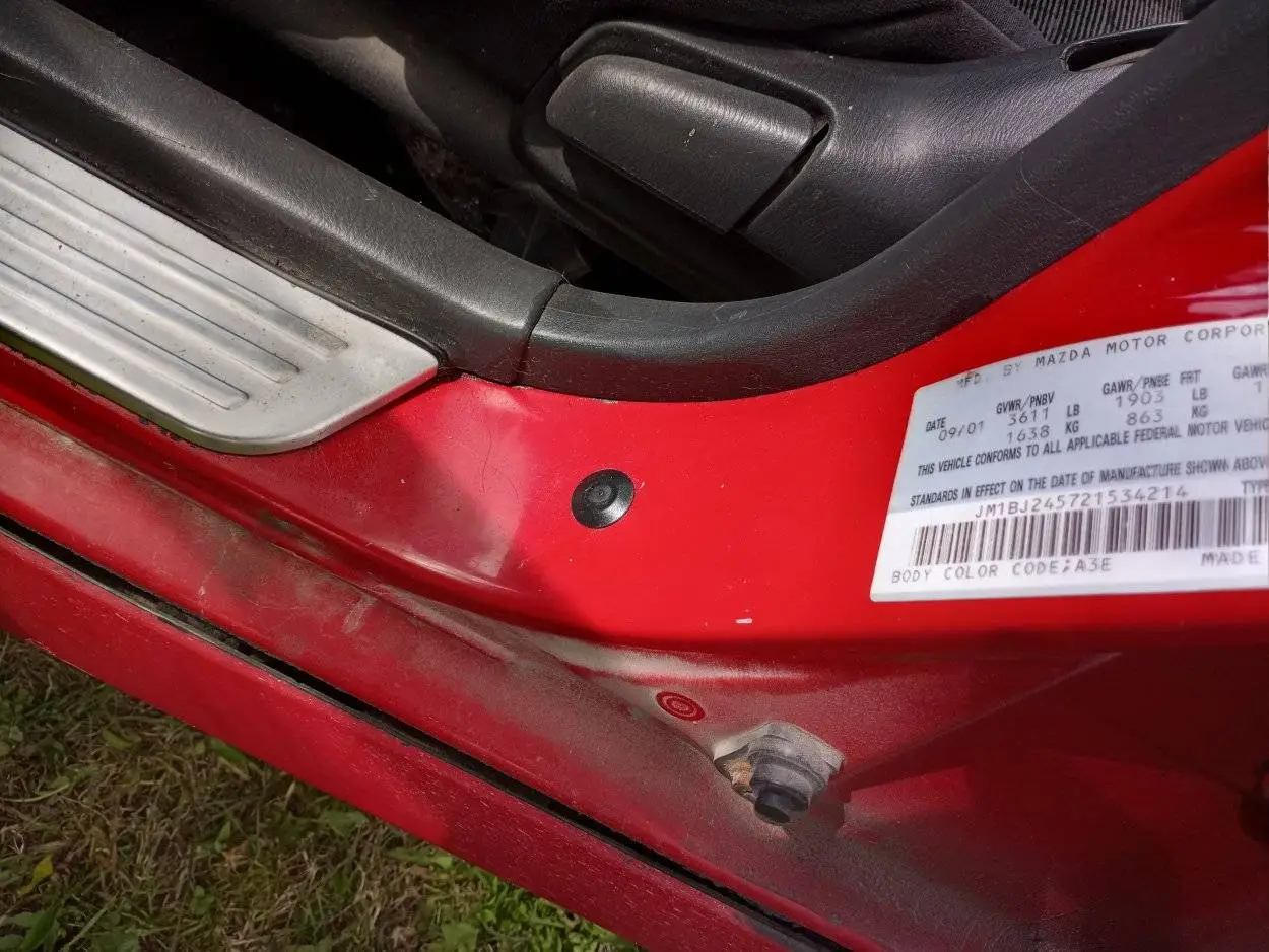

Find a place that drills holes in your car to get their spray wand in...You need to get the spray up inside your pillars and such...They have cool looking plugs to cap the holes.
The spray inside the pillars will stay there and protect the metal. The spray under the car will wash off and maybe need a yearly treatment.
