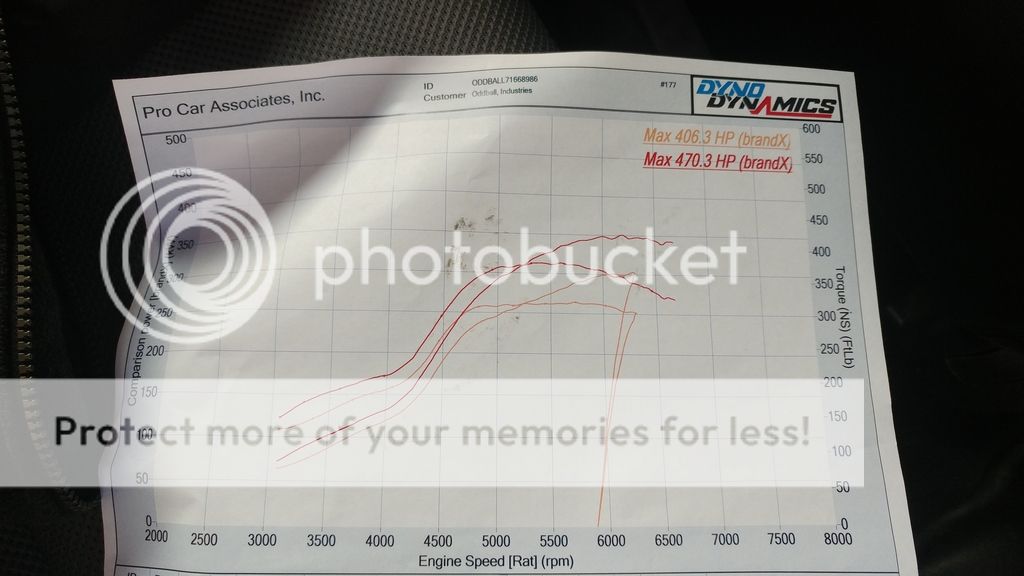

Long time since an update. But the car is finally done being tuned. My original Injectors had 199k on them, and with 2000cc/min of meth spraying, I was out of fuel at around 29psi of boost on the pte 5862. I suffered an Injector failure on cylinder 3 2 days before the dyno time was scheduled for the tune to be wrapped up. Luckily my friend Miguel sold me a freshly cleaned set he had and I was able to swap them out. With the new Injectors, we were able to finish at 35psi from 6000 rpm to my 7500 rpm Rev limit.
Here's a video of my friend Kevin and I getting tuned by Mark on the dyno
https://youtu.be/vFD59LjSYGs
Here's the dyno sheet of my first and last pull on the dyno. It's a dyno Dynamics twin roller, twin retard dyno that reads 10-12% below the typical dyno jet. So that is why numbers are super low. Also rpm was messed up, as we're revving the car our to 7500, not 6500 lol.
Here's a vdyno of a 4th gear log on the way home from the dyno on a nice flat road. You can see the curves are exactly the same and the vdyno puts me in that 10% correction from the dyno Dynamics sheet
