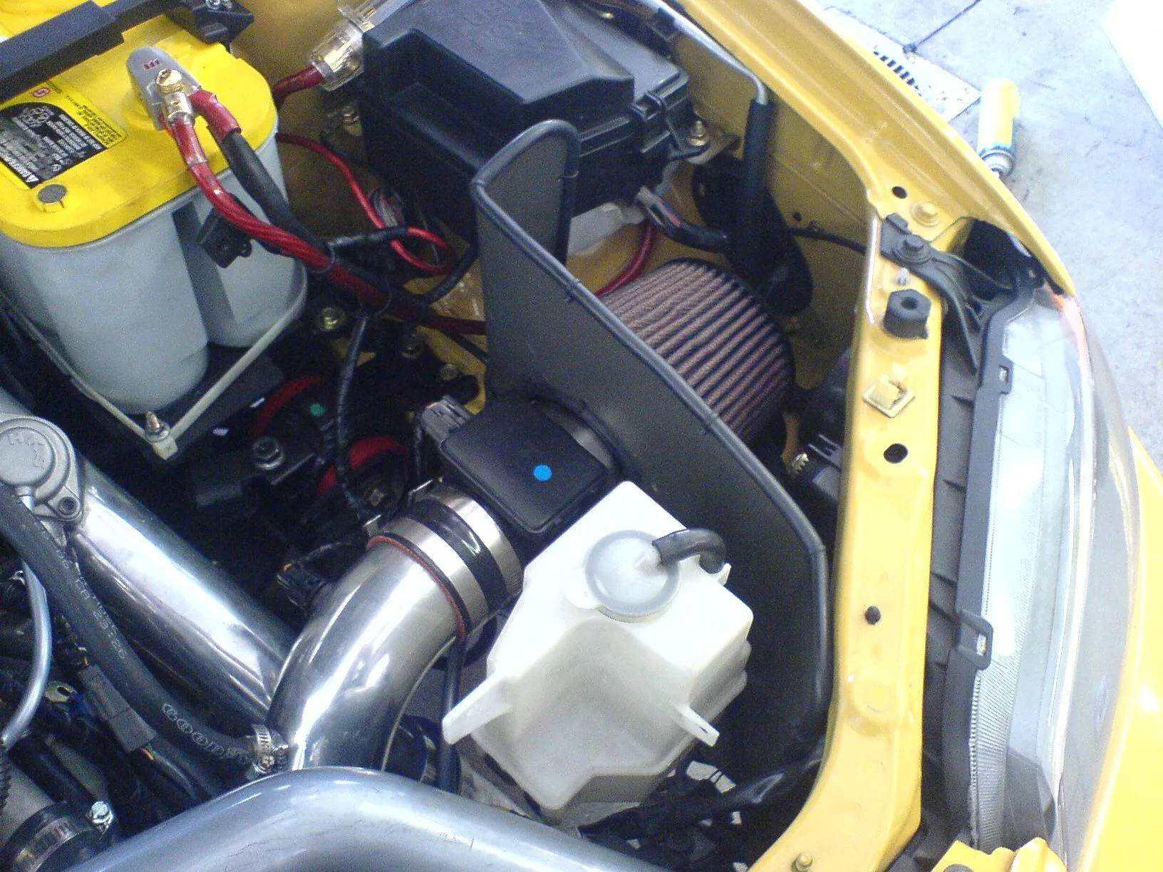

I went short ram because I have a FMIC and live in GA where weather is very unpredictable. I made a "baffle" to keep the hot air from the fans off of the filter. Simple? Yes. Functional? I would have to say so, at least to some extent. Using a diagnostic scanner I monitored the IAT readings with and without the baffle and there was a average difference of about 7-8 degrees, lol.
That is clean - Well done. (thumb)
