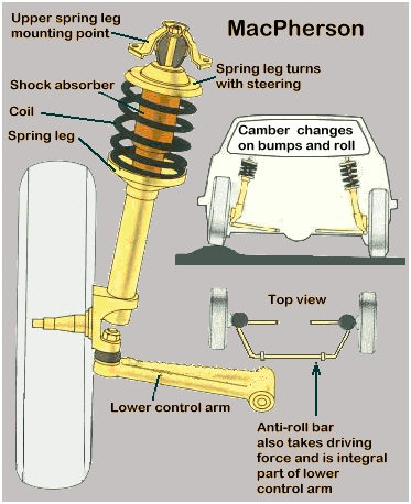

A shock absorber is a motion damper that controls the speed of the wheel's motion. Typically a sealed tube, filled with oil and a piston that moves up and down, retarded by the oil.
A McPherson strut is also an oil-filled damper, but is also a structural part of the suspension, replacing the upper control arm, with sacrifices in suspension performance in return for simplicity and price.
main-qimg-64d07e84f5e3ea6b00e5a5896c61d126
