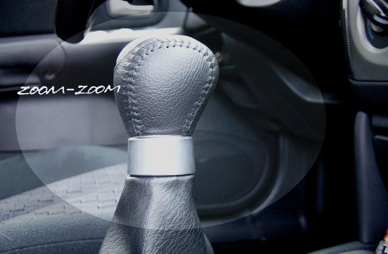

Shift knob from MAZDA3 s 5-Door

My P5 knob fits fine on my roommates Miata. All Mazda's, except the 2nd gen RX-7's use the same thread pitch; M10x1.25. Just as an FYI... I'm interested in getting this knob, too; The GReddy counterweight proves to be a tad too chilly in the mornings. =)

The sedans and the P5 use a shift lever with an M10 x 1.25 thread as flat_black states. The MP3 shift lever uses an M8 x 1.25 thread. My understanding was that the MP3 and MSD use the same shift lever so that the MSD also uses the M8 x 1.25 thread. I'm not sure about this now so MSD owners ought to check before buying a knob that fits the P5 and Miata.

Let me end this right now. Please see pics below. My 2002 P5 with Mazda 3 shift knob. Thank you. :mad:
