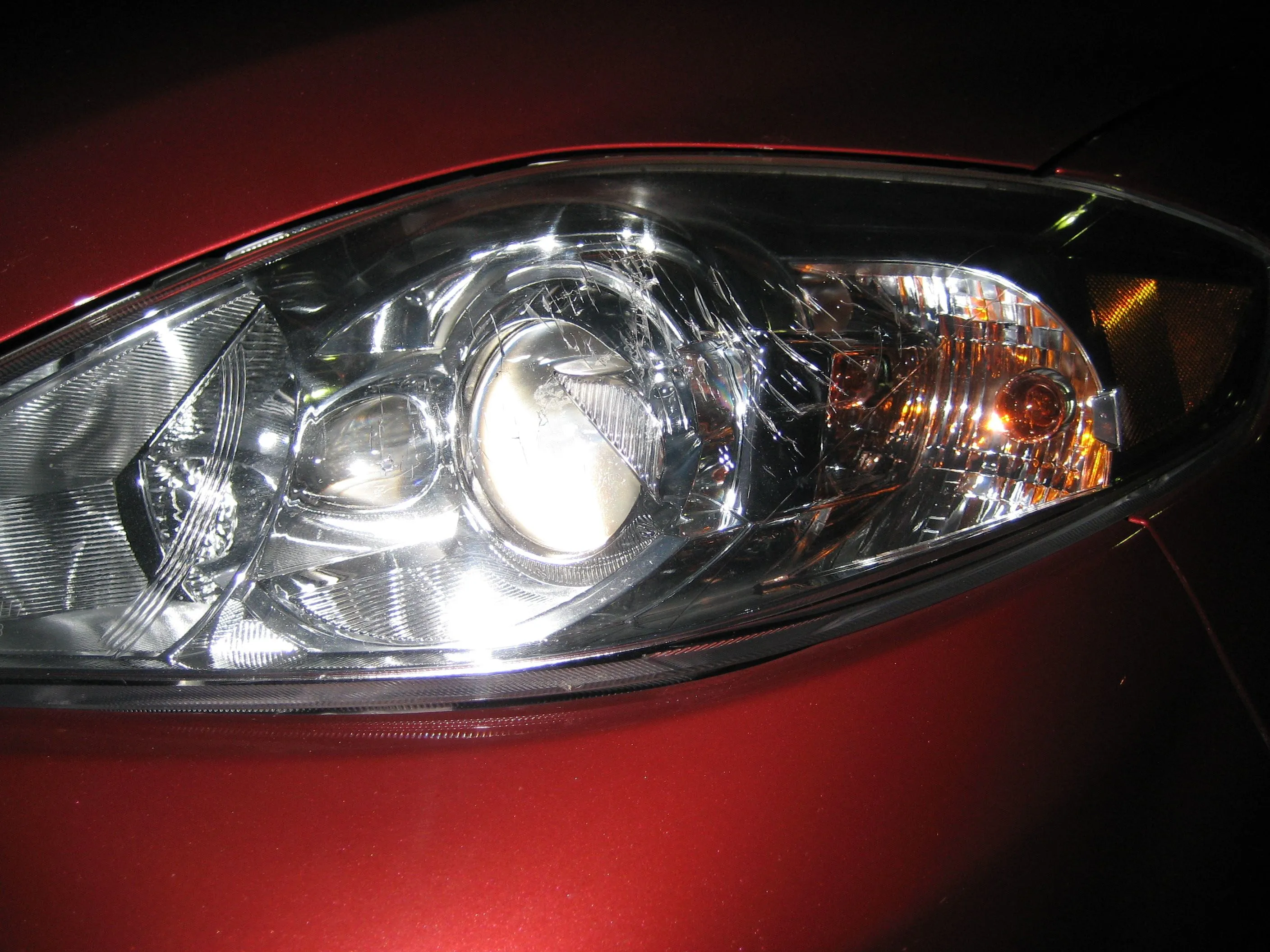

If this works (first time) - here are the headlamp assy pics showing the cracking/crazing.
Any ideas? - could this have been front end impact?
Thanks for any feedback - I am getting ready to do battle with the stealership - hopefully they do not make this difficult...

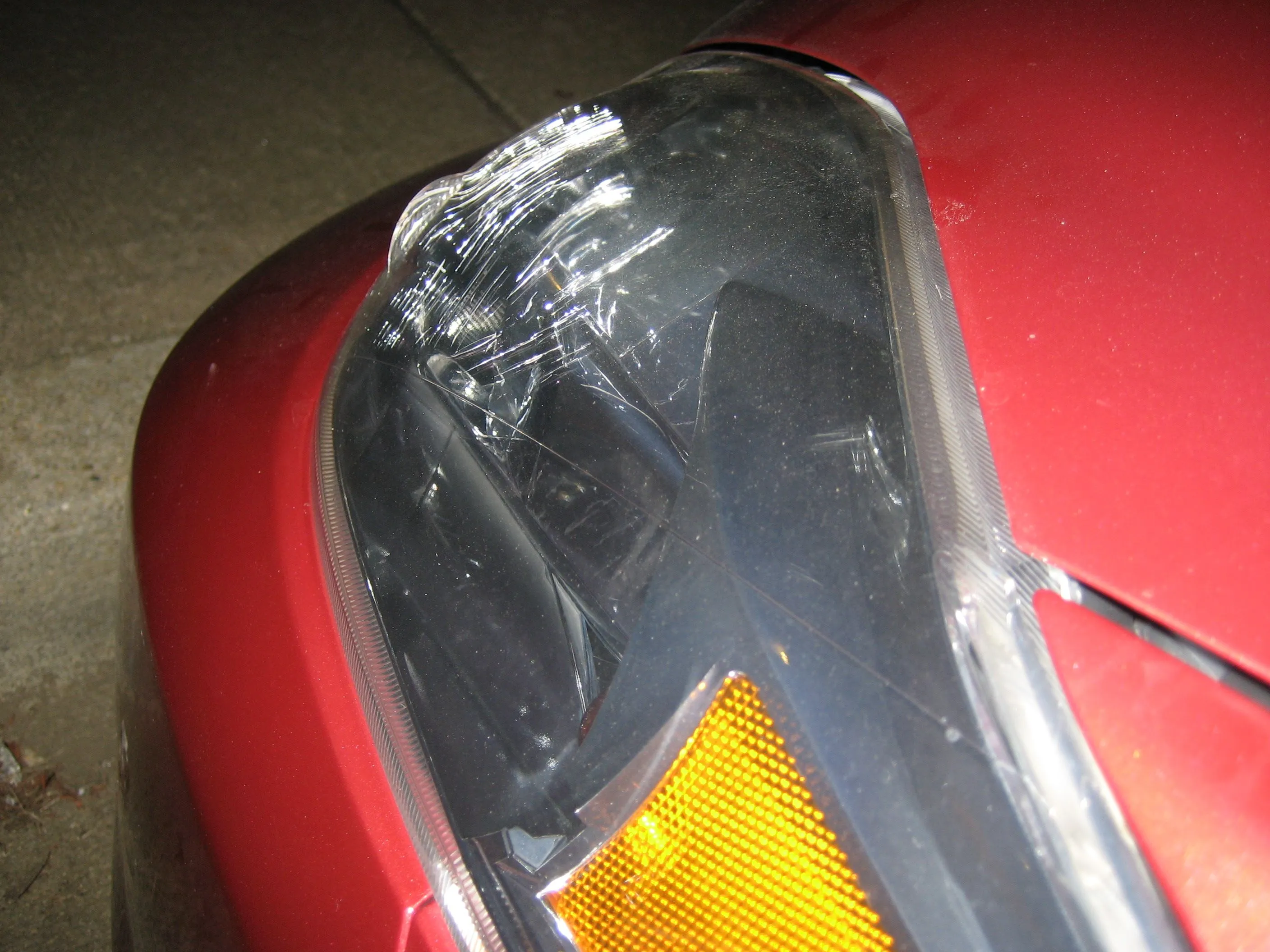

I'm not a thermal engineer by any stretch of the imagination, but those cracks are definitely not indicative of damage that would be caused by too much heat from the bulbs. In cases where temperature plays a part in a failure, it is typically one large crack rather than a spiderweb sort of crack. I would bet someone backed into it. Or vandalism, like you said.

Those look like impact marks.
Heat would likely discolour the lenses, yellowing them prematurely. It would also cause ripples in the material. What's the cover made out of? If it's polycarbonate (Lexan) it bubbles and turns brownish gray when it melts. If it's another plastic, it will get extremely brittle if it gets pressed on. If you touch it - USE GLOVES - it should fall apart in your hands.
That's assuming that it's possible. It's probably not. From what I could see, the SSU bulbs are a 55W bulb. (And yes, that's just a little less than the heat given off by a bog-standard 60W incandescent light bulb.) Thermodynamic calculations on a similarly-sized system estimate that the 5's panel will dissipate about 70W on a 40C (104F) day. That's without taking into account wind chill.
In other words, it's more or less impossible for those marks to be caused by heat; partly because they don't look like heat marks, and party because you're not generating enough heat to muck up the plastics.

Can you "feel" the cracks on the outside? I would be very hesitant to put any glues or adhesives on it.
I have looked at the pics many times, and it is hard to figure what made those cracks. Do you think maybe someone was pushing down on each corner to check the struts?
