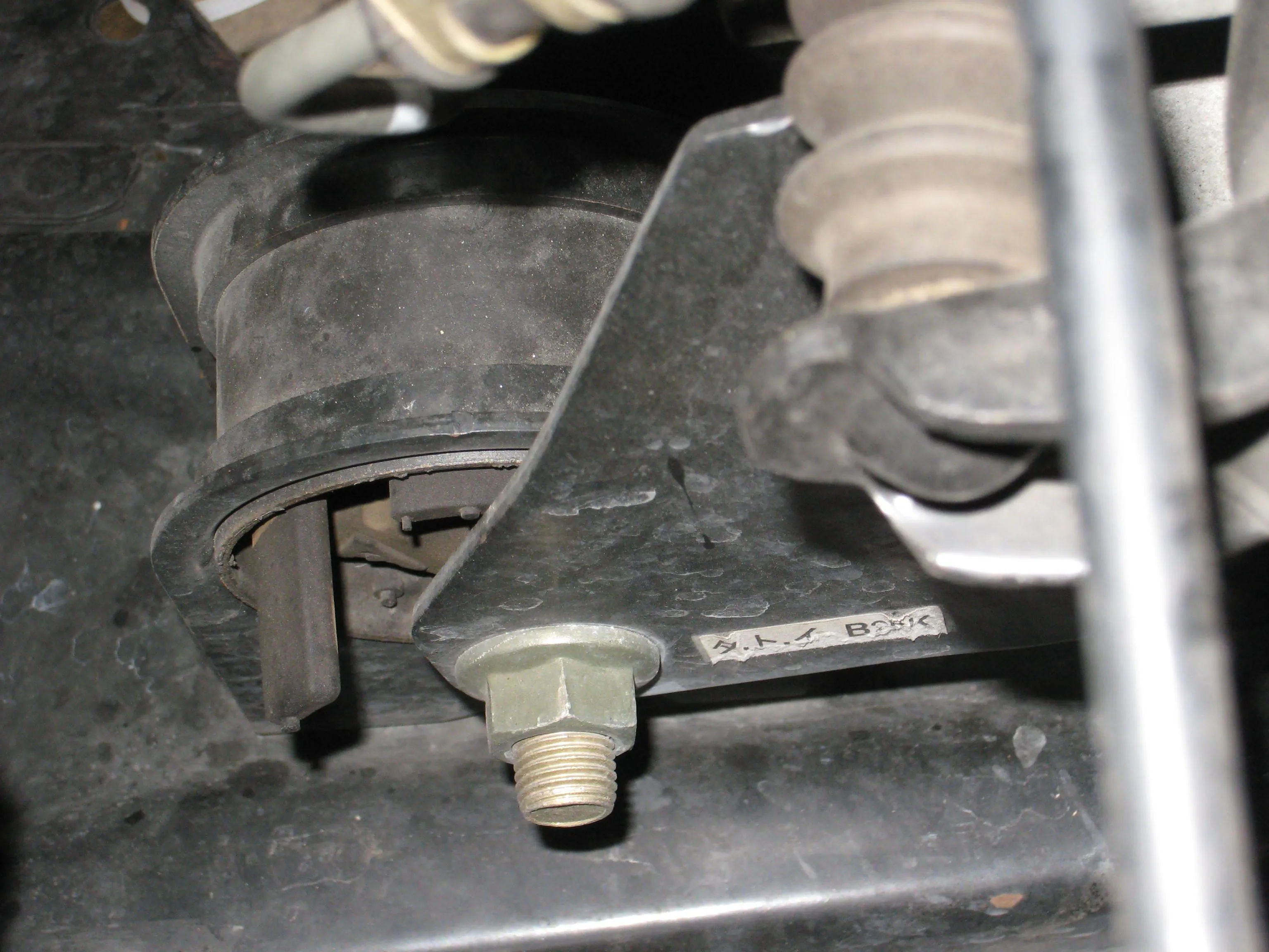

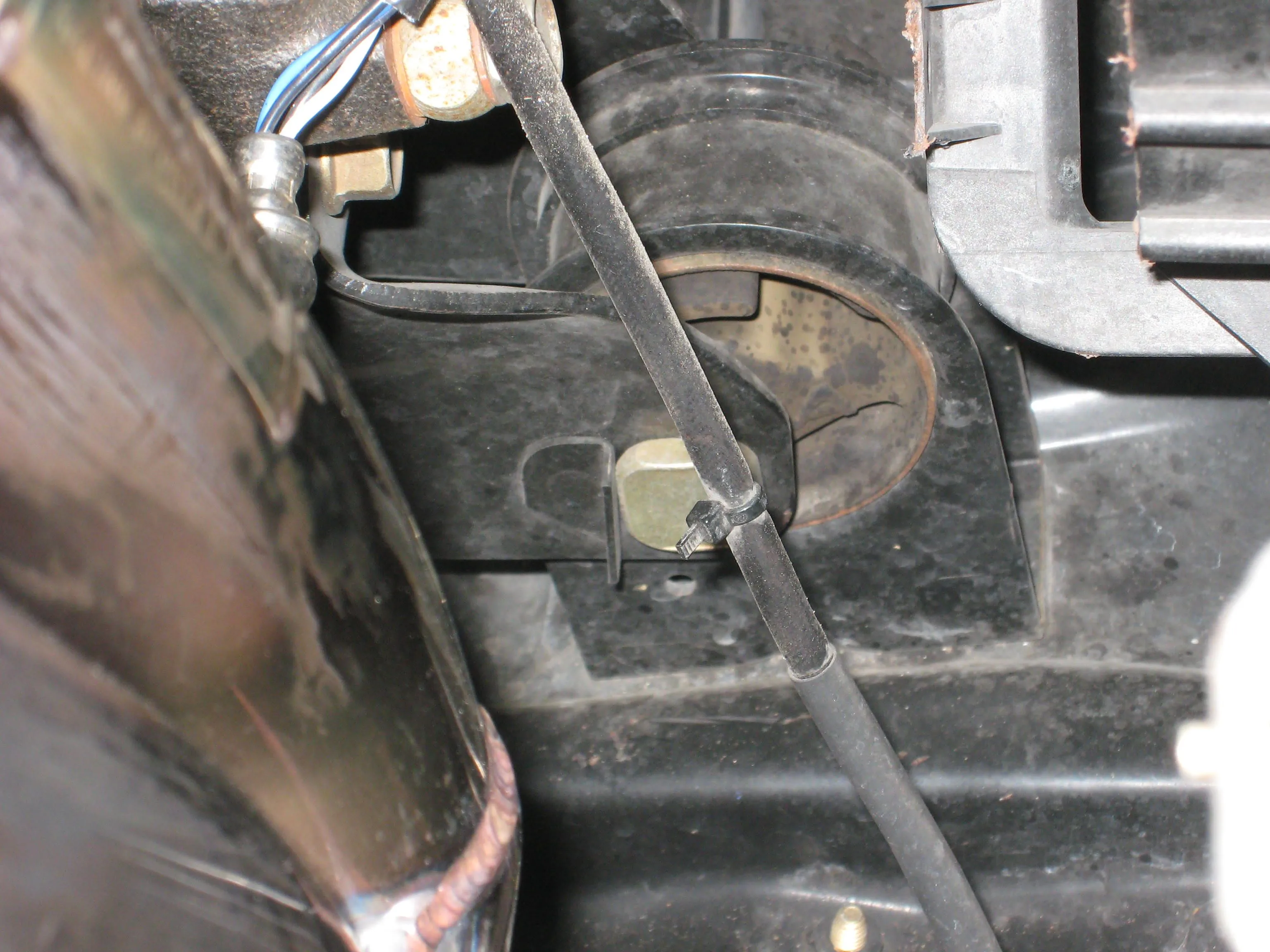

I checked the intake and it's on fine so it's not that. I thought it may have been torn mounts but some people are telling me that the factory mounts are "marshmallow" mounts (wth?) and it's normal for them to be how they are right now (see attached pictures).
Your mounts may be toast (although the front looks ok and that's usually the first one to go) but they won't cause the problem you're experiencing.

If you put a flex fitting on your midpipe it'll help with the exhaust vibration but they cost about 70.00. Your mounts don't look broke & oem are nowhere near stiff to cause vibration. Kart boys add vibration due to being stiffer as was stated...if you have them . Yes, you can use that oil filter. All of that aside, you may have other problems. I have obx, no flex fitting on midpipe, kart boy exhaust hangers & the 626 filter & have no crazy vibration that you seem to be having.....& with syn oil even.
