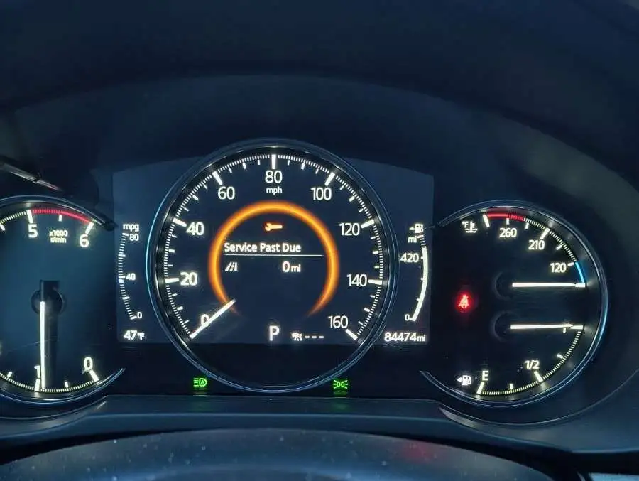

Does anyone know why this message started appearing on my Mazda CX-5 2019 only when I turn it on in the morning?
Is there a way to clear it and not let it appear anymore?
I serviced the car last month at the dealership.
When I go into the setting it shows there is no service that is due and under the Warnings setting it says "no warnings found".
Thank you for any insight.

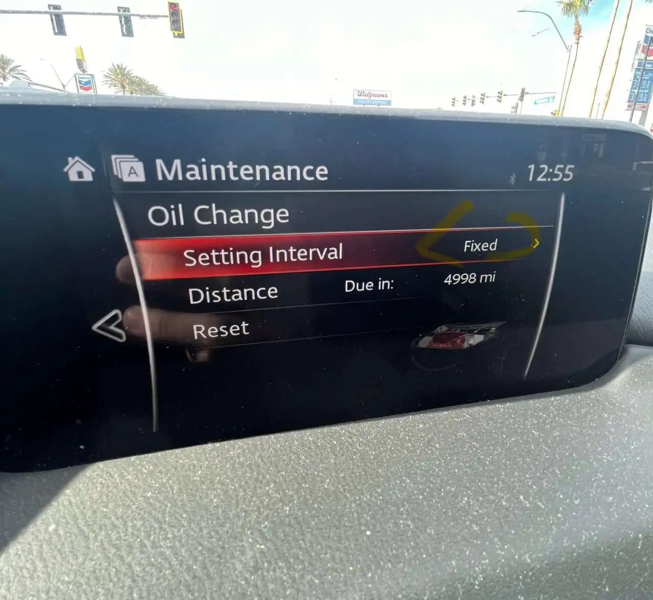

Happy to report I was able to fix the annoying "Service past due" issue. Thank you to anyone who helped in this thread. What I did was go into the setting: Oil Change - Setting Inteval - and changed it to Fixed instead of Flexible
