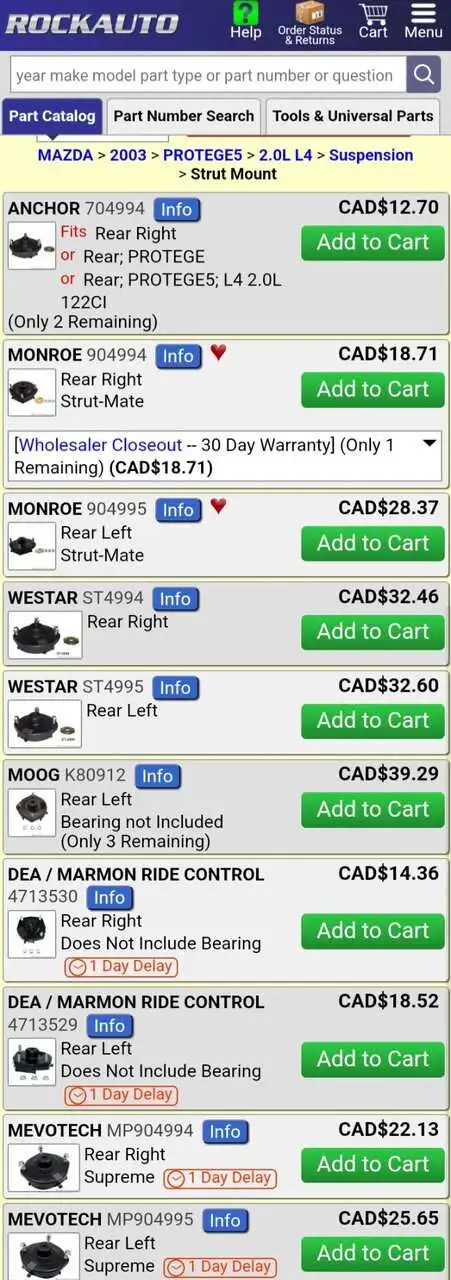

I’m not sure where I can get the rear strut mounts or what the parts number is. Any help?
Rockauto.com has lots of choices to pick from,..
Rockauto.com is pretty good with having their parts fit.
Quality and brand names are a matter of opinion.
OEM replacement parts are really expensive.
I was going to mention that RockAuto has a Monroe rear-right strut mount on closeout, but PCB's screenshot beat me to it. $14USD; only one remaining. If you need other items (e.g. windshield wipers!) then you can make it worth the cost of shipping and installing just the one mount to see if it helps. I replaced my rear-right as I am getting clunks going over small road imperfections with my original strut mounts + six year old KYB struts. It didn't seem to help, so I'm replacing the rear struts themselves and rubber spring seats next.
Things to consider adding to your order to make the shipping worth it,..
Light bulbs (signal, marker, reverse, tail, etc as well as a couple dozen headlight bulbs. lol) oil filter (the longer one), air filter, PCV valve, spark plugs (NGK copper V-groove), fuses,..
