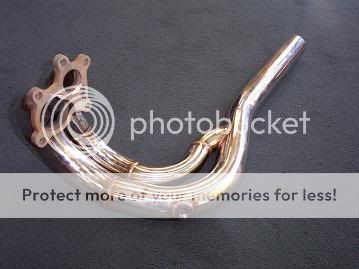

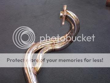

you would need a custom downpipe made.
like this but dont merge the two together again, just make the second pipe go to atmosphere.
