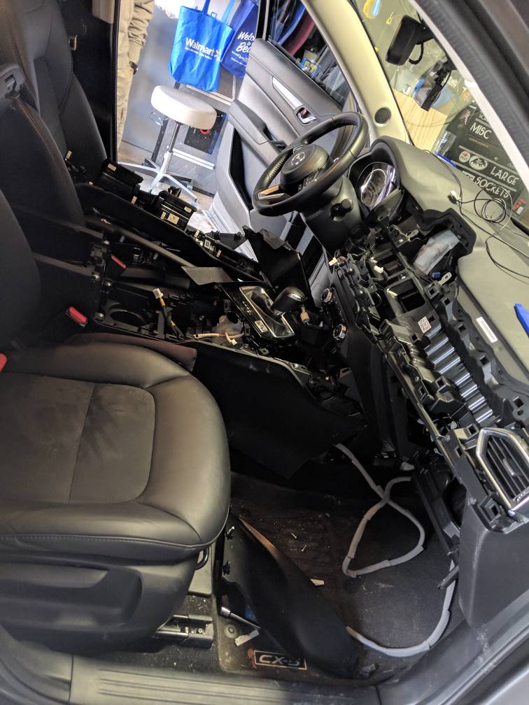

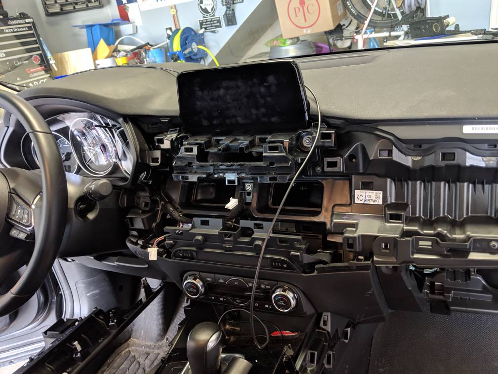

After my last trip home and driving a Ford fusion with ACP/AA, I stopped by the dealership and bought the car kit. Got the kit installed yesterday and the update finished today.
It's great to have, but no where as intuitive as the fusions. But for 196$ OTD and an hour in my garage, it was worth every penny.
Now I just need to figure out why the GPS is several miles off.
And for the record, taking apart a car less than a year old was nerve racking!

Installed the update for ACP/AA and it was entertaining. At first the update wouldnt load and i freaked out when i saw the thread that said i had to do the software first. So i poured another glass of scotch and called in a night. On Sunday i had to go meet someone for a thing, and that took forever, so i attempted to install it again.
This time it loaded without an issue. After it was all said and done, the maps said i was in a lake that is over 30 miles away. Drove around for a bit humored by the fact i was "driving on water." After i finally reached my no longer amused stages, i did the three button reset and all is well.
AA is a lot buggier on this car than the last two rentals i used it on but it was worth every bit of the sub $200 i paid for it.

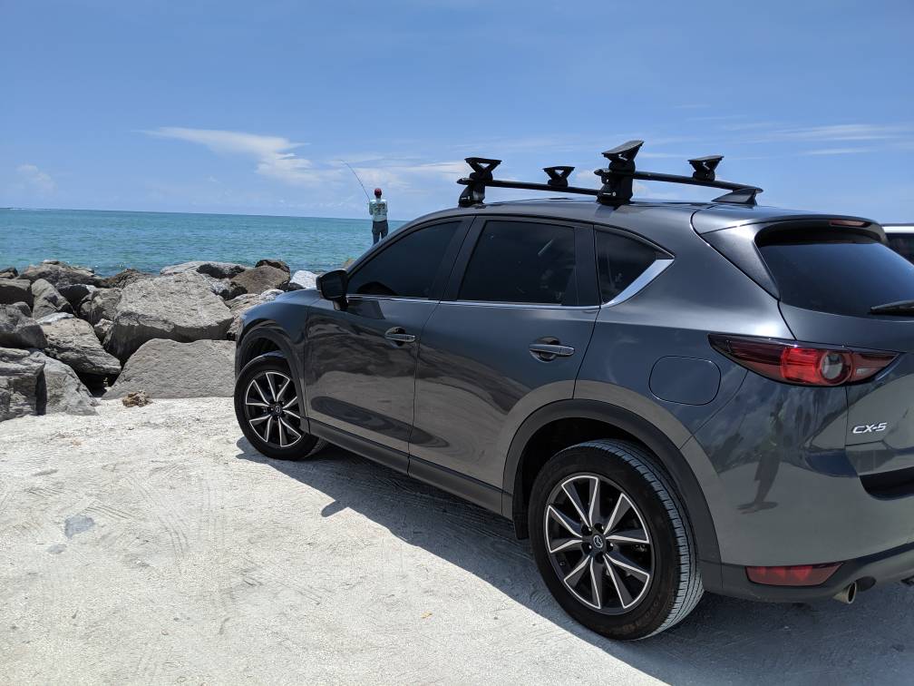

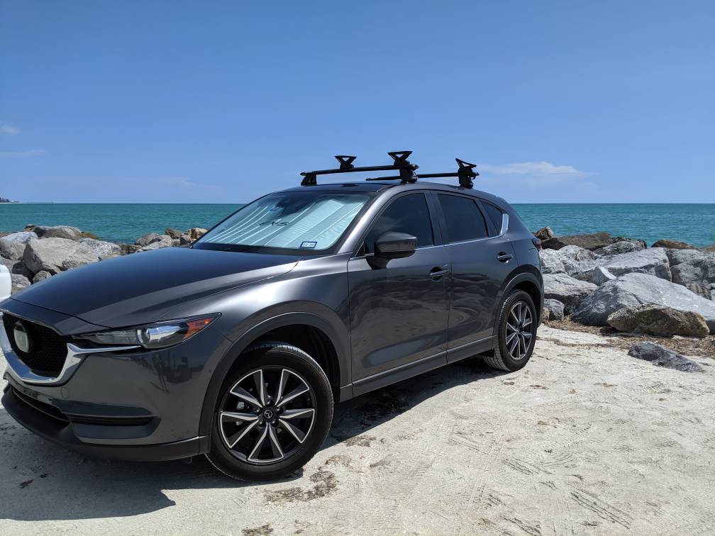

Recently moved back to Florida and have been running the roads hard between Seminole and Brandon. Love the rack and the versatility. Here are a couple quick shots of her this weekend out fishing.
Parked in the sun:

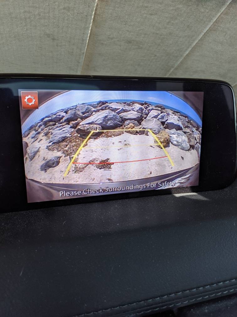

Something about having this image in the backup cam makes me smile:
