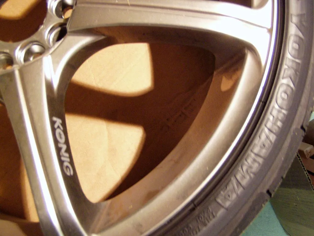

well those are my old falkens...bad in the rain...my new tires are yoko parada's 215/35 zr18...sorry for the lousy pic
which Falkens? I had Falken Ziex 512s on and they were great in the rain, right now I have Paradas on and the road noise is killing me, can't wait to go back to the Falkens.
