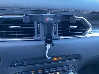

Really did not like the placement of the USB port to plug into to run AppleCar. I was not one to want to leave the phone in the center console....I wanted to have my phone on the dash for easy access...So i needed to figure out 2 things.
1) How to mount the phone?
2) How to wire from the USB port in the center console to the middle front dashboard

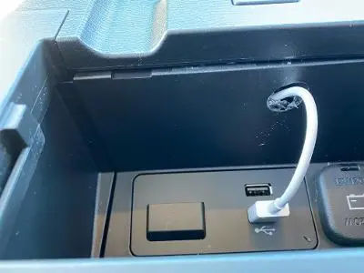

I may be the guinnea pig as i drilled a hole in my center console and it went NOWHERE...so DO NOT DRILL ON THE SIDE OF THE CENTER CONSOLE.
So front wall near the SD CARD, USB PORT and accessory socket, is held in place with two connects, that with a small plastic splitter or if want increase the chance of denting the soft plastic, use a butter knife or flat screwdriver the front pops off.
This is where a hole can be drilled and the wire run down to the bottom of the passenger seat to start its journey to the center console (the passenger seat was all the way forward and i was in the backseat to do this) (ensure both USB ports have a wire inserted and the SD card and accessory socket are closed....a lot of small plastic debris went flying and you do not want these to get in the connections).

From there i ran the wire up the left side with the glove box open the leather trim that runs from the passenger window to the steering column, pops off with a little pull from the bottom. i started from the door and lifted the pieces towards me and up and worked my way to the center, stopping when i can access the center so the entire piece was not removed.
There was a small area behind this center trim to hide excess wire, so one i got this far....i went back to the center console and pulled the wire snug and only left a small portion of the wire as seen above.
You should try to find one of those black rubber plugs to plug the hole in the center console.
Cable would run through it.
Yes was thinking of something like that as well...Wish I also used a black wire but will be a quick replacement if I do decide to switch.
