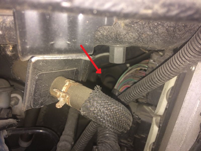

There is a wiring harness that goes through the firewall behind the battery. You can punch a small hole through the grommet there.
Had to swap out the battery today, so took the time to run my wire through the firewall. Found the large grommet behind the battery and ran my wire through there,
Easy peazy (with the battery out of the way). :)
For future reference, here is a (crappy) image of where the grommet is on the firewall (behind the battery).
