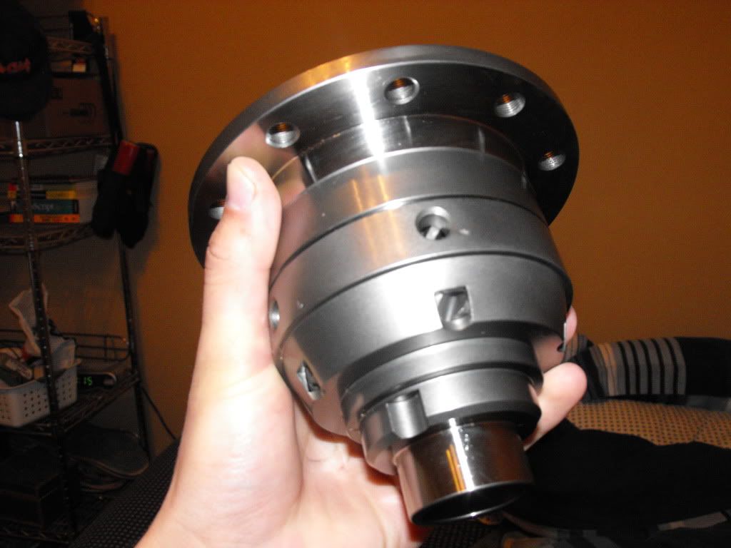

If you are looking for a diff do not install a used one. (I would be surprised if you even find an MSP in a junkyard) go with a new revised welded diff or an MFactry LSD.
that. is a mfactory lsd. its amazing. jdm sam can hook u up if u wanna get one.

alot stronger then the stocker i would imagine?? i dont want to go through this same problem i am now. wish i didnt love this car so much, id sell the damn thing.
its way stronger. m factory rates it good up to 1000 HP or something stupid like that lol
