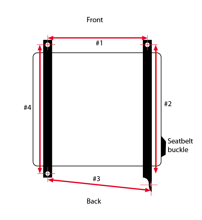

I'm going to do my research on the RSX seats and see how closely the bolts line up to the protege seats. if anybody has a photo of the underside of our seats and could provide measurements (ie how far apart the four mounting points are from one another,) that would really help.

I messaged another member here who's parting out his P5. In his photos i can see the seats are out of the car, so i've asked him to measure the mounting holes on the rails. I hope he comes through for me, I tried to measure the mouting points in the car, but they're covered with plastic.
I'll ask here too...If anybody else has a set of Protege, P5 or MSP seats in there garage, can you post these measurements?

Been down this road.. Depending on the type of rails on the RSX seats you may be able to swap the mounting tabs like i did. But if the RSX seats are not the same width thats were doing a swap make things a pain. I kept the measurements for #2 in your pic the same as the stock seat. #4 started the same but i had to turn both tabs out to the side to make up for the narrower Evo 8 seat.. #1 and #3 are now whatever they ended up being..

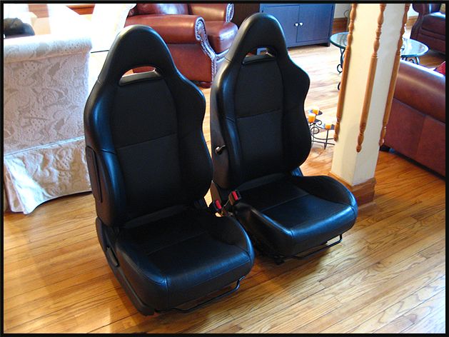

Seats are home and they look great. I'm going to start work on them tomorrow. Also, my buddy has a line on a guy with his own machine shop, so i may be able to get some professional help that way. Either way, i'm so excited, these seats look and feel amazing. P5 seats feel like a park bench by comparision.

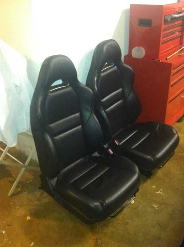

What we did:
I wanted this to go as easy as possible so I opted to have the brackets cut off my old seat rails for use. We cut the pins and weld from the stock brackets to the protege rails, and did the same to the RSX rails. Next came a matter of tacking the rar console side bracket to the rail for a starting point. The seats wer then placed in the car, and vice grips were used to lock each of the other brackets firmly in their final resting place. They were tacked on, and the vices removed, at which point we went on an all out welder bender to ensure safety and solidity of the bracket/rail cross. The seat belt bolts came right out of the protege seat side and were and exact match into the RSX bolt hole. Seats were bolted down and they were pressure tested just to be safe. (we shook the fack out of them) All in all a good days welding, done by the awesome guys at Double Z Automotive here in NS.

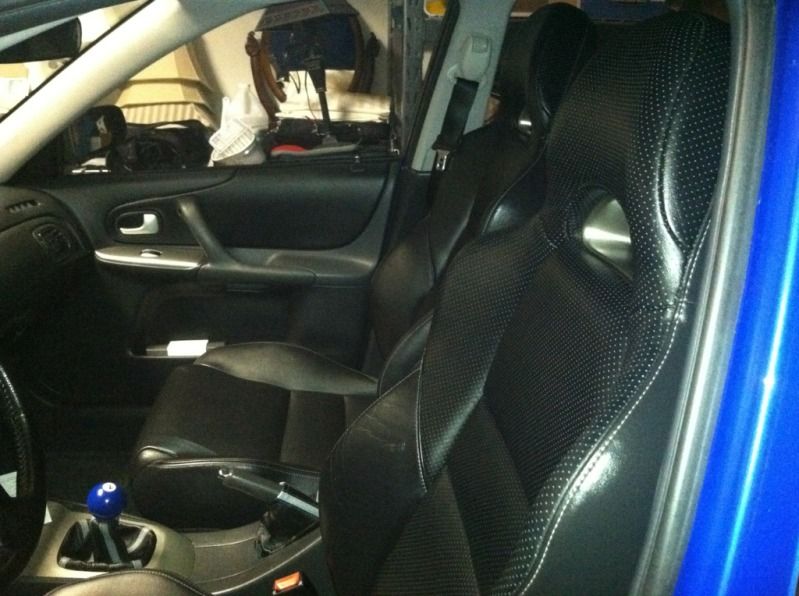

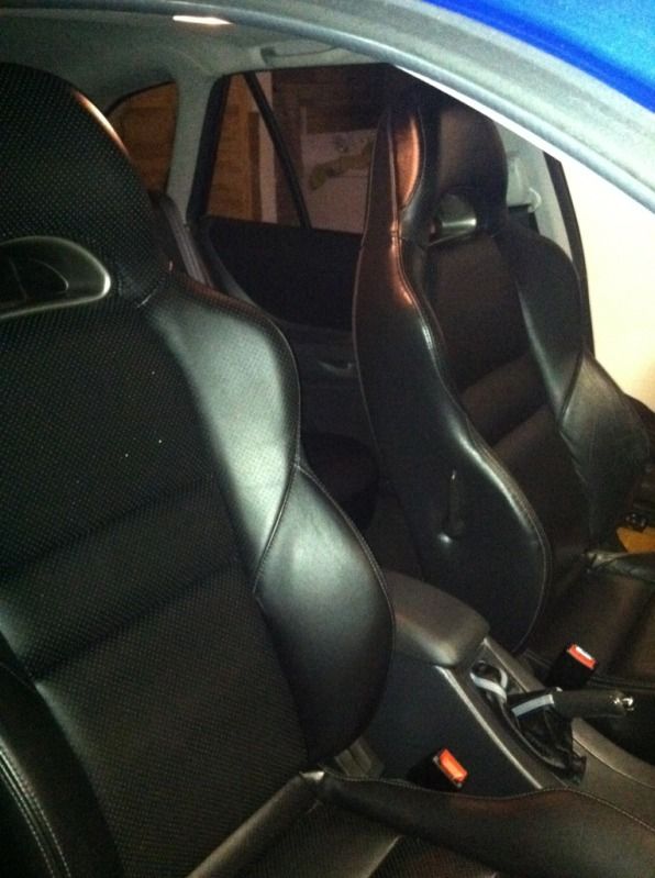

BAM!
Got the car back on Saturday from my fabricator. he made some really heavy duty brackets out of steel, modified the RSX mounting brackets, and welded his new mounting brackets to the existing RSX seat rails. They feel fantastic and look awesome.
My fabricator is going to send me a bunch of progress photos he took while he was working, and i'll post them up when he sends them. All that's left to do is figure out how to kill the airbag light that's now flashing on my dash. I didn't realize this before, but my OE seats actually have side airbags. We need a way to fool the connector under each of the seats into thinking that airbag module is still hooked up to get the airbag light to go off.
