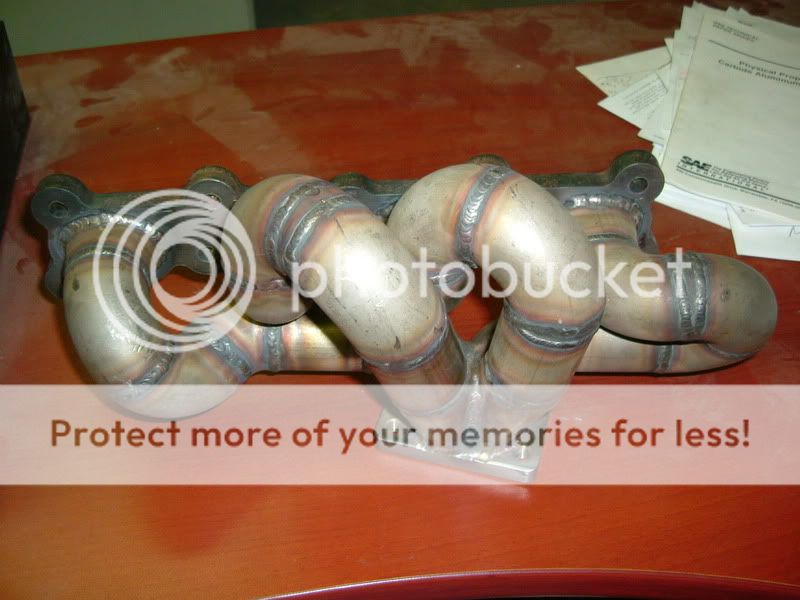

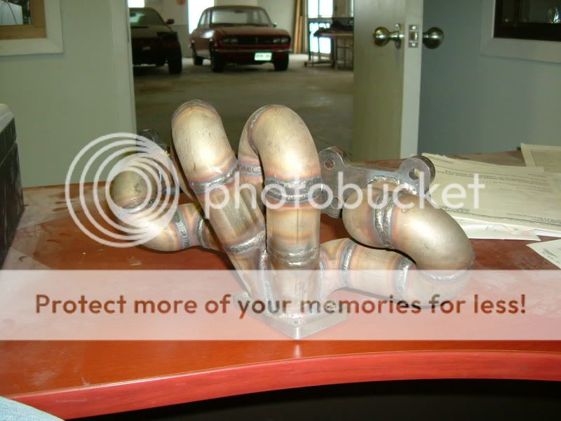

HaHa its a mock up its not fully done, I'm sure and hope the finished product will look a lot better than that
Oh okay, I saw where it was mounted on the car. I was like holy crap i hope hes not gonna run that..
I figured if he was gonna show it off he would want to show the nickle rolls!
^^ LOL ^^
Yeah, we are going to offer a larger runner option, but it will not be for stock location turbos. We can weld on a T25 flange for the stock turbo but I think it will choke it off too much. The large runner option would be best suited for T3 flange turbo's and engines with headwork.

The latest I have is the pictures of it before it gets some final machining and the ceramic coating. The plan is to bring my car in this weekend and have things get installed and dyno tested baseline/stock, with header, and then with 3inch turbo back(hiflow and vibrant muffler).

i don't see any O2 bung or neither the EGR pipe on that many ??

Joe said he was working on the EGR location with clearance issues.
