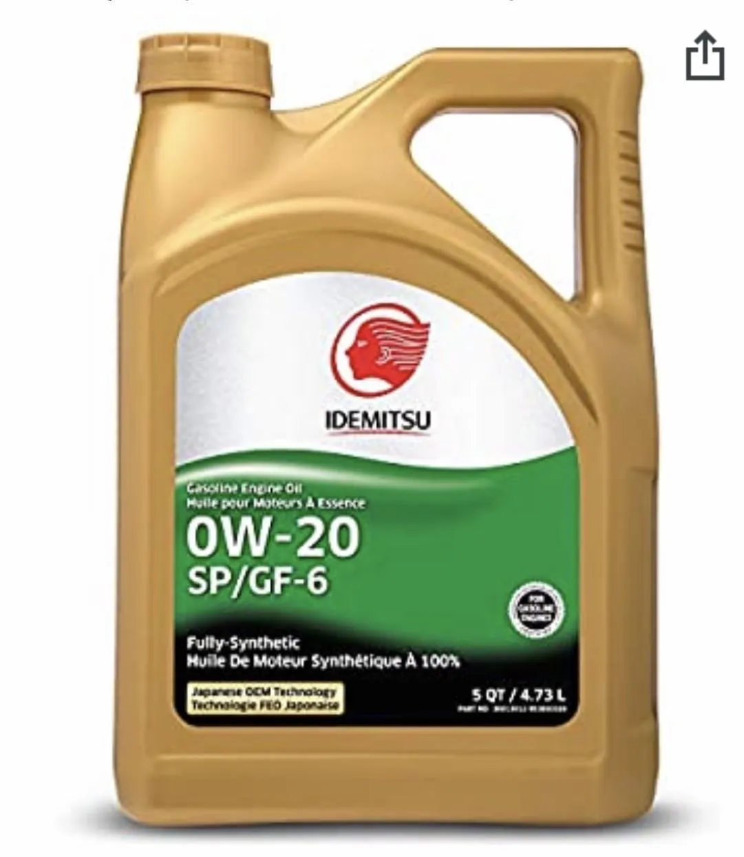

Castrol Edge 0W-20 or any other name-brand oils without moly should be fine to use. If you want moly, you still can get Mazda moly 0W-20 oil and get it from Med Center Mazda with free shipping on $100+ order. If I’m going to switch my Mazda moly 0W-20 oil, I’d try new Idemitsu 0W-20 SP / GF-6 oil as it claims the following improvements over GF-6 standard:
  • 30% more protection against engine wear
  • 26-46% reduction in oil consumption for longer life
  • Up to 24% improved fuel economy
  • 90% more resistant to viscosity increases
  • Three to four times more protection against cold startups
  • 91% reduction in low-speed pre-ignition (LSPI)
  • 6% cleaner engine

24% improved fuel economy compared to what? Vaseline? Certainly not 24% better than other approved oils in your Mazda.
Totally agree.
I always like the 'up to' part of those statements.
So, if it was -24%, that statement would still be accurate.
You have to ask Idemitsu for details. No matter what there’s improvement over almost every area which should be the fact on GF-6 standard. The best part to me on GF-6 oil is the reduction in low-speed pre-ignition (LSPI).
But doesn't the car need to be designed to take advantage of that? Are you suggesting that the existing CX-5 design is susceptible to LSPI?
Isn't it akin to using higher octane fuel than what's indicated?
Totally agree.
"up to" means "less than", or more precisely, "at the limits of the most extreme case we can concoct".
All turbocharged, direct-injected (DI) gasoline engines are susceptible to LSPI. I’d imagine Mazda would program their logic in the PCM to avoid LSPI with the help of knock sensor to scale back timing which will affect engine performance and efficiency.
People like to use moly oil because: "Molybdenum compounds, for example, not only provide frictional benefits, but also have been shown to decrease LSPI when used at high levels."
Low Speed Pre-ignition - Shedding Light on LSPI
And here is ILSAC GF-6 performance relative to GF-5 and API SN Plus performance:
I forgot to mention GF-6 oil offers better protection on timing chain which has been heavily criticized since we switched to much thiner oil for fuel efficiency purpose. No matter how you look at it, GF-6 oil is superior than older GF-5 oil.
Okay, but if the CX-5 is programmed to always operated in a safe-zone for all the approved oils, there may be no benefit to using better than specified. It would only help if Mazda's algorithms could sense and adjust. I can see the benefit from an engineering perspective, for a prospective application, but am questioning the benefit for the end user of these particular vehicles.
If the PCM keeps scaling back timing to prevent LSPI when the conditions meet, the performance and efficiency will be suffering. If the GF-6 oil can effectively reduce the LSPI, the timing retards would be significantly reduced due to the knock sensor detecting less knocks caused by LSPI. Yes, GF-6 oil definitely will benefit our SkyActiv-G engines which have direct-injection and / or turbo charger and LSPI is an inherent problem. More timing chain protection is another significant benefit too.

I'm surprised they actually give a Noack value. most major brands won't say for 0w-20.
I switched to Amsoil signature series (Noack 8.5, also claims %100 protection against LSPI) a few days ago, I'm up to a quart and a half per 5500 miles with my PP. Hoping I get some improvement for oil mileage. Wish I'd have seen this thread a little earlier, I might have tried this oil instead.
Density @ 15°Cg/cm3ASTM D40520.8438
Kinematic Viscosity @ 40°CcStASTM D44544.09
Kinematic Viscosity @ 100°CcStASTM D4458.267
Viscosity Index-ASTM D2270165
HTHS Viscosity @ 150°CcPASTM D48832.64
CCS Viscosity @ -30°CcPASTM D52935,700
MRV TP-1 Viscosity @ -40°CcPASTM D468418,200
Noack Volatilitywt%ASTM D580011.6

Are these numbers you posted from Idemitsu 0W-20 SP / GF-6 oil? 11.6 on Noack Volatility is still not as good as the 8.5 on Amsoil Signature Series.
“I'm up to a quart and a half per 5500 miles with my PP”?
Are you saying your 2.5L burns 1.5 quarts of oil per 5,500 miles with Pennzoil Platinum 0W-20? May be try some 5W-30 oil next time?
Got the numbers off the Idemitsu website. Can't go to 5w30, still under warranty.
