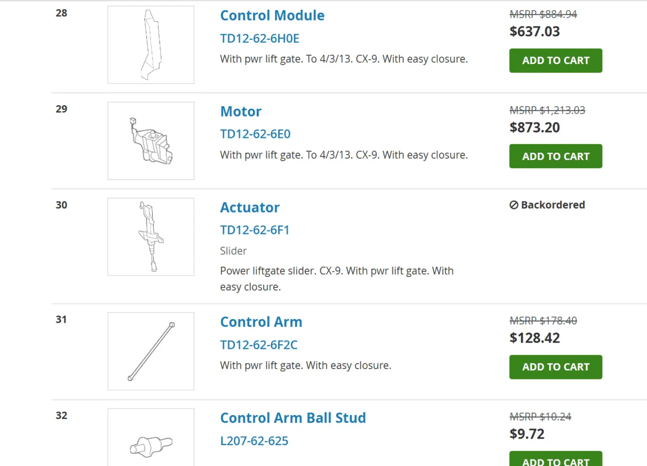

Only a 5 -10 minute phone call. Otherwise you may need to order off eBay. Also don't forget to see what a new one from dealer costs.
New will cost you about $1600 for all the parts related to the motor including the motor, control module, actuator and black control arm, or you could buy a new motor for $700 and see if your other parts are reusable. alot easier to just buy salvage and connect up the wiring harness though.

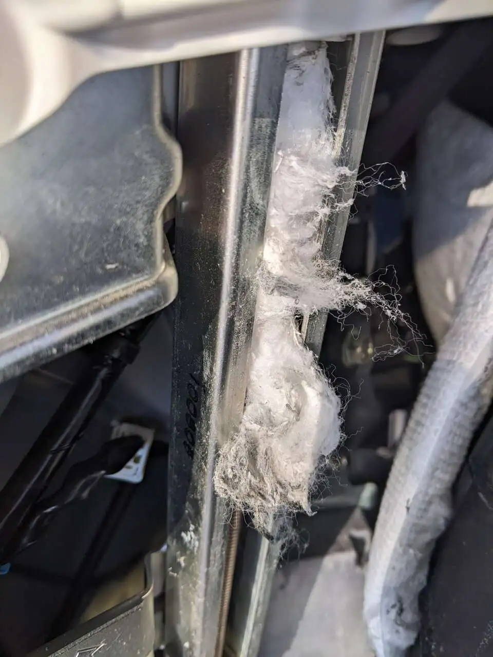

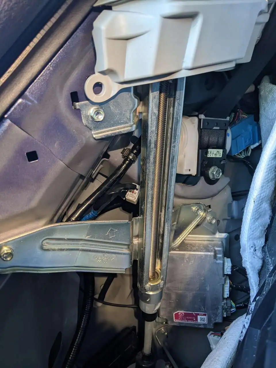

I might not be a mechanic but I have a suspicion the arm cylinder thing wasn't supposed to be filled with insulation like I found this morning

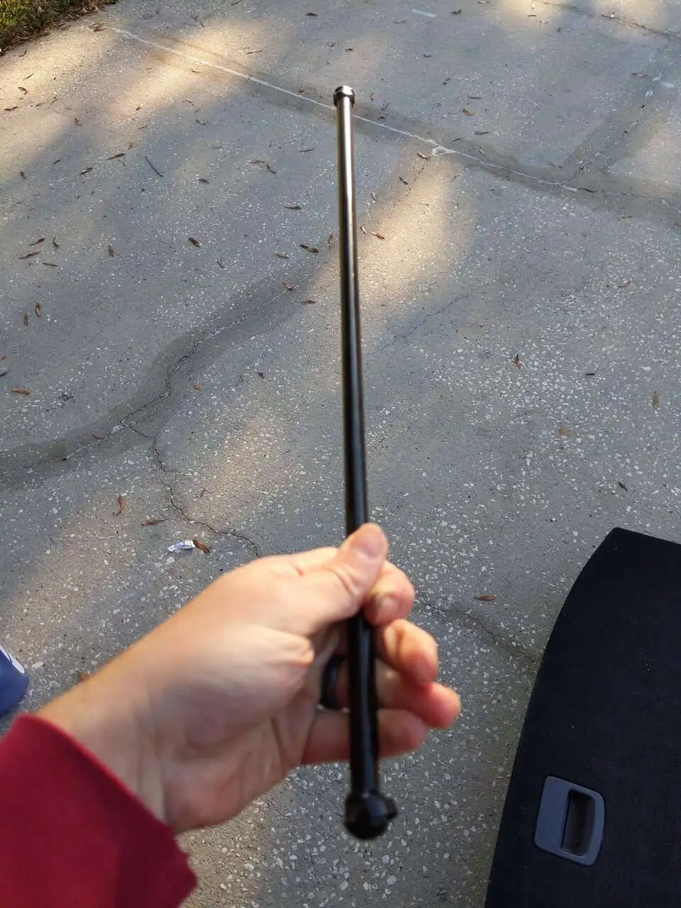

Did find the long lost arm though!
Trying to clean it all out now to see what happens but at least we know what caused it to burn out. The side panel insulation is a mess so I am taking it all out after I clean the motor.

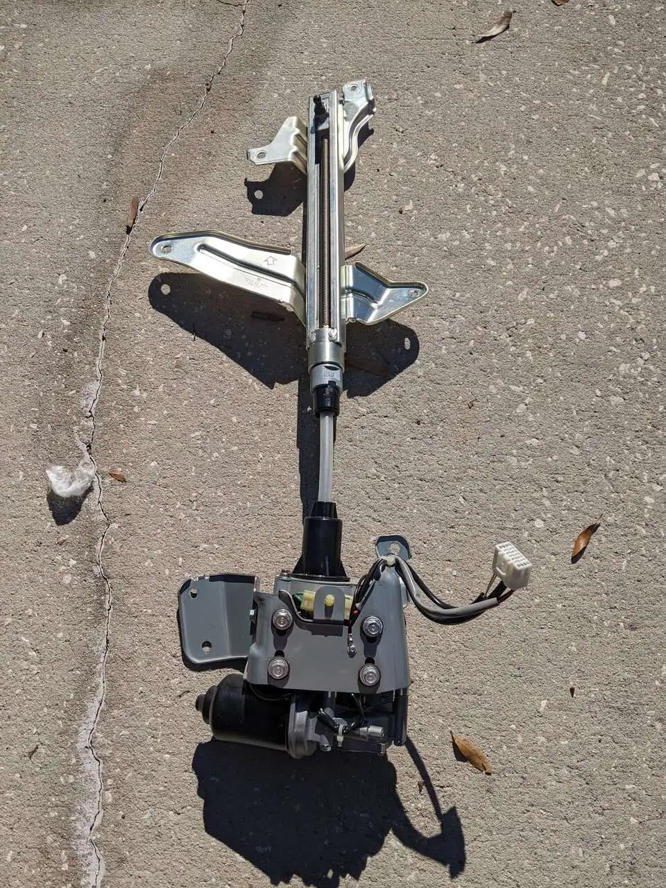

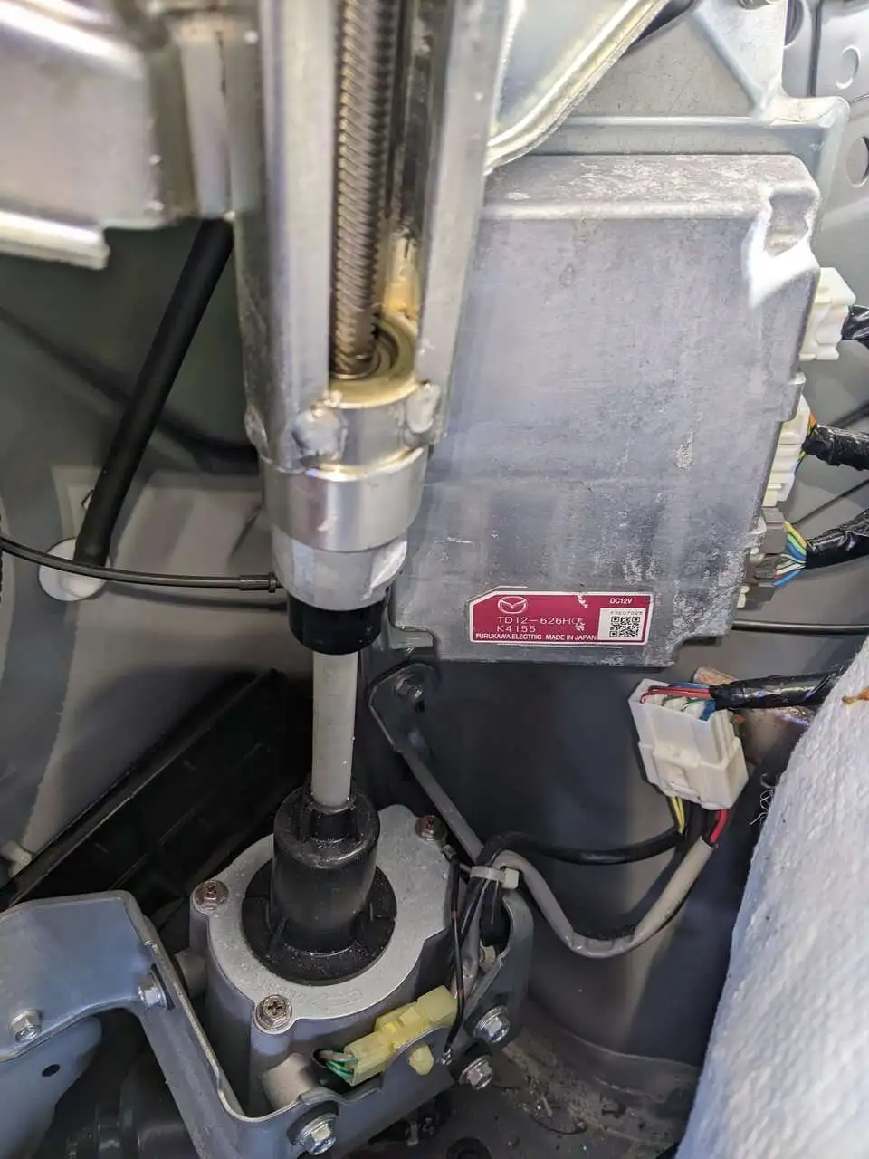

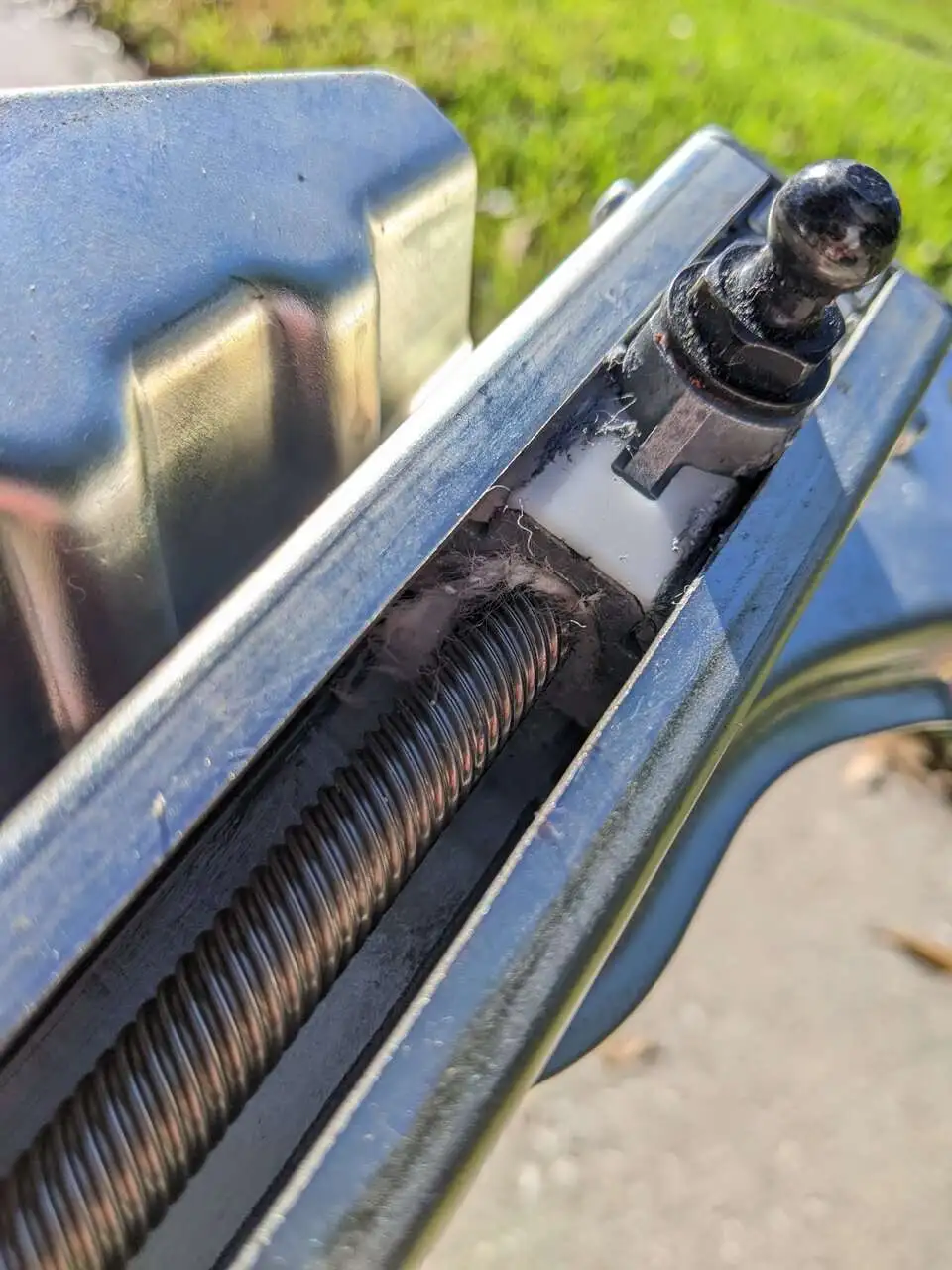

It would appear from that last pic the the motor is at the bottom and it turns that shaft (screw) to move the carrier up and down. Given that you may have to replace it there's no harm in removing the unit and attempting to separate the motor from the shaft. Once that's done you can verify that the shaft and the carrier are moving freely. After that it's a matter of verifying whether the motor has the 'juice' to do it's job.

In the mean time I performed some surgery.
Still not sure how to manually try anything. Since it's going to be a while before I can get a replacement I figure, as suggested, I can muck around with this one to see if anything can happen. Anyone have any suggestions on how to separate it now that it's out? How do I pull it apart or try to screw the thing down by hand?
To an earlier response, I mean Ocala is doable for me, the distance is fine.
Well how about this! I unscrewed stuff as suggested and can manually pull the screw down!!!
Let me hook it back up inside the car and let's see what it does.

After doing what I did in the video above I put it back into the car and attached the power. The motor moved up. Pushed it again and the motor moved down but then beeped a couple of times and moved back up. This reminded me of when you would get something caught in the lock when it tried to close and it emergency opens again. Put in a few bolts to hold it in place and put the rear trim on. Pushed the button and it didnt move.
Potential disaster!
Closed it down with my hand and then opened it again manually. Pushed the button again and this time gave it a little nudge and it started to close. Amazing. Took a few tries and it eventually evened itself out and closed fully and latched. I was shocked. Pushed the button again and it opened.
After yelling out in joy I put all the other bolts in and tightened everything up. Put all the bits and pieces of side panels and everything back in and tested it again, I used the keyfob, liftgate button, and the button up by the steering wheel. Everything functions.
The design of this model with the insulation just being out in the open on the other side of the panel and then having the screw shaft of the mechanism out in the open seems like a bad idea, well not even seems, it is a bad idea because of what happened here.

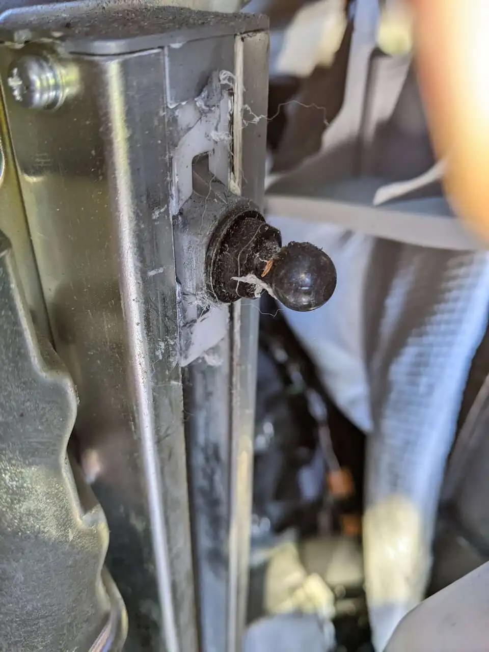

2) The control arm which has been lost for years until today, one side of it is missing the little clip thing that secures it in place:
IgavoSe5NITNF4YGJkwavJbOW5G9eIgPWs9rqUlx_XEHRoTc-zX1JT5u3T56VhikBbaXQ435ozlPfq92p78u2EGSSfL28l2MJNyFkiiqL3NKDHXMPYEyC6Mwdz69-LPnz1w8m2-QNXZMY4TCeVUE0VqOVVIOLXpKbjtWr5Nqzh_6WBU70rVwPUXXQ75wFa3K_UAxpugoNgpIwJxnWGQ4TVINFSZYHKvNb-B8i8dIqvEmjQ6F6mNYssV7EtHBnw5iM0ibqUx1DSYjijF-z0ImDepgGMPF9XSv3zL_pP6ePDlDUS6McgoEst32QLd7H7FX7g-Zp3aS-J2mFQzTtMu8O_2m-cH_fR919UD7JF13w4h28cPyfzYaOpiSfvpBHB-N8TQu7ae-pBtyZs8EUKyjiPURM5WO_x1QmS_XskLBXVRIukZTlp96JbKAl2N8u5LzxtaADChJd9mbjwjgN3knMSku2Tvj7MLJ_hWrUhAimat7RzZcGlX07MMRx58RtqvLplZdW-KmEZvzxmsFQdG62p2yjsQG6i1wtkuoB806xUxTSf8m7x2HDUhBeEg29Yec208YP4ukdVXoNDlHm-M1Gqq_AcuVk3_s9ryJ5k8UpyHY8celSviHN1p5rnqjovGi8C0SYvJXuvsgRZ7boz-8fVcYlL18pnHthLaghnD9CHumU2V3qa95KrgrmbmxleAu7X7yre2z4V3VTPkVvOQS7ot_gJunxY1x234zK87mQie3h9N-raWzchenvqqV8cUY5xvagZo___HxsZneJri_pbM4n_oyNJtZdtuRAdHIS2bxMbjle6agXCZZXGz0Y5pACtkofjsS_TYM0T8GYEuEjX5MC8Z5pbTJQoVPh4G0YlFqc9m0d-HvTQtD5lKVoF9pGH7uzDhquLzqXJEUYtvMFftcsidmwJuLDrh1WpgE_0Bggg=w911-h1215-no
This part.
On the other side it is missing:
nPav92DPhktLG_VcXYRXkQ1qy_KSLJStF3f7iAjj9_aTk2uCgOhDnyg0PsLfbyhIkb0wxE9WMyHWk8XE8DmcU4Jjs0r0KdxxUQWXWFQE_XCgkUzw1OzLYKW5n7Im3P9OFj6myeF7XO5lBA6pkE54zuo3s4SfpyWyoT8ZA_21zV5YGqe_yj_UcYddAC_684S0BD8mscbCBl7008p67M1zHV9zqkwR8rAW-I1xhK8NLv1XzJTaWR8IAOTPjJRYzW3djRvAPLneVea3sblkXFN2IfBgK8fneUqVZv2582tCVm5wpBCyM-uHAJTh7ZlrgzvaDLJYE-AhU6X0y6UC55qApc6QWBQriU2Ly2KUSOHjaw8I02vibo07ACjyn4EfBLem_3dx7IWQCNtccW-thpmZat7ZpxdgMnIwFiBuiDXulNVj3Yiyb6jQSU3xT5x3LG0l8qHADoroAc5nLAYsWJkwdd2AKgrdm038LyRCdWrj4_mCbPyUbGABbv40-9jxNTcQAqA90s2mT6iFfhRz2cAq2o8qsBDDbYFbP_xqLjgHa0zIvek-lWqE0Md_NyZb-t6YnEMlXIW5JXCIOSwcf1zFWJg7hmApVZftvcuIfG0WZqJLSpineLguSUAVGKMKdYuzcOoh1sSWhMVS3EvmgEJyBt9W2YUxCkPrjoQ9f2stBQtG0eTSLsfgzK-NvvUo-1YyvmaOi3RLhsGI4UROFnoT9yoxQPcnPBufMynSXyeQ5zp4qrPsrypgu1qTNt4YA8HFJvjSNi7J5dkKagkqGt5L8ZaXXwbplTxfRrB1VJF2MCOCPbyGHgJjyB8Ce7s33wIlT5iKMoZj9ZEWoiFZ3ZlxaXvYmvEWwRO_o4VhuWd0FUF8V7V8_FklglWX41s8GUjch6zucfn-RlJKySdtEU13h8We2Mf2O_ySS3Nb04veU_xKNg=w911-h1215-no
I put the side with the clip in the side panel so the less secure one is up on the lift gate now so at least I can access it if something happens. Can I get just this clip somewhere?

Yes...use the one(lock clip) from the old struts once you replace them. They should be similar the control rod clip. If not, just buy a used rod(with clip) at the junkyard.

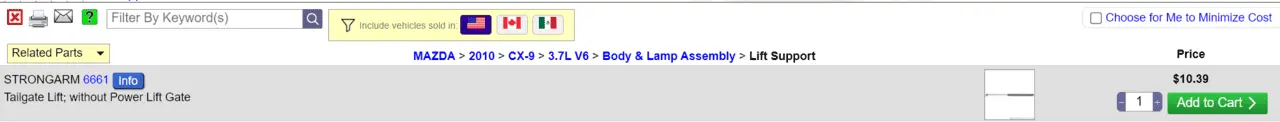

Those are for the regular gate, not power gate. I got mine from Mazda because nobody lists them for the power gate. Not sure of the difference.
Odd. The ones I have now worked fine for the past two years with no power liftgate so they were almost a manual one themselves.
Do you know what part number yours is?
