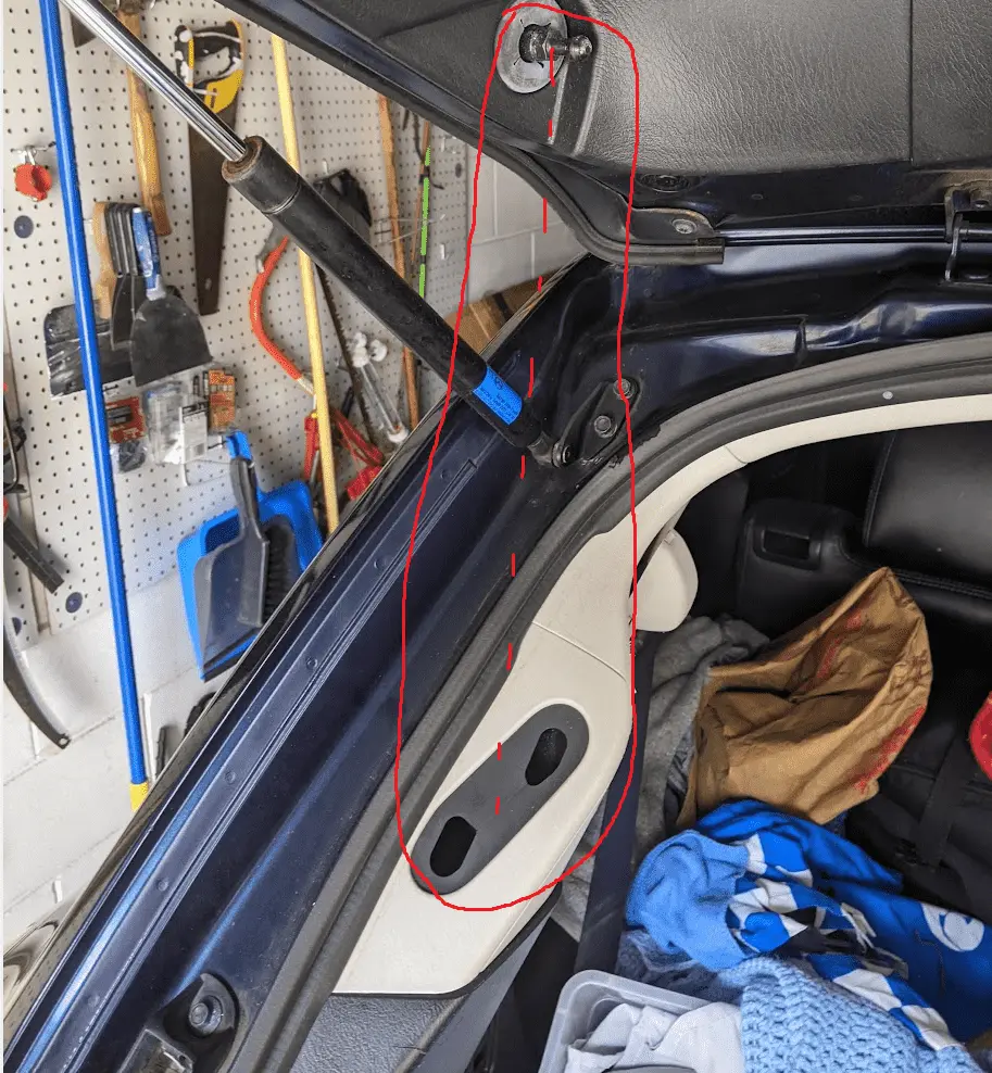

Do these struts refer to the ones that help the hatchback go up and down or is this the power arm?

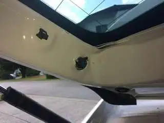

The part that broke is the one that would have been here in this picture:
That one locked up when all of this happened and I had to detach it. The motor wasn't moving or something else went wrong, all I know is that when the button was pushed nothing would move and I couldn't close the hatchback trunk at all, nothing would move. Unbolted it, it fell into the hole there never to be seen again. We are able to manually open and close the back there with no problems now that it is off.
I wonder if @Bronco Boy has any insight into this. He had a similar issue with the same part, but it was the balljoint at the top of your picture that failed on his car. I don't know if he had to replace the part that would be circled in red, but before buying any parts I would pull apart the interior panel where the two holes are and see if there are any repairs to be made on that end. The arm itself may be fine, but the attachment point could have somehow failed.

Oh and the struts are the black gas tubes with blue sticker on them. There should be two.
Struts = black gas tubes with blue sticker. One on each side.
On mine, the upper ballmount tore out.
OP's strut must have seized and broke off on the bottom. Pull the interior panel and report back.

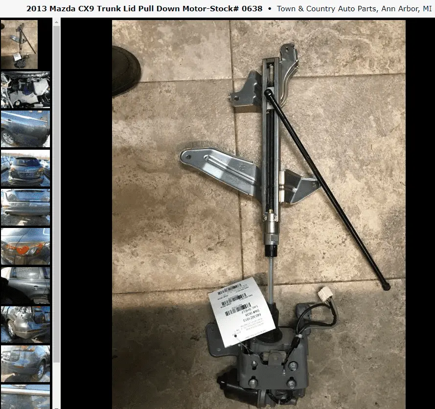

Doesn't sound like it's staying on long enough. Here's a pic of motor for your reference. This one's in Michigan if it's close to you. The end of the black rod snaps onto the top of the hatch. Salvage motors are between $150 and $275. Should work fine for you for a few years more. Check prices on new motors..if not too much price difference, then haggle with the junkyard or just buy it new. And get the most recent motor from the newest car that still has similar parts. I've used plenty of junkyard parts including motorized and electronics. They work fine for the remaining time you may keep the vehicle.
EDIT: also as the motor turns, it turns the threads which pulls the hatch down or pushed it up. As you can see how fragile the parts are ,this is why you need good struts. Most likely your struts got old and the motor couldn't handle the weight, thus broke. Or something froze along the threads. Either way, replacing the motor and struts should solve the problem. The struts will prevent the motor from doing the heavy lifting.

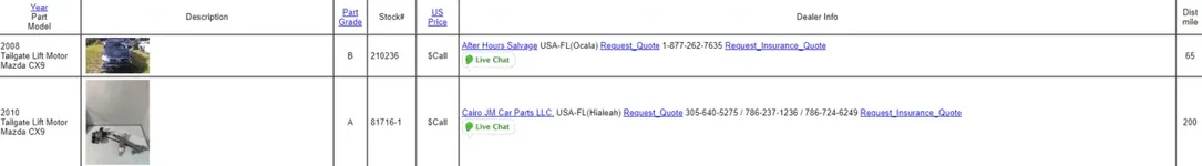

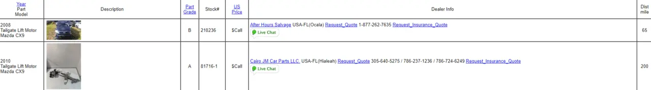

Is this the right part?
Looks like a bunch of them on eBay for around the $200 mark...
If you buy from junkyard, you usually get a 30 day return policy on parts, and they will verify proper car years for fitment.
Plus you can look at it before you buy and also get the black arm with it as well. Didn't you break the arm? Plus you can haggle price. Call a junkyard up tell them what you need liftgate motor plus black arm plus wiring harness and ask if they have it and how much and then see if they'll take 20 % less.

What state you in?
What years is your CX9?
here ya go at Ocala. call and verify.
drivers side frontal impact. no damage to rear/hatch.
since its a 2008, try to haggle price if over $100. if they say $60 just grab it.
or buy the newer used one online for $200 if you can get like a more recent one(2012, 2013, 2015, etc)
