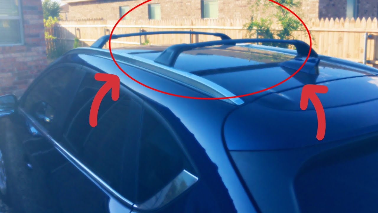

I had the roof rails installed a while back and on a couple of occaisions have used some generic cross bars to support long boards but I think I need Mazda's cross bars. First of all as the rails are flush with the roof the generic bars can't grip around them so not really solidly connected. The other thing I realized is they're not high enough that sheet material such as plywood will clear the shark fin antenna. I haven't seen Mazda's bars in person yet but I assume they're high enough that loads clear the antenna. They look like they should be easy to install and uninstall if one doesn't want to drive around with them all the time. Can anybody confirm this? Thanks.

Have done this to my '17 and recently my '22.
1. put on rails. Don't fully tighten the bolts. Leave a bit play to them.
2. put on the cross bars.
3. fully tighten the bolts on the rails.
4. fully tighten the bolts on the cross bars.
5. snap on the tiny plastic covers.
Point is: if you fully tighten the rails first, you might have a hard time pushing in crossbars between the rails. It happened to my '22.
I had to loosen the bolts on rails to snap on the crossbars.
Maybe yours will fit nicely.
These things are not made with precision...
Good luck.

Phew! Well I wouldn't call it easy because of the location of the screws but it's done. And they're certainly not something I'm going to remove periodically.
