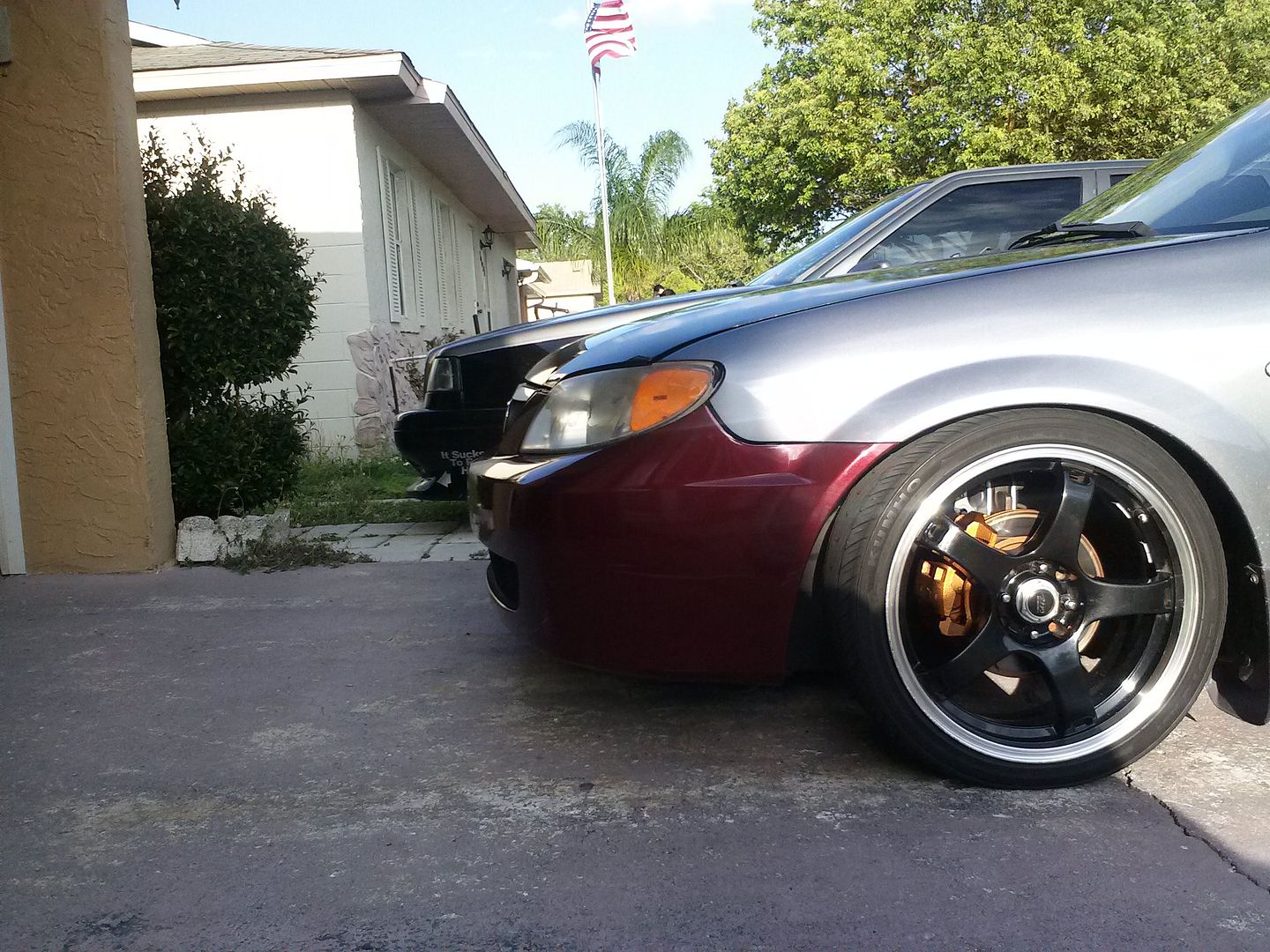

02 protg sedan was on 17 x 7.5 wheels with a 40et. Lowered... now they rub like a mad man. not looking to roll fenders so I went and Picked up some 15" wheels.
Specs are 15x6 et 46. (GSR Fat Fives, which I polished up)
what I'm looking for is what tire size to run with them????
Car is on Sensen struts and ebay drop springs....
that's how it sits with no one in it. add my 350lbs ass and .............you get the idea.
NOW... the kicker is I would like to go with As wide a tire as I can go. I like Bubble in my side walls.
