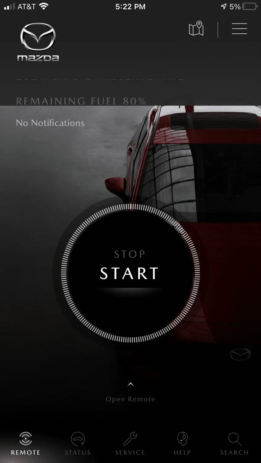

Select Status. About halfway down the screen it says "Vehicle Status" with an arrow pointing up. Press the arrow and the screen expands upwards. Now you can see an image of the car, and there should be a tire pressure displayed for each corner. You may need to drag the top of the screen down to refresh.

With the MyMazda iPhone app, v.7.0.0, on the Home Screen, it shows "2020 Mazda CX-5". That's all. At the bottom of the screen I can select the pages "Guides", "Service" and "Support".
At the top of the screen is the "droplet" for showing the nearest dealer and the "hamburger (three horizontal lines)" which brings up the page that show "Inbox", "Profile", "MyMazda", "Roadside Assistance", "Support" and "Settings".
No "Select Status". What am I missing?
I guess it must have something to do with you having a 2020, but the Connected Services manual suggests that you should have the Status icon. Here is my home screen, which includes remote start (not sure 2020 has that). All I can suggest is downloading the manual and seeing if you can figure out what you are entitled to with the 2020: https://www.mazdausa.com/owners/how-to-use-my-mazda
The other possibility is that you don't have the monthly service. The 2021s come with three years free. If the 2020s didn't come with that, then you would have to subscribe and pay the monthly fee (I think around $10) to get the full app functionality.
Yup, I have only four icons at the bottom of the screen for me "home", "guides", "service" and "support. Maybe the 2020 Signature can't pass the info on to the app, so the app doesn't show those options.
I've only owned the car about a month, but haven't read anything about a subscription nor has the app prompted me to upgrade.
