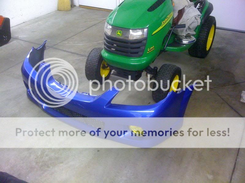

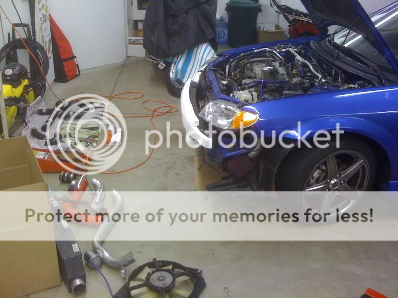

Well I got all the pipes and s*** on and placed the core where it will go, but the bumper won't fit on. My fog lights will probably have to come out as well. My dad is totally against doing anything to the bumper, but I don't think I can drag myself to undo what I've spent the entire weekend doing.
hmmm... i havent found many IC kits that require removing the fogs or doing more than trimming very small portions off the bumper tabs. look up a bunch of install threads for FMICs as a starting point, lots of people run into problems (like this one) and maybe they posted a solution.
