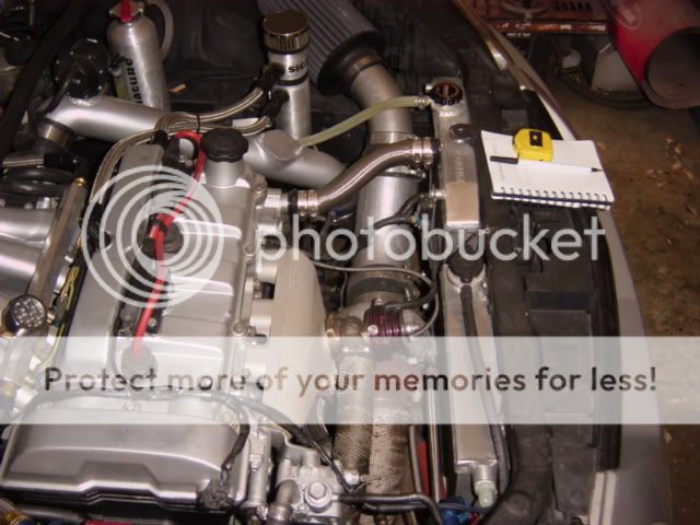

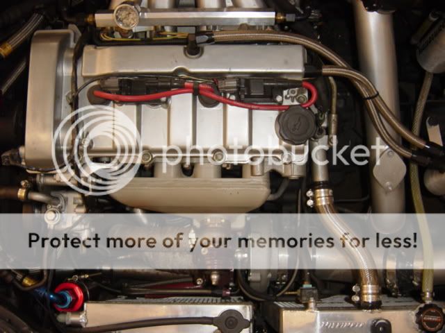

pictures i have to follow when i install mine, same catch can.
i just capped the 2 vacuum lines that used to connect to the pcv right at the intake manifold, as i don't think they are needed once you replace the valve with the catch can.
Ok why is the radiator split in two? Some kind of dual setup I am not aware of? And what IM is on there? The few inches that are in the picture look awesome, can you point me to some more pics?
top secret bro. sorry lol (j/k) wrong place for this. shoot me a PM so we can keep his thread clean. thanks.
