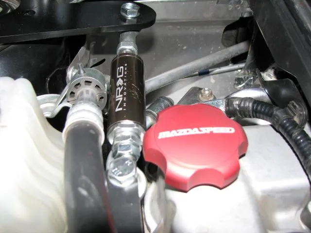

Image from MS3 how-to thread
I have the MSM/PG and nothing rubs or touches anything, when it's installed like I illustrate. Clearance is fine for all lines and hoses and the oil fill cap as well. Either way, I think we're all well served. Honestly, I don't understand why it should be installed the way the previous pic illustrates. As noted, it just creates clearance issues.
