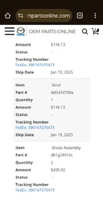

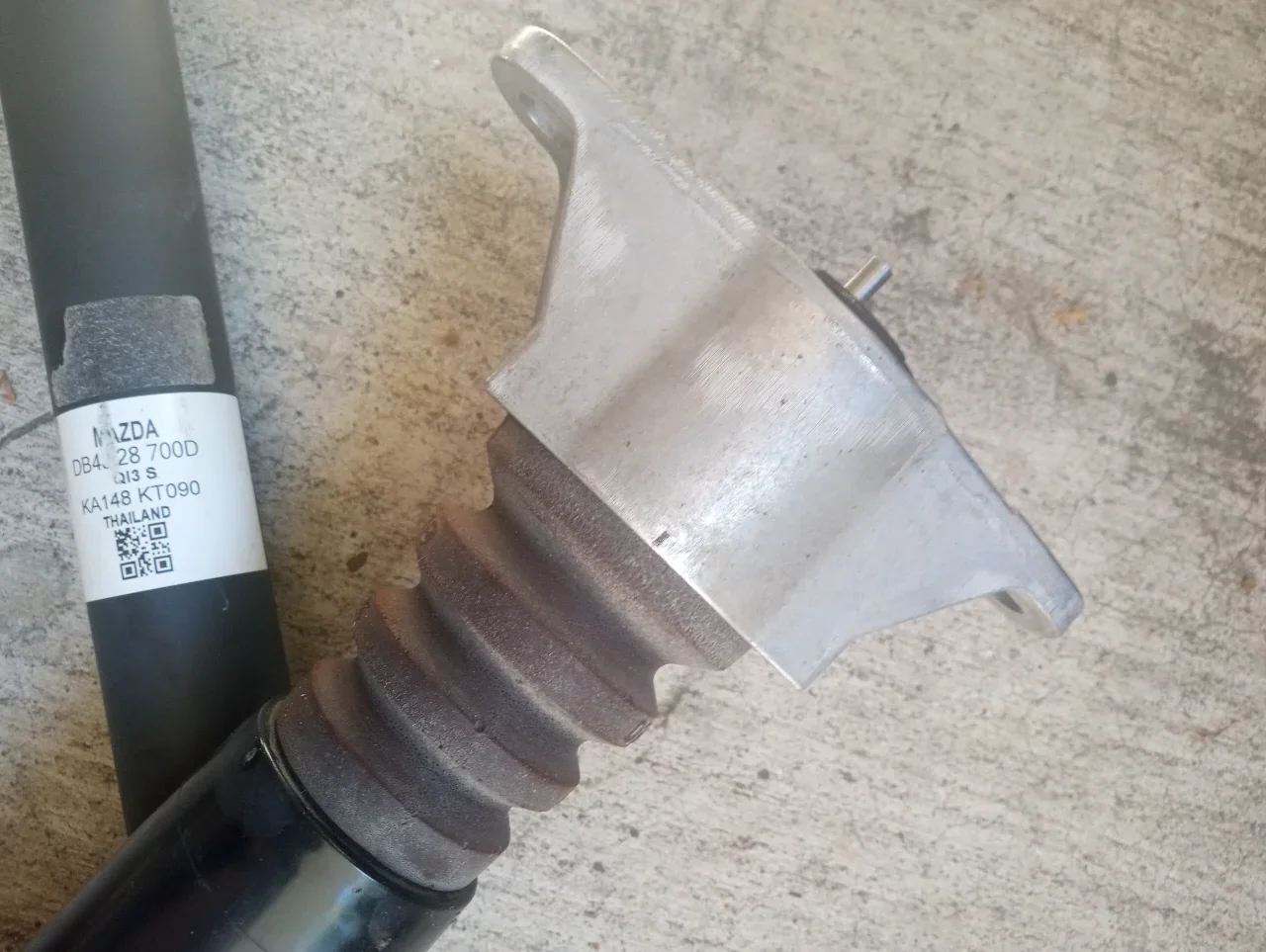

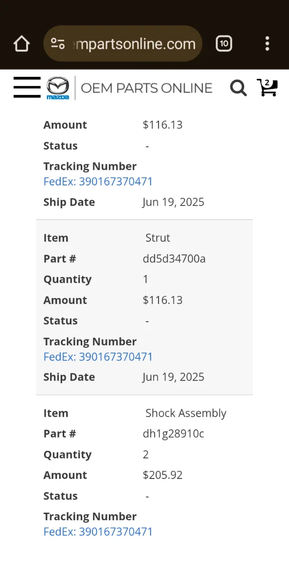

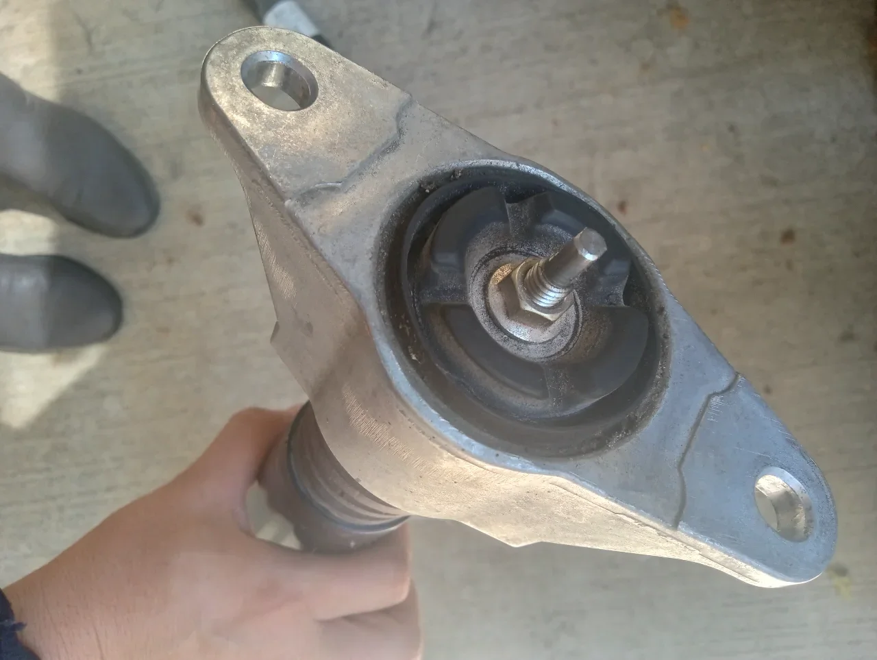

The rear shocks are easier to replace than the front struts. It took me two hours to DIY (first-time working on shocks). I rented a lift for 4 hours and added 1.5 hours of tech help. In that session I also did one drain/fill of the transmission fluid. It was around $300 I recall.

After I started to notice this June that the ride was very bouncy, I went to a reputable local indie shop for a general inspection. I was told that the struts/shocks are worn and the passenger side rear was leaking. I had some doubts because of other aspects of the inspection so I chose to DIY instead. The rear shocks didn't show any sign of leaks when I checked before the replacement. They came off with no visible leaks. I fully support replacing all 4 at 153K miles to restore to fresh ride quality. I guess the shop reported a leak as a boost for me to do this right away.
This CX-3 had never been serviced by a dealership because obviously I have trust issues. 😁
