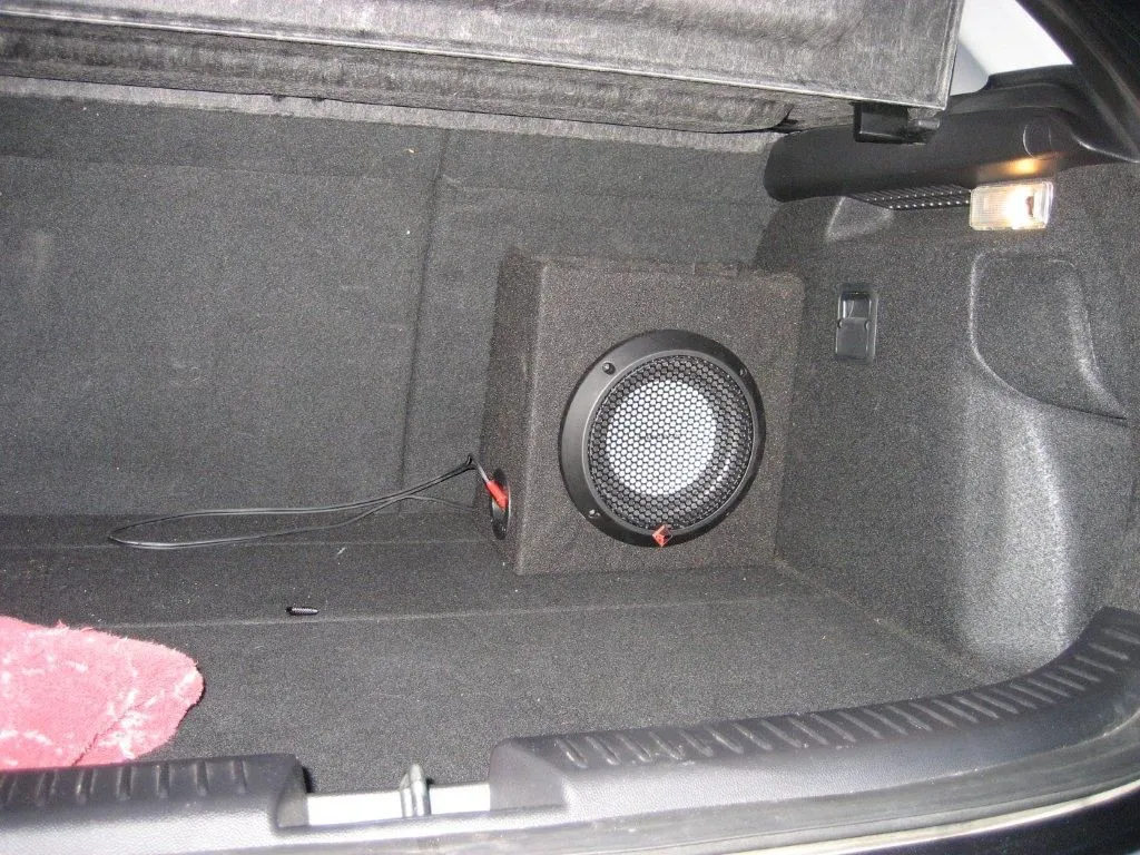

You have any photos of your hatch 8"?
Box is about .25 cu ft, trapezoid shape so it fits flush against the back of the seats.

How do you have yours mounted so it doesn't move?

Thanks ejh, thought you had them built into the hatch side panels or the floor. I cant use a box since my car always gets designated as "the truck" whenever we need to move things. I guess the right side compartment is my only real solution (I have the rubber cargo mat so I would think a floor mounted speaker with rubber on top would be useless?)

Wide strips of velcro on the bottom of the box. It doesn't move at all. I also put a small 'L' bracket on the back of the box that lines up with the tie down on the back of the seat. I can attach sometime more substantial there to secure it, but haven't had the need.
The box is very small and since its just velcro'd down, I can move it easy when I want to fill up the trunk. I carry a lot of stuff and still don't end up moving it out much. The box is pretty small, like 11x10x7 overall (although it has a slanted back so the bottom is more like 9 deep and the top is like 6 deep).
I have never been into subs in cars until I started listening to 5.1 home theatre. Now I really like what it adds to the bottom end. I can't wake the neighbors, but its not about that.
