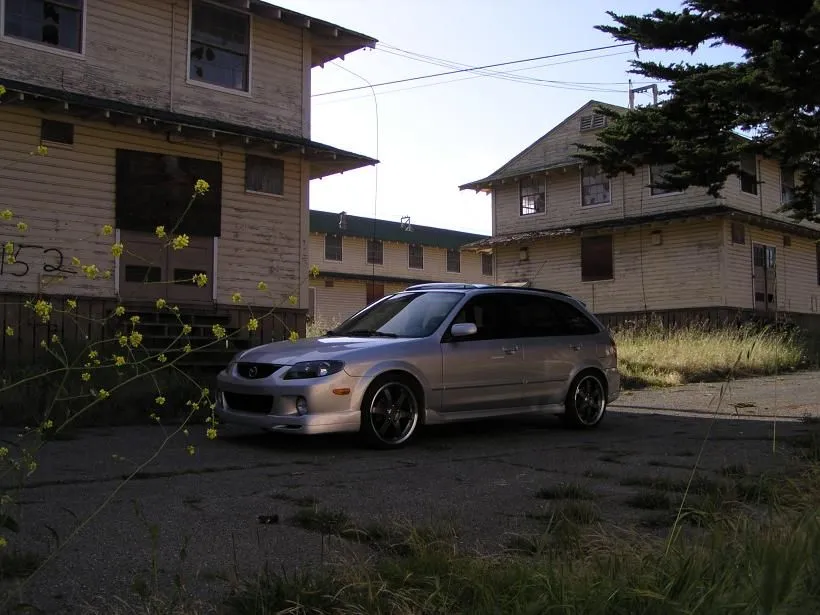

photo ***** opportunity: here's my old P5 on 18x7.5s.

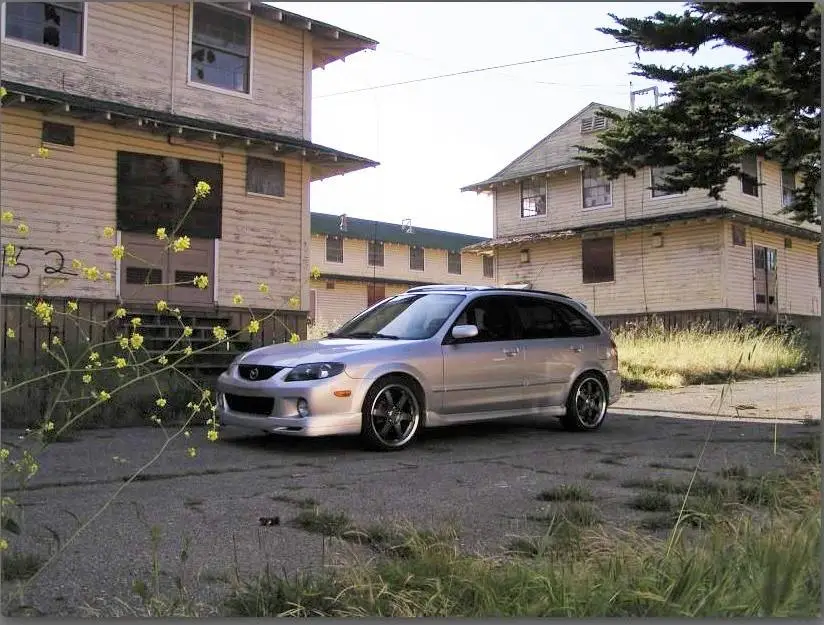

Man, those wheels look nice but the photo is pretty dark in the shade. Wish I could see it better. My P5 has the stock wheels, and they're OK; but they're getting a little long in the tooth, if you know what I mean. My car is the "horizon yellow" color. I'll check out those Enkei's.
You're right, that's a pretty bad pic. Here's a clearer one that still kinda sucks. lol.
Volk LE37T
114.3, 18x7.5 +48 offset, 215/40 tires.
Volk LE37T

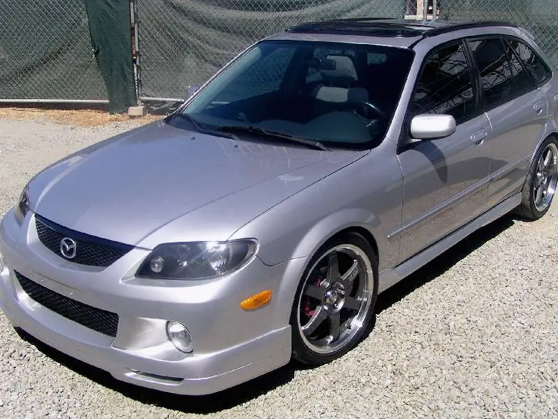

Here's a cleaner photo of the original photo Natey posted.
