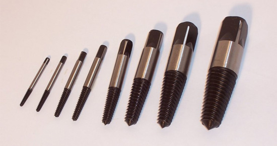

I used a hammer drill with a metal drill bit (as in, drill bit made for metal purposes vs. wood) It seemed to help break it loose.
Hahaha! I fell in love with these things first time I did a broken exhaust manifold stud. I use em on everything now.
