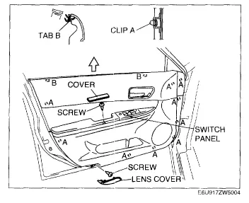

FRONT DOOR TRIM REMOVAL/INSTALLATION
Driver's Side
Disconnect the negative battery cable.
Open the cap using a small screwdriver, then remove the screw.
Remove the inner handle cover.
Disconnect the door lock switch connector.
Remove the inner garnish
Remove the cover, then remove screw A.
Remove the lens cover, then remove screw.
Disengage clips A from the front door using a fastener remover.
Pull the front door trim upward, then disengage tabs B from the front door.
Disconnect the power door mirror switch connector and the power window main switch connector.
Remove the courtesy light.
Remove the front door trim.
Remove the switch panel from the front door trim.
Install in the reverse order of removal.

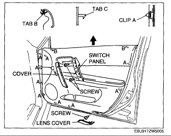

Passenger's Side
Remove the inner garnish.
Disconnect the door lock switch connectors
Disconnect the power window subswitch connector.

I will try and get the pics to work.
ok lets see if this works, hopes this helps
