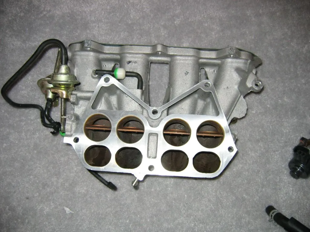

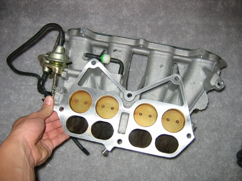

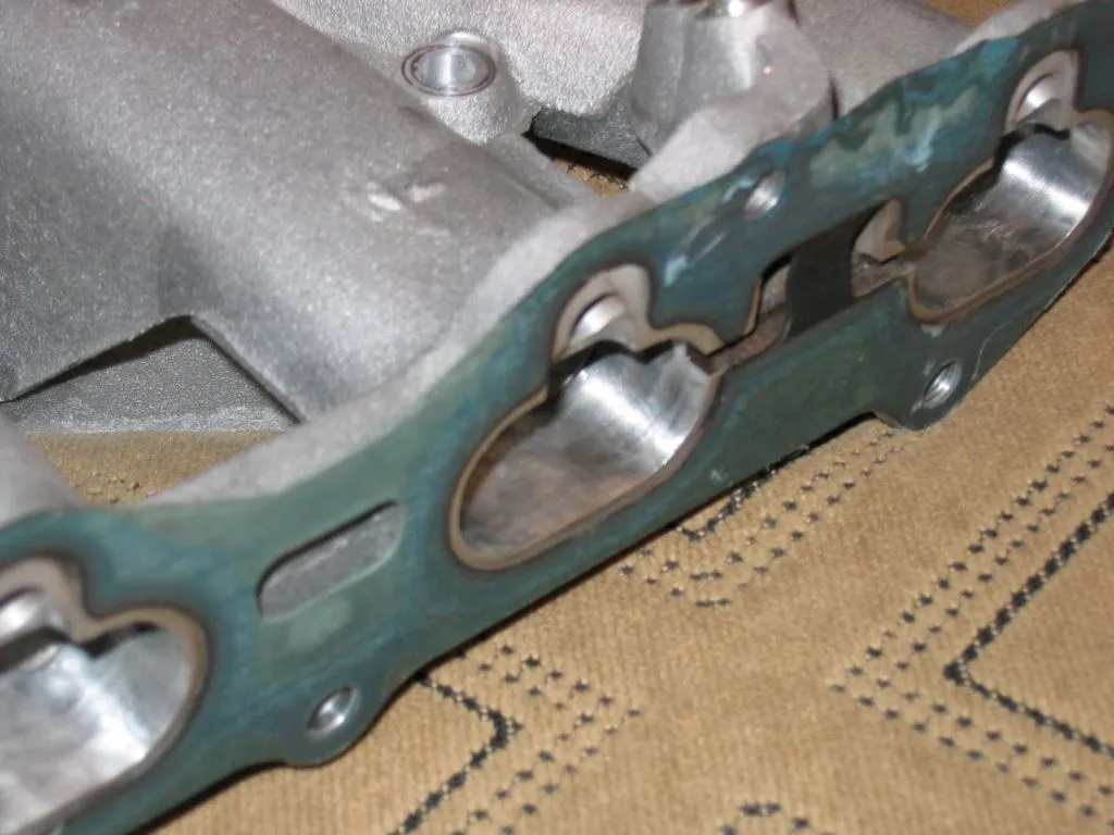

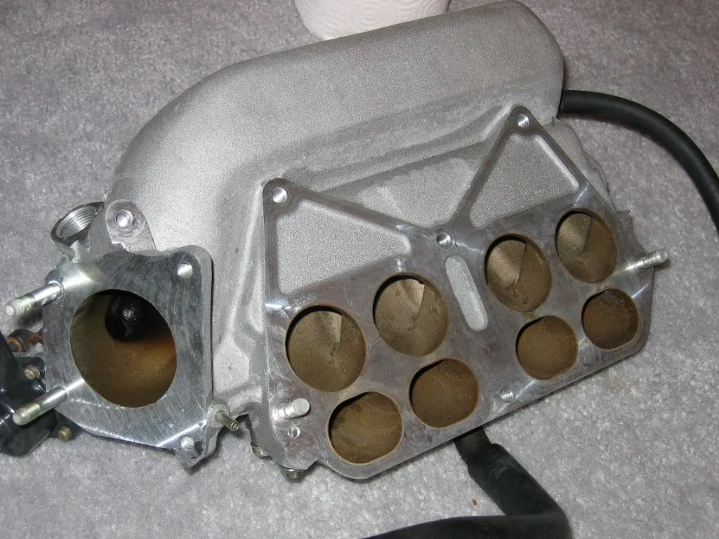

I finally finished porting and polishing my intake manifold and removal of the VTCS system. It will be going back into the car the next day it isn't raining (i hate michigan weather). Here are some tips, in case anyone else wants to attempt this in the future. It is best to only remove the upper half of the manifold. This allows you leave the EGR tube and throttle body in place. You also do not have to disconnect it from the lower support, which means that you will never have to jack the car off the ground. I also reccomend taking off the hood to give yourself the most room to work, since you are working in the back of the engine bay. When porting and polishing, shove some cloth or paper towel just past the area where you are doing your grinding and sanding, that way metal shavings won't fall back into the runners. As far as Dremel bits are concerned, I found it best to use sanding drums to take the most material off, then use the steel brush bit to make the surface smooth. It is nice to have a vacuum on hand to suck up the dust that will build up, especially when sanding down the mounds of quik-steel used to fill the holes left by the VTCS rod.

unless I'm mistaken, you just removed the VICS not the VTCS. The VICS opens at xxxx rpm to change the runner length and give more hp at the upper end. The VTCS is used to help with cold start-ups and emissions. It is located at the end of the intake manifold, right before the intake ports on the head.
**edit...I'm an idiot and looked at the pictures wrong. I read that you were only taking part of the intake manifold off, and so I thought I was only looking at one part of the manifold. My fault.

Protege5 Driver said:
are you going to leave the flappers operating normail or keep them closed al the time
one set (the vics) you leave normal and the vtcs get yanked entirely. so essentially they're open all the time. only without the extra crap in the way to obstruct airflow.

by removing the VTCS you allow better air flow into the intake side of the head.
By polishing the exhaust ports, you allow the air flow quicker and smoother out of the head. This keeps the velocity of the air high (fast), which helps maintain performance/effciencey of the engine at high revs.
