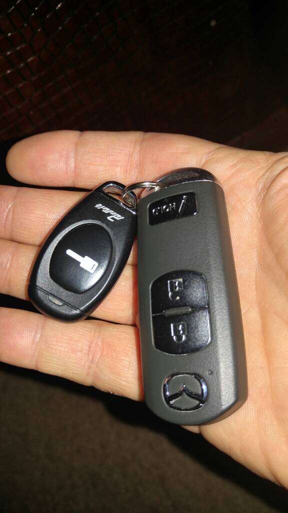

I have a 2016.5 with the OEM factory remote start.
If I start the car remotely (with the remote start fob) with the doors locked, they remain locked. I am able to unlock them with the button on the exterior door handle when I walk up to the car. No need to use the key in the key fob.

Just picked up my 2014 Touring from Best Buy. They put the Compustar CS-4102 in it. Seems to work well. As with the others, the car shuts off when the door is opened, and the parking lights do not flash when starting the car. I also have to use the Compustar fob for unlocking the doors after it has been remotely started. I was prepared for this and have no issues with it. Starting a warm car is way better than starting a cold car! The fob is slightly smaller than the OEM standard fob.
I paid $259 including installation. You get 2 remote fobs. The primary is 2-way communications, and the backup is 1-way.

You do not sacrifice a Mazda remote fob with this remote starter. I have the factory alarm on the car. When it's installed, you get a Compustart starter fob in addition to your Mazda fob - they both are on my key ring. IF you remote start the car with the Compustar fob (and that's the only way to remote start it), then you will need to use the Compustar fob to unlock the doors - the Mazda fob will not unlock the doors if it has been remote started. Once you open any door (or hatch), the engine will stop. Simply get in the car and start it as usual. Granted, it's a little inconvenient to have to restart it, but it's better to restart a warm car than a cold one.
The Best Buy tech told me that all of the cars (Mazda, Lexus, etc...) with push to start that he has installed remote starters in shut off when a door is opened.
The range on the Compustar fob is 3000' ft. I can easily start my car from inside the office. It's a 2-way communication so you know that it has started.
I'm pretty damn happy with it.
