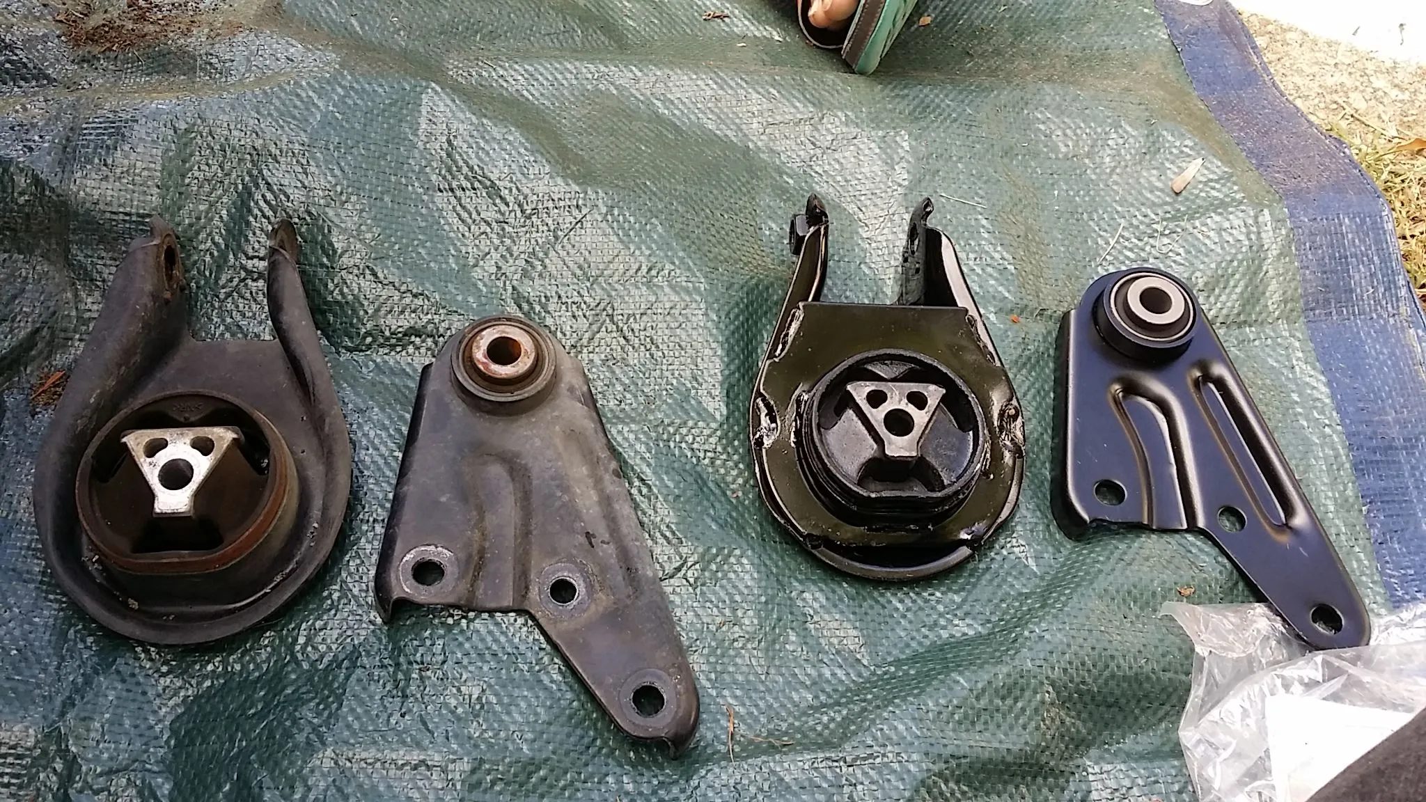

I got lazy and ordered standard parts from Amazon and even though the OE parts didn't LOOK too bad, with 145,xxx on the car, I replaced them all. Pretty straightforward removal and install. If me and my son weren't clowning around and I focused, I could have probably had the job done in about 3 hours by myself (took about 4 hours total). A few things happened that maybe might help someone else.
Bottom Mount: After a couple tries, I found loosely assembling the entire unit and getting it located with the three bolts at the front of the assembly FIRST made it easier to get everything square.
Transmission Mount: Even with the engine braced with a jack underneath, the engine still shifted when I loosened the main bolt. A little extra persuasion with the jack got the bolt relocated with the new mount in place.

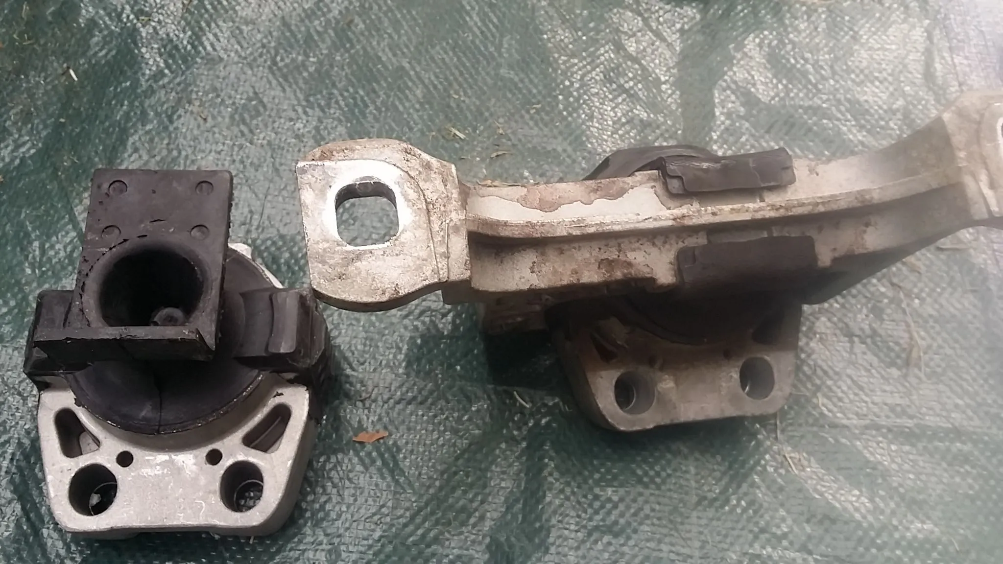

Passenger Side Mount: The replacement part was a LITTLE different from the OE part in that the bottom part of the OE isolator was wrapped around the mount. The replacement part I got was the isolator ONLY. I was able to bend one of the bottom members of the OE isolator to remove it, but I did not have any kind of tool to bend the similar section on the NEW unit (pics below). After looking at how it's installed. I left it as is. I did not have to remove my coolant reservoir to access the bolts.
