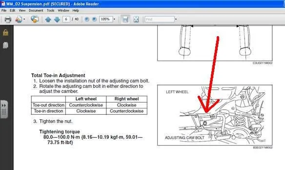

Does the M5 have toe-in /toe-out adjustment on the rear? Anybody have pics? If you have, you can DIY the toe-in by using a fish line from front tire to rear tire, just make sure the fronts are dead straight. then you vcan adjust the toe based on the fish line straightness.
Yes - the rear toe is very easy to adjust. Standing at the back of the car, look underneath towards the front - each tire has an adjustable bolt with graduated marks on the fixed 'washer'.
Once you loosen this nut, the bolt can move. To adjust, I jacked up the car, then lowered one wheel with just slight pressure onto a 2x6 under the wheel (so the car was still mostly supported by the jack). Then if you adjust the toe bolt, you can really see and hear the wheel turning toe in and toe out.
The online manual has all the correct info - that's where I learned. Actually adjusting the toe was pretty dramatic.
Info found on page 2-11-4 of the workers manual PDF available online. Attached is a picture.

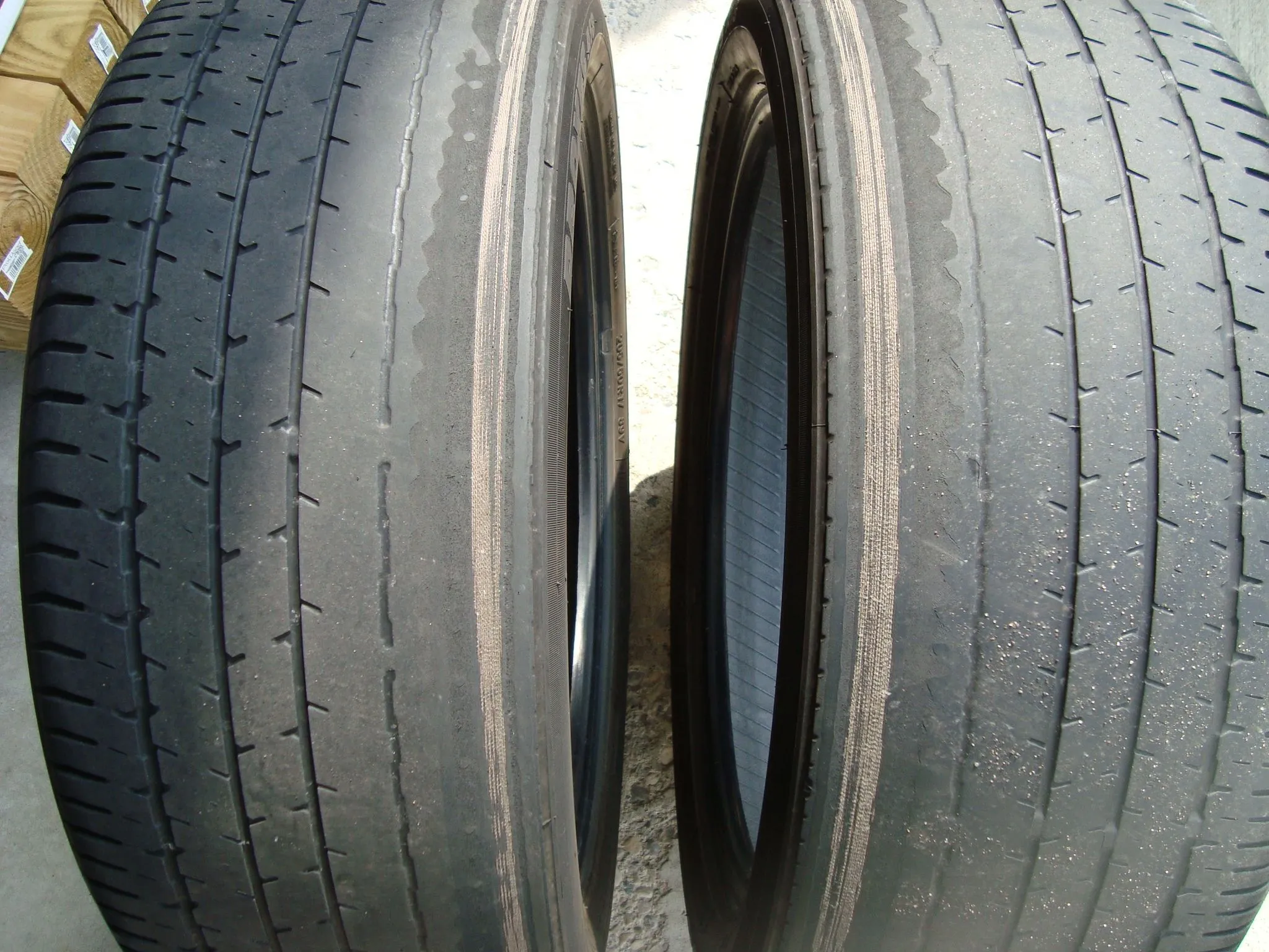

Just got back from my Mazda Dealer and had a brand new set of tires put on along with an alignment. The OEM Toyo's I had only had 14600miles on them and were rotated every 5k miles. As you can see from the pic the rears were worn down to the threads (nailbyt) . The alignment tech called me over while he was doing the alignment and said that the rear toe was way off...the most he had ever seen on a 5 or 3. I talked to him about the camber issues and he said that he recommends putting in SPC adjustable camber arms...which I know a few of you have done. In my case though it was all toe that caused my tire wear...LT was -.40 and RT was -.85. He said they should be around .1. He adjusted them back to spec and then told me that he believes that it was set that way from the factory...he said there was some over spray on the adjustable bolts and the paint had not been broken...he said that I may have a case with Mazda. He said that to give me an idea of how much wear the tires went through, he said that at -.3, it would be like dragging your tires 600 miles sideways! Alignment analysis also attached.

Wow. That' pretty brave driving with inner structure exposed.
Honestly, my wife drives the 5 more than I do. I knew they were worn down, but did not really notice it until I pulled up behind it earlier this week and saw how bad they really were. I was on pins and needles for the last 2 days.
Just got off the phone with MazdaUSA and they are going to reimburse me for the Alignment and send me $75 gift card to be used at Mazda...I can use it towards parts or labor for something.
The rep said that had I bought the tires from the dealer, she could have helped out with the cost as well. I am sure that buying a new set of Toyo's from the dealer...even with MazdaUSA covering part of the cost...would still have been way more than what I paid for 4 Kuhmo ASX's...wishful thinking at least.
So, if your rear tires are getting eaten up, have the rear toe checked. If mine was setup incorrectly from the factory, then there has to be others!!!
