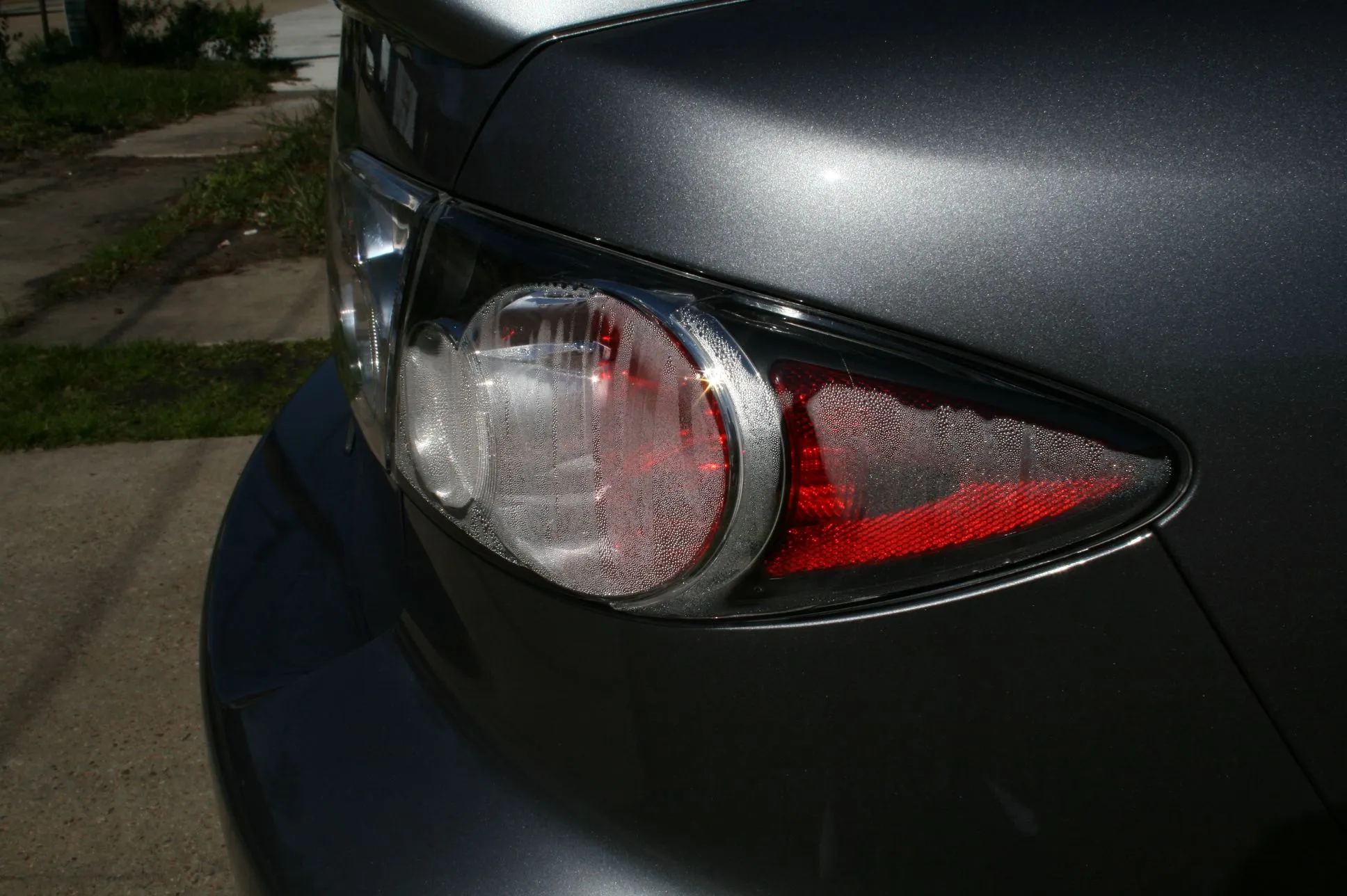

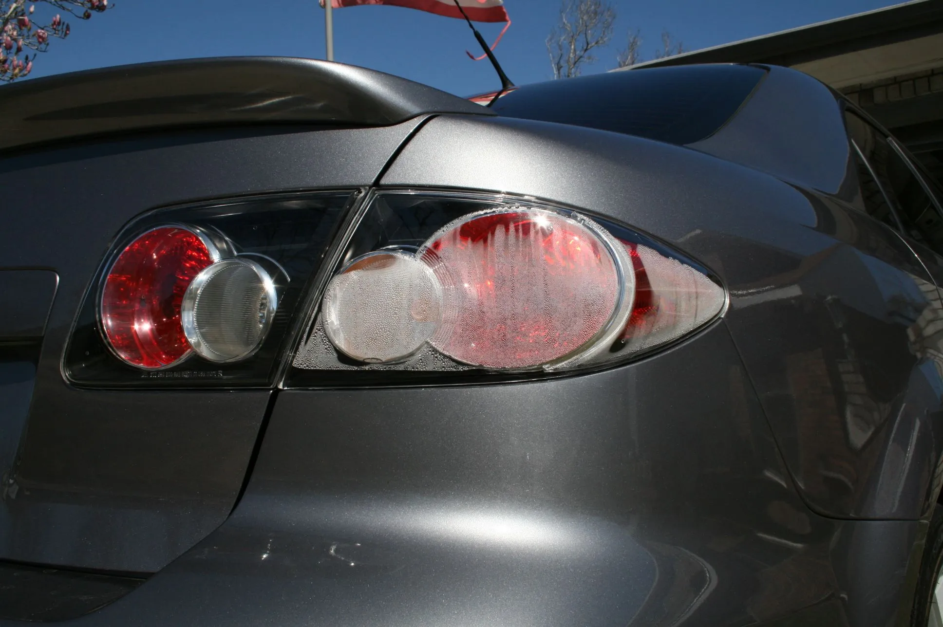

My passenger tail light is leaking through the lens some how. This is my second taillight. The second one started to leak with in a week. Has anyone had this same problem? Thanks
Mine was leaking also but then I find out that my M6 had been in a rear fender bender before I bought it. I just took the lens assembly out, let it dry under the sun or you can use a heater gun. After that I put clear silycone all around it. There was a storm here yesterday as you know and today I checked and it was dry... like new.
Hope it helps
