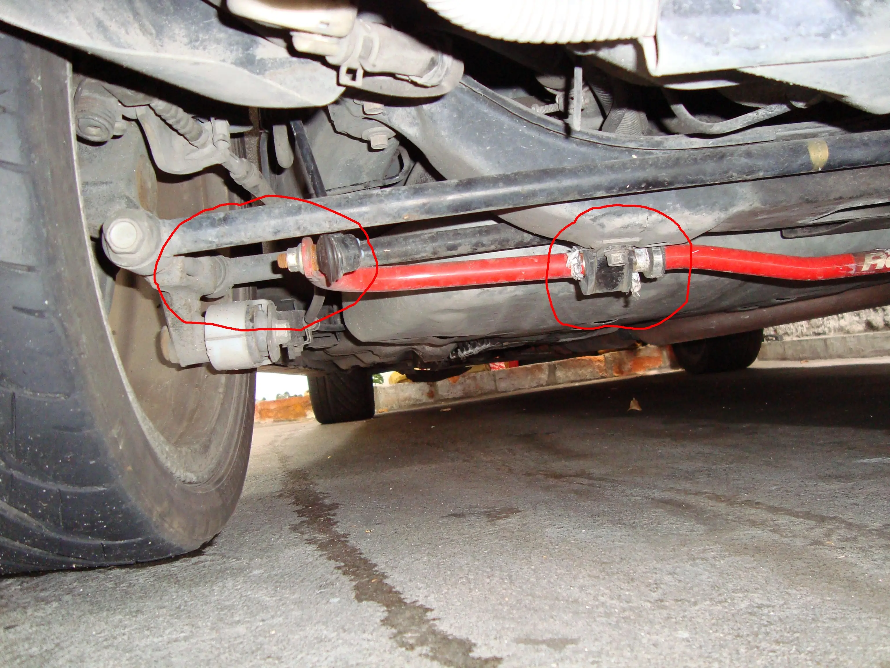

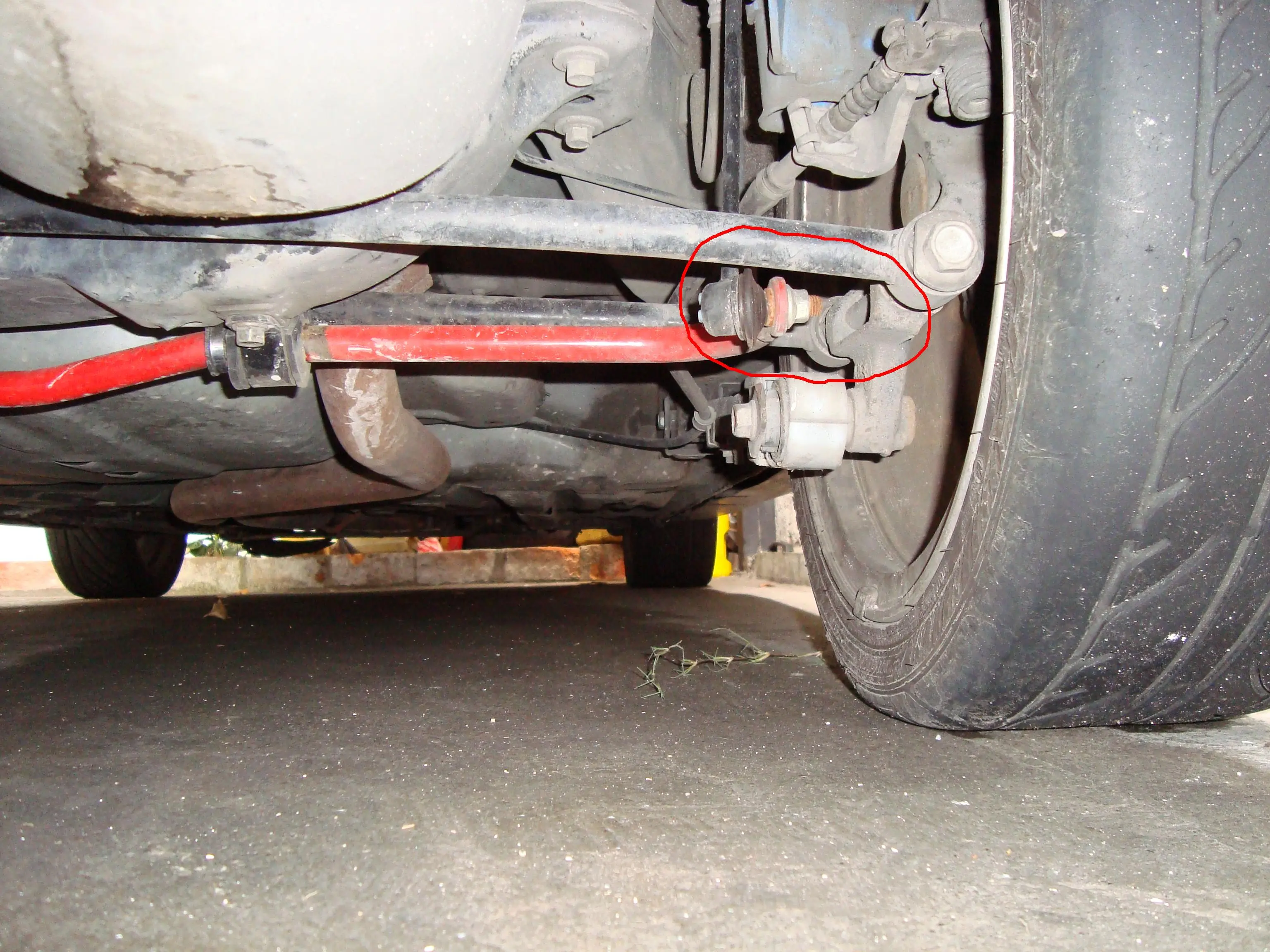

Hello, i have a strange problem with my rear sway bar, as you can see in the first pic. show the right side and can be seen that the end link it's near to the car, and in the second one show the left side and the end link it's far away from the car. The sway bar has moved to the right side i don't know why?? my bushing are new also the end links.
(bang)
seems that when they installed the new bushings they moved the bar a little.. look at the paint missing off the sway bar on the first pic (with the endlink closer to the car). Should be a simple fix really.. slack the bushings and move the bar back to it`s original location.
when the bar was installed it's was in the original location, then with time and driving the car, the bar moves to the right side.
This is the second time that this happen.
