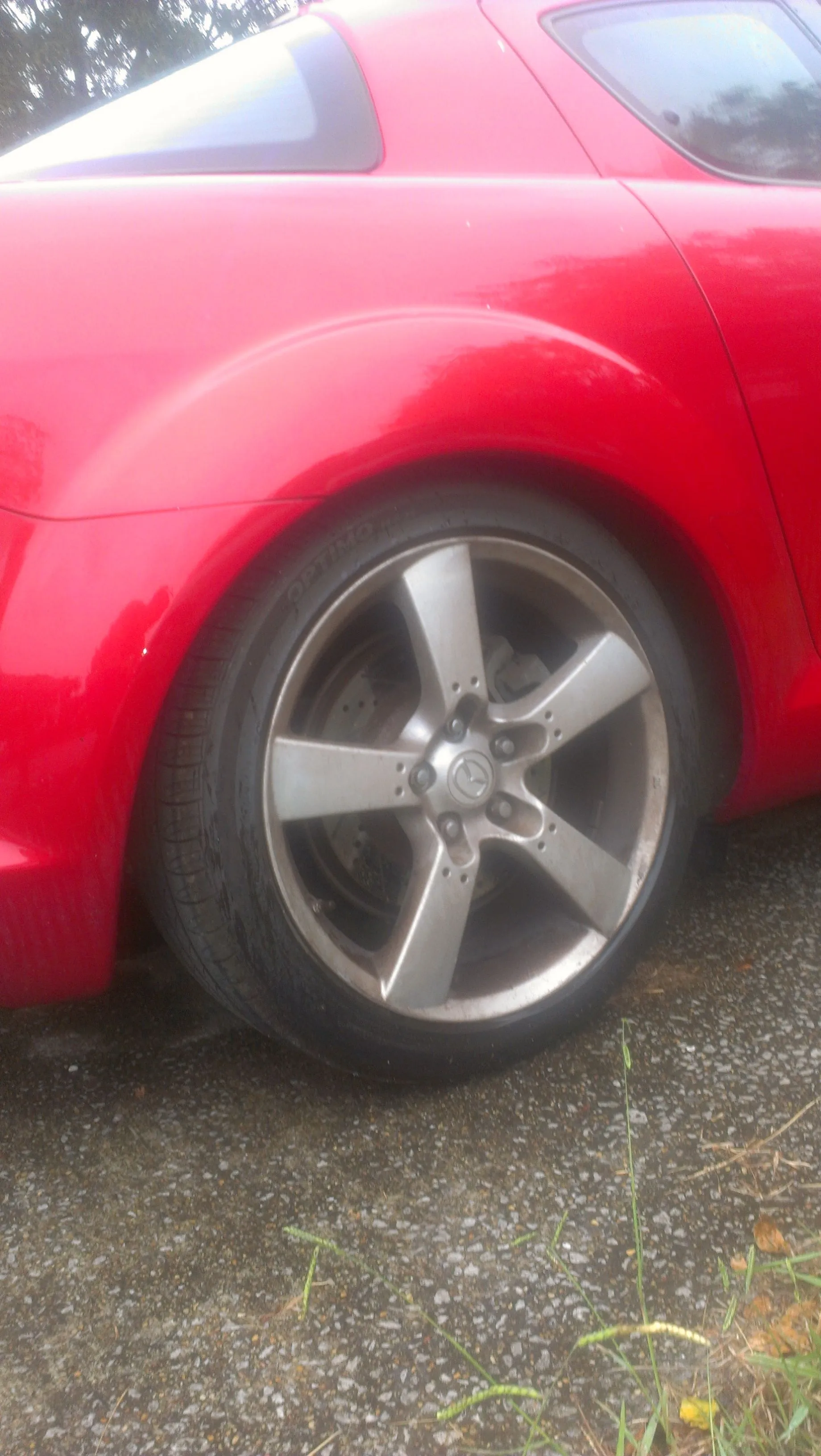

Hi,
I have a 2004 RX-8. The back of the car seems to be "bottoming out" as in loud knocks when going over bumps or dips in the road. I replaced the struts a few weeks ago. Did not really help. I never heard of Springs going bad, could that be the case? Any suggestions?
The ride height looks about right. I would recomend checking the suspension hardware starting with sway bar end links.
