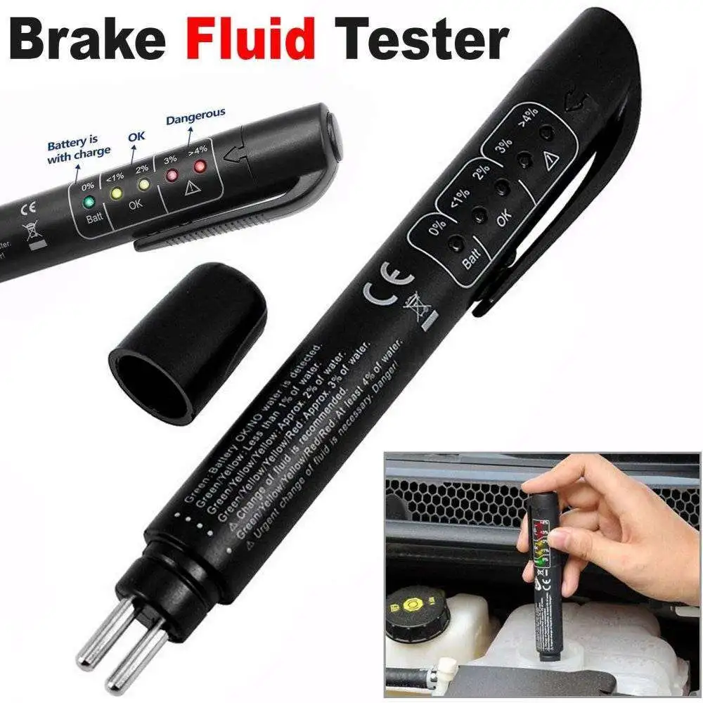

Most DIYers here do the ATF drain-and-fill or drop the pan with filter cartridge replacement at 45K ~ 70K miles. I’d use a simple brake fluid tester and decide when should I change the brake fluid.

I changed the brake fluid the first time after 20 years and 182K miles of the service on my 1998 Honda CR-V.
For some reason, many car manufactures including Mazda and Honda don’t recommend any brake fluid change in their maintenance schedule for US market, but they, Mazda and Honda, do recommend brake fluid change with 2-year interval in other regions.
Just use brake fluid tester and change the brake fluid when the moisture level is reaching 2%.
