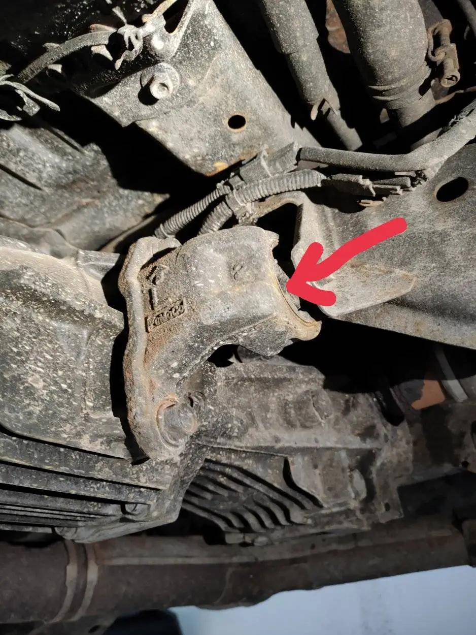

Thanks for the information. I have a loose differential and a little damp. I definitely have 2 front bushings to replace. I think to replace them without pulling the differential? I guess it's enough to unscrew the paws from the sledge and the differential? I still have a little play on the shaft between the 2nd and 3rd part. On the cross. I don't feel anything after the car, but I can see underneath how it turns with a bit of a shaft beating the sides.
