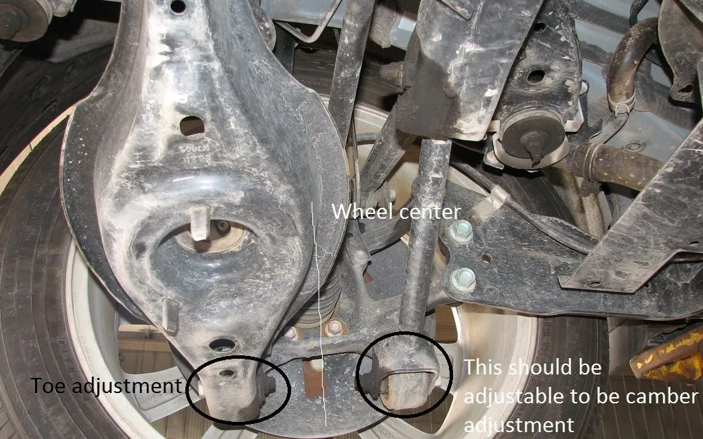

OK, found a picture and now it makes sense.
There, is a camber arm at the top, which could be made adjustable and that would change the angle also.
I have been looking into this, but I have not made much progress yet.
Mazdstyle(sorry about the name, I on't remember), made the most progress and now Chris follows his steps.
They have purchased from James Baron Racing, the Mazda 3 respectively Mazda 6 adjustable arms and they modified it/or will to fit our cars.

It's my mistake. The adjustment, is not at that end of the control arm, it is at the other end, close to the chassy.
The problem here is, that we don't know in what plane it is compared to the center of the wheel.
If it would be right at the center of the wheel, that it could be camber adjustment, but if it's off center(toward the rear of the car), then it will be toe adjustment.
