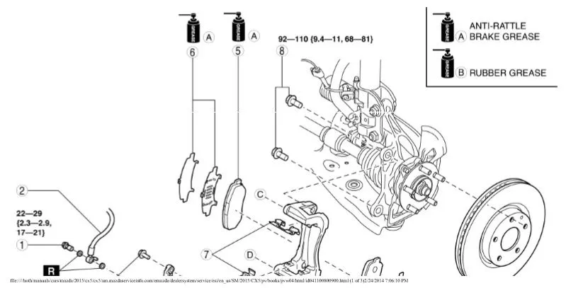

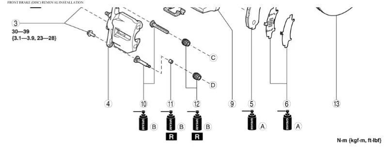

For front brake caliper slide pins are #10 in the pic and you loose #3 bolts to take pins out.

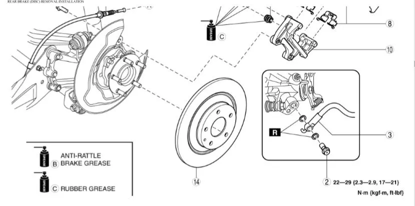

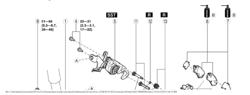

For rear brake caliper slide pins are #11 in the pic and you loose #4 bolts to take pins out.
Torque specs for slide pin bolts:
Front: 23 ~ 28 ft-lbf
Rear: 17 ~ 22 ft-lbf
Make sure to clean the old grease, and apply proper new "rubber grease" discussed in Lube those caliper bolt pins! posted earlier.
CX-5 Front Brake:
attachment.php
attachment.php
CX-5 Rear Brake:
attachment.php
attachment.php
Mazda CX-5 Front Brake_01.webp Mazda CX-5 Front Brake_02.webp Mazda CX-5 Rear Brake_01.webp Mazda CX-5 Rear Brake_02.webp
