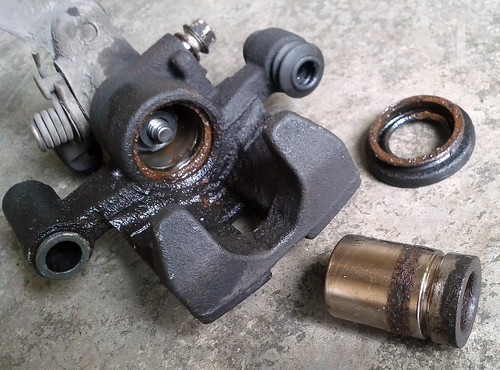

All right, so I replaced the caliper on the weekend, and took the old one apart to see what had happened:
The piston had grown rust, which caused it to seize up.
I flushed the brake fluid in all four calipers before doing the replacement, and a fair bit of crud and maybe even water came out of this one.

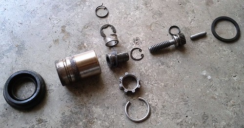

Aside from the rust, the actual mechanism seemed fine once I had it apart. Interesting to see how it all works:
Mazda Protege5 Rear Caliper Piston Mechanism
For those who don't know how it works, the whole six-piece "star" assembly in the middle snaps into the piston, and the shoulder nut (with the wave washers still attached) threads onto the gear bolt. When you turn the allen-socket gear (not shown), it causes the gear bolt to turn, which moves the piston in or out. The little round-ended pin at right is the linkage between the external parking-brake actuator and the piston mechanism.
