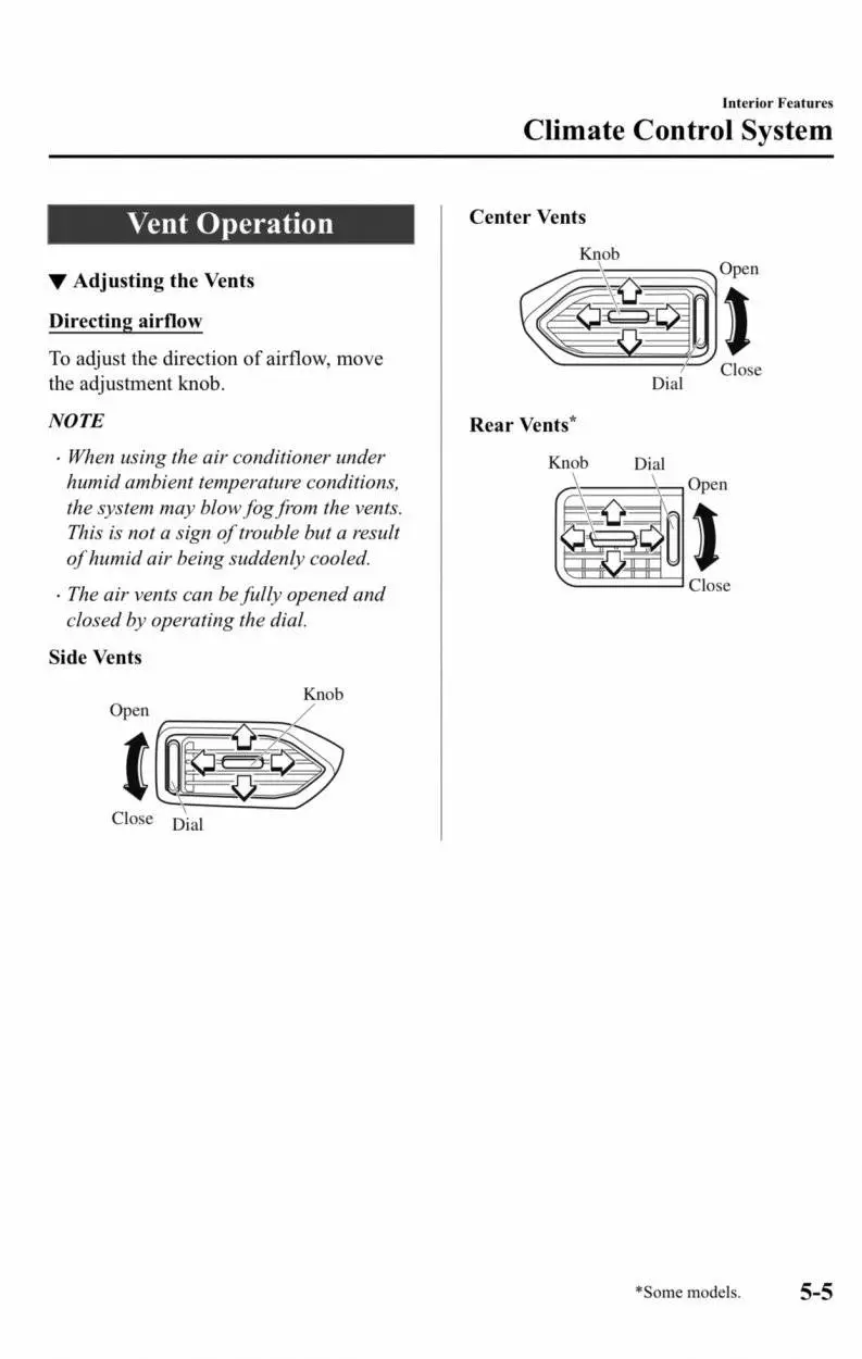

Your 2019 CX-5 Touring comes with dual-zone automatic climate control and “rear air-conditioning vents”. Firstly check the on-off dial controls on rear vents.

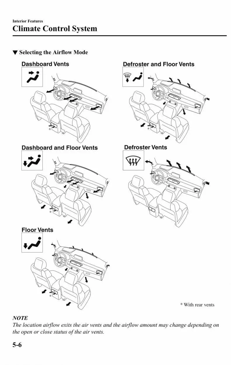

Secondly, since the sales brochure says they’re “rear air-conditioning vents”, and there’s an AC symbol (*) for rear vents in airflow mode graph, turn on the AC and see if the air flow from rear vents increases.

Not sure what do you mean by that. Are open / close dial controls on rear AC vents wide open?

Yes every vent is open fully. Ac is on and fan is blowing at the highest setting on the dash controls. There are no controls in the back other than that. I mean no fan speed controls. That being said at point there is very minimal air flow in the back. Hopefully that makes sense.

If the mechanical open / close dial controls for rear vents as shown on the owner’s manual above are indeed at open position, and the air flow is still minimum, you sure should take the CX-5 in to find out why since you do have warranty. My 2016 CX-5 doesn’t have rear AC vents. Unless like those rear vents in the luxury vehicles which have a true dedicated AC system for rear passengers, most rear AC vents like CX-5’s, basically they’re just re-direct some air from front vents, have weak air flow from what I’ve experienced. Your best bet is while you’re at Mazda dealer, ask for an air flow comparison with another new CX-5 side by side.

Try closing off some of the front vents and see if the rear increases. You should be able to close the vents closest to the windows. I don't think there's a close for the center two.
Also make sure the setting is for airflow to the head only.
If the rear increases there's your answer.
