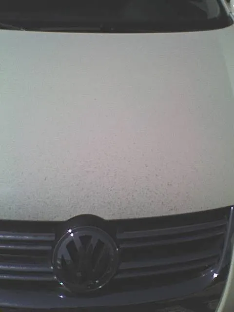

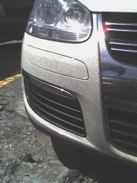

went to see the car at lunch (wife works 1/2 mile from my work)!
paint on bumper, grill, hood, windshield, mirrors, roof and I did not look at the sides.......
-R
Yeah a good thing that the actual can didnt hit the car though so i guess thats a plus.
that's not as bad as I was expecting.
at least the car doesn't look like someone tried to put the front end in blackface makeup.
we can also clay and buff that s***.. the buffer should put a nice dent into removing that paint
