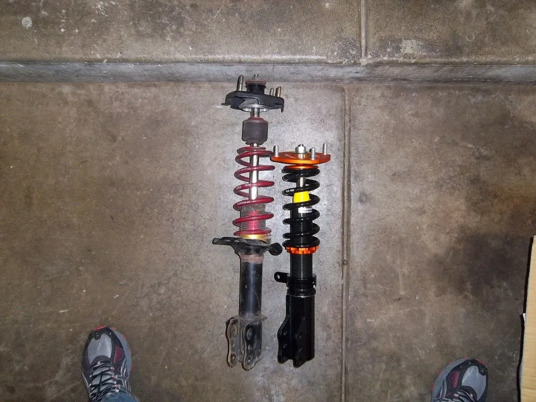

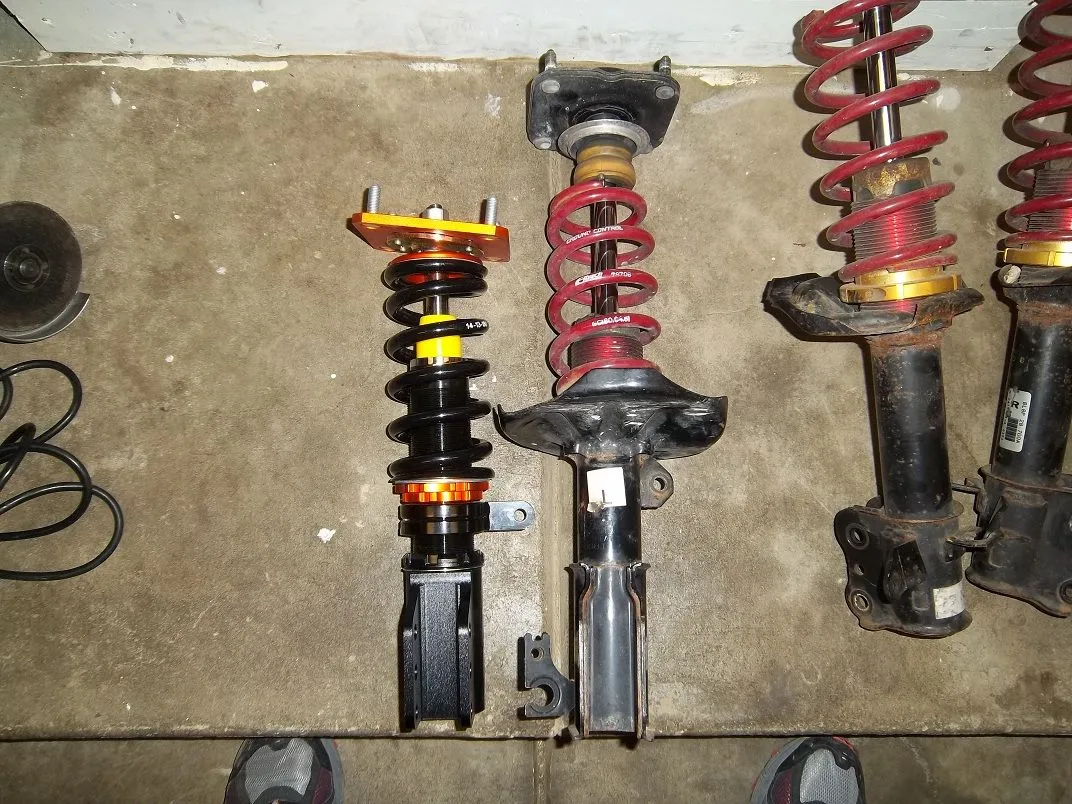

Had an install issue with the ksport RR. Special ordered the struts for a P5 from far of land (3 weeks). The bracket for the rear sway bar is like 5" higher than my stock struts for a P5. I called the guy at Ksport and at first he was like "its your sway bar and or endlinks". I said here is a pic of my STOCK shock and here is a pic of yours right next to it. Then he was like "oh, I'll get back to you". So now I am waiting to see what kind of customer service Ksport really has. If this was me (I do a ton of ebay) Id be overnighting the correct s*** as fast as I could. meh at least its a race car and I have till April to get this s*** straightened out. BUT if any of you guys could tell me the diff between a P5 rear strut and a normal Protege rear strut let me know. Here some pics of mine.

I dont really understand why you have issues with your Ksports. Mine fit perfectly so did many others, based on that picture you have the wrong lower strut mount on those coils, as my rear sway attach directly to the strut mount.
rears are the closer coils.
you can see the tab for the rear sway

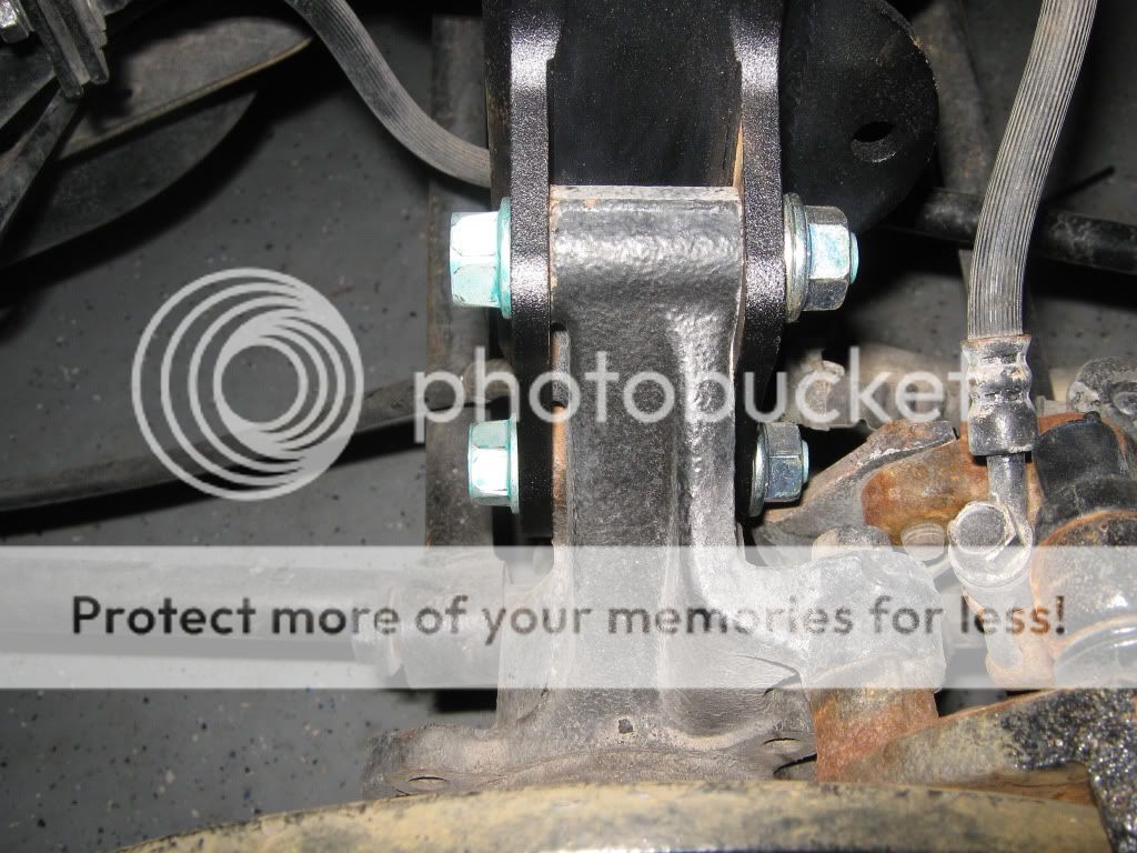

That's right they should have the mount at the bottom. They sent me the wrong ones, and now they don't want to fix this problem. So my problem is not with the product but with Eric at ksportsusa in Arizona (AKA customer support).
So. The story is that when the sway mount is on the lower mount it causes the sway links to snap. SO the upgrade is to have the mount up on the threads of the shock body. SO without telling anyone about this they are indeed being generous by supplying me with 13" end links. I just hope nothing rubs or bends as I have a 22mm AWR sway bar on top of their 672LBS spring rate. And just like my user name I intend on taking this car faster than any SM in my racing council. AKA 110MPH through the kink at Road America.

SO. like two weeks later I got the end links (very nice and made of aluminum with some dope ball joint ends). Yet I asked, AND was told it would show up NO SIGNATURE REQUIRED (I work 6 days a week). Bull s***. It showed up signature required. So like 4 days later I picked them up at a Kinko's (weekend + work). Anyway to get them to work with my AWR sway bar I had to modify one end to utilize the AWR sway bar mount (AKA $8 tap). Then they installed with no problems. I still love Ksports RR because the fact that the shocks have major adjustments. Also adjusting the ride height with out having to use helper springs or the like like is KEY. The fact that the lowers have built in camber adjustments, and upper pillows have major camber adjustments front and rear is a PLUS when changing tracks and brands of tires. I can't wait to take them to the tack to set them up and move on from there. People say that its "better" to adjust rebound and compression individuality, but in the real world I don't think they would ever want to put forth the effort it would take to go though the same corner over and over and over with the same car, same tires, same tire pressure, same EVERYthing to make sure that that is what they want (AKA seat of the pant means s***). The simplicity of these coilovers are nice. But not to simplified. Also as mostly a aluminum shock they let up a bunch of unsprung weight.
