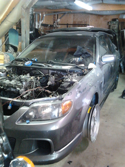

All of the engine bay wires are seperated and just need re-taped and wrapped. The stereo and speakers are now all removed. Also got a chance to test fit the 17x9's on the car. THEY LOOK SICK! I'm going to go ahead and buy 275's when I get some more funding and decide from there how much more I'm going to have to extend the frent fenders. I'm going to have to make new side skits and modify the bumper as well. Can't wait to for it to get a little warmer to start with all of the molding and cf. Pics and more to come.

I have pics of one of the wheels on the car on my phone, but some reason the phone pics don't show up on here. Next weekend some time I'll take another pic of one them on the front of the car. It looks sick and will be even better when I get some meat on them. I'll try the phone pics again in a little bit.
