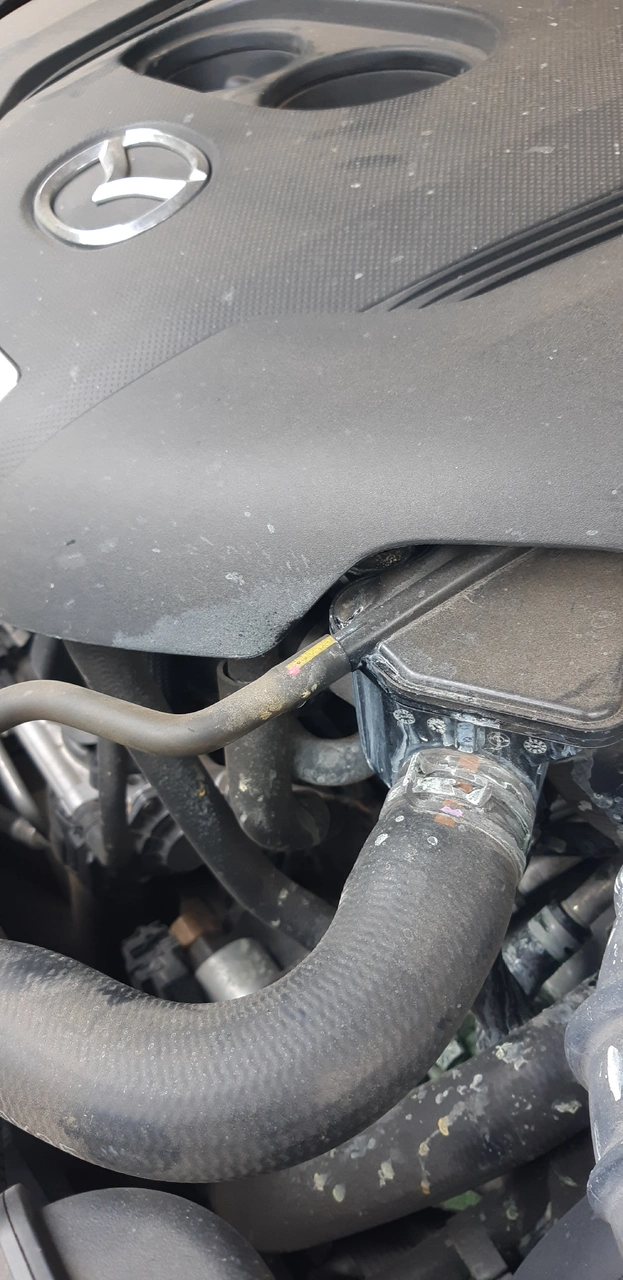

Well it turns out tjere is a drip at the junction of the tube with the orange stripe. I hope that is the only source and will find out day after tomorrow when the car is at the dealer. Thanks again to all who've addressed this issue.
Well it turns out there is a drip at the junction of the tube with the orange stripe. I hope that is the only source and will find out day after tomorrow when the car is at the dealer. Thanks again to all who've addressed this issue.
🤔 That looks too big to be a coolant hose ... Isn't that induction charge air from the intercooler to the engine? That would NOT be a good place to have a coolant "drip" from at all 🙏
May be just my perspective looking at the pic
Could be the plastic box (it is a small coolant reservoir with a cap) has split. Its plastic and that ages faster from the heat over time.
That is not the air from the intercooler. Both the large and small pipes are coolant connected in that reservoir.
The flat lid with integrated tube to the right of the orange stripe is apparently the culprit. Of all things has to be imported from the US. 20 days.
Seems like luck was on your side. Could of been a lot worse.
Sounds like you can still drive it.
Yes I can. Just have to watch the coolant level until replacement .
Well I have a dilema. I need to make a round trip of about 12 hours in the next week. The part is on order. I'm not sure what you call it but it is the flat topped componanant in the above photo where the tube with orange stripe joins it. Thats where it leaks antifreeze. My question is, is this a componanant that could break open even further on a long drive to the extent that coolant can't be maintained in the reservoir/radiator? I don't mind stopping every hour on the trip to refill but if worse damage to the component can occur on a trip I may be better off parking the car and renting one. Anybody familiar with the component mentioned and its weakness?
